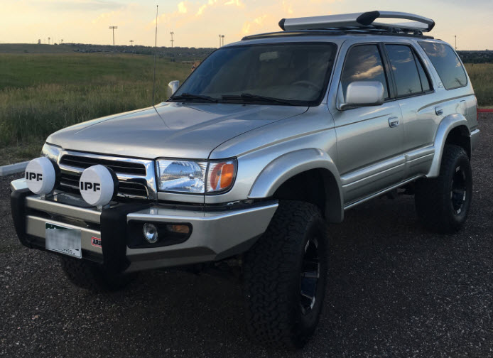

The guy I bought it from had just put on 305/70/16's with a crazy offset wheel of like -20 in load range E's (SEE PICS).
I personally didn't like them....the look, the weight, or the clearance in the front. (SEE PIC). Maybe I'm being hard on the weight thing (my rig is supercharged) but I'm loving the power (coming from an LJ with 35's...4.0 is good but wow is my runner a rocket compared).
So, I have sold those to a friend and looking to go with a Nitto Ridge Grappler which I like for a lot of it's look, AT/MT balance, highway manners, overlandish characteristics etc. I found it in a C, but in a 285/70/r17 (new American Outlaw Bandit wheels too with -10 offset). I think this will get me a lighter setup between those wheels and tires that will still be plenty fine for the off-road I'm looking at doing with this (my Jeep 35's were C's and I took it on buggy trails and am of the mind that D's and E's are overkill even with most wheeling on a lot of lighter vehicles, and especially anything more overlanding in nature). This should also get me a narrower tire at similar height to the 305 but with hopefully more clearance in front (maybe enough for front chains but doubtful). And, overall should be tucked in a hair with the -10 offset wheels better than those -20 offset wheels.
The only bummer is whether they will look big enough with my 4" lift. I tried to get that tire in a 285/75r17 but Nitto isn't making it yet apparently (in a C) and no timeline on when or if they really ever will. Thoughts on any of this? Thx!
305's on a 16 still run 33" tall, they are just wider. So they will look fine. Just get them in E and keep the PSI 28-32psi they will be fine.
