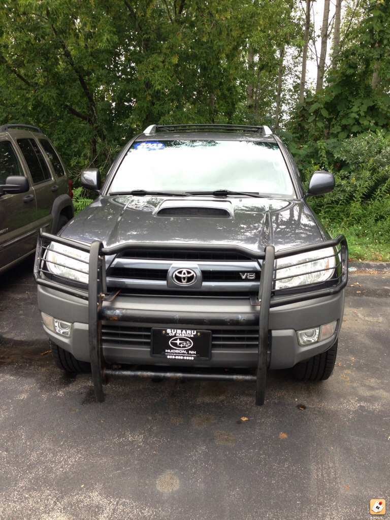

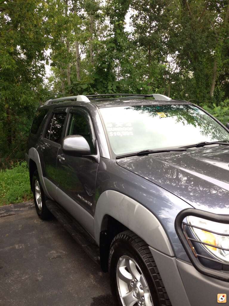

First, a couple of shots of the truck when went to look at it:

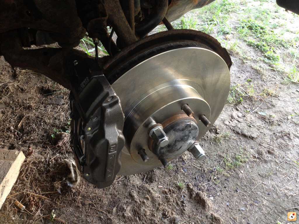

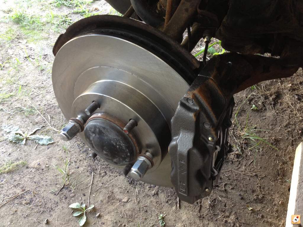

First things first, a complete front brake job. I pulled the rears to check them as well. I adjusted the ebrake to firm it up as well (and removed the god awful brush-gaurd):

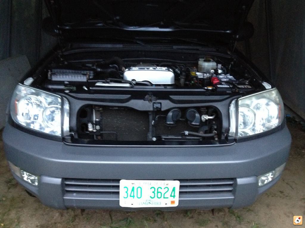

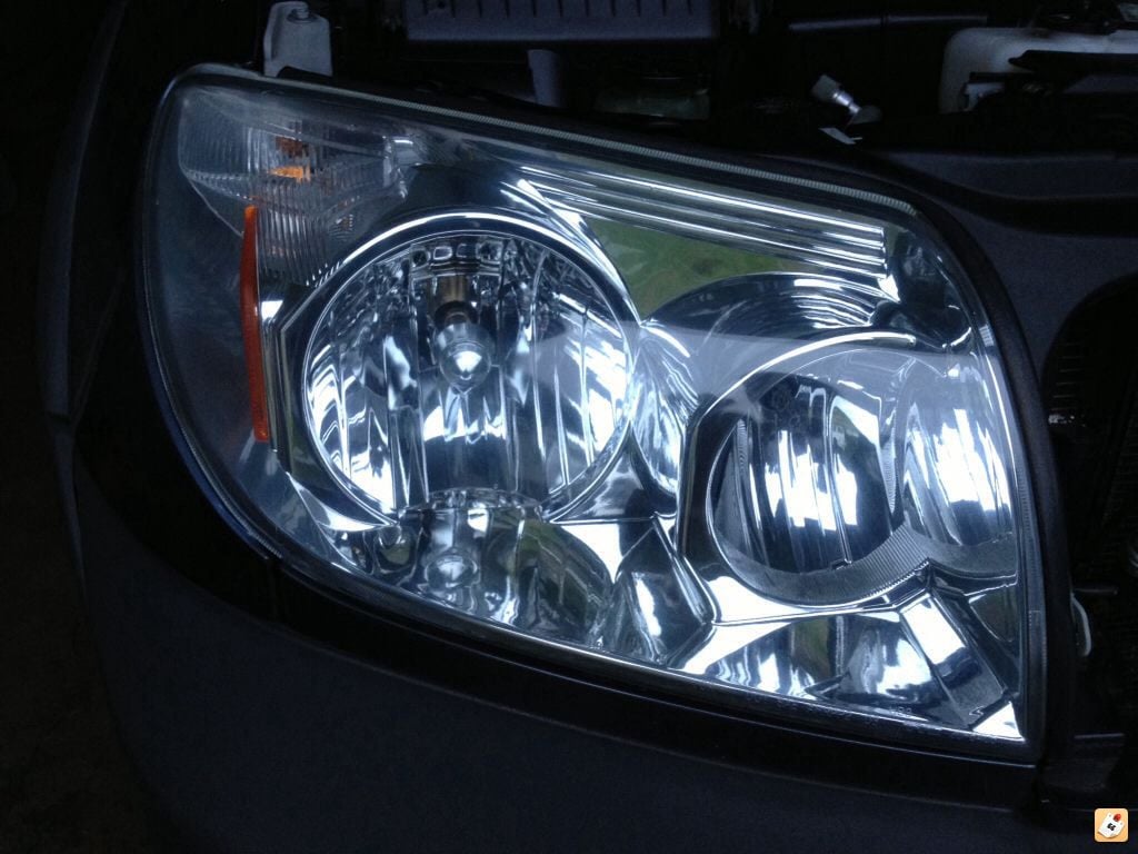

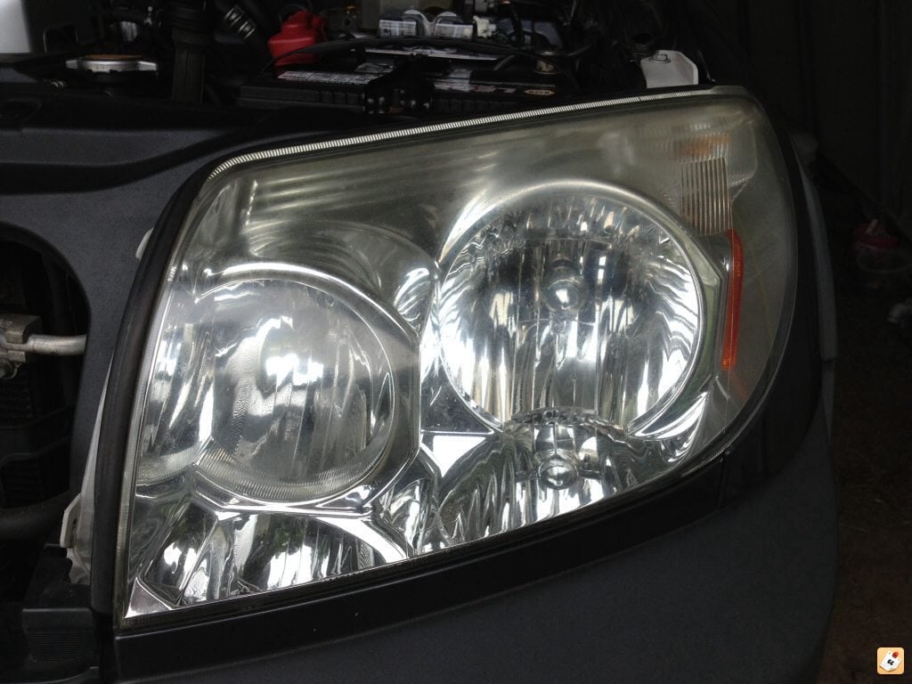

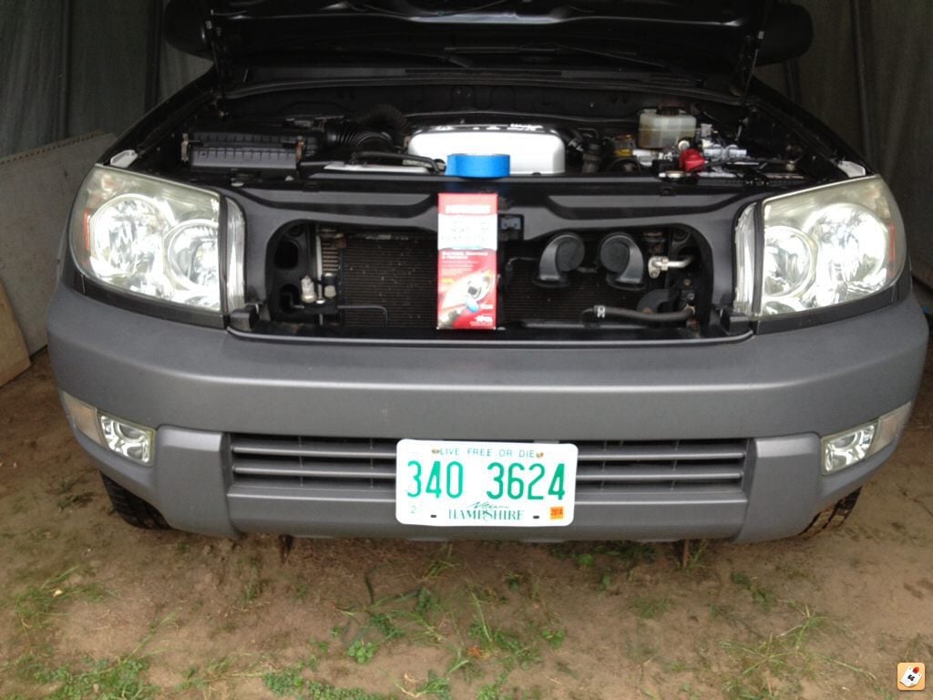

Brakes felt a whole lot better after that! Then, I bought a headlight restoration kit (Mothers). Didn't like how it turned out so I went out and bought a kit from 3M, much better results:

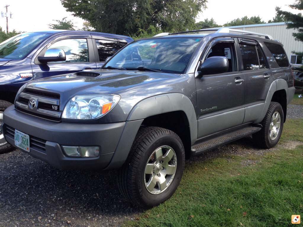

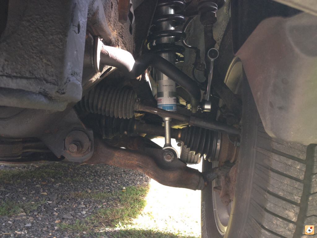

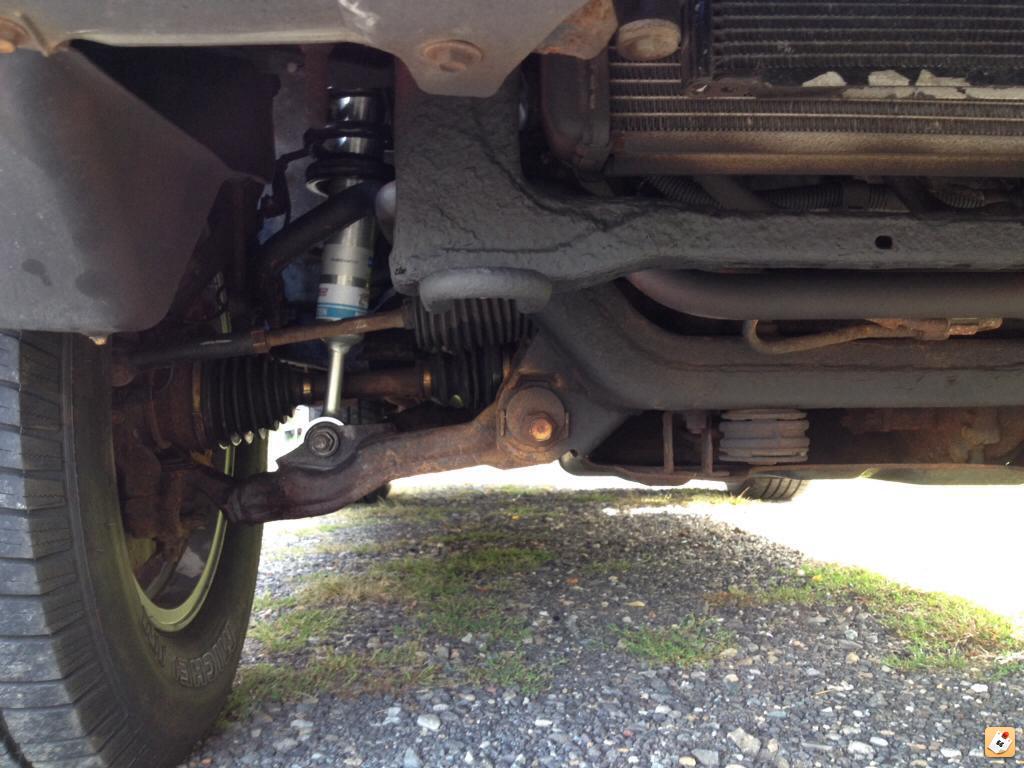

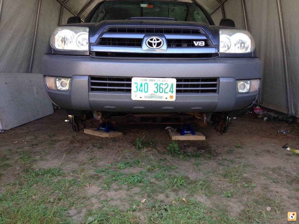

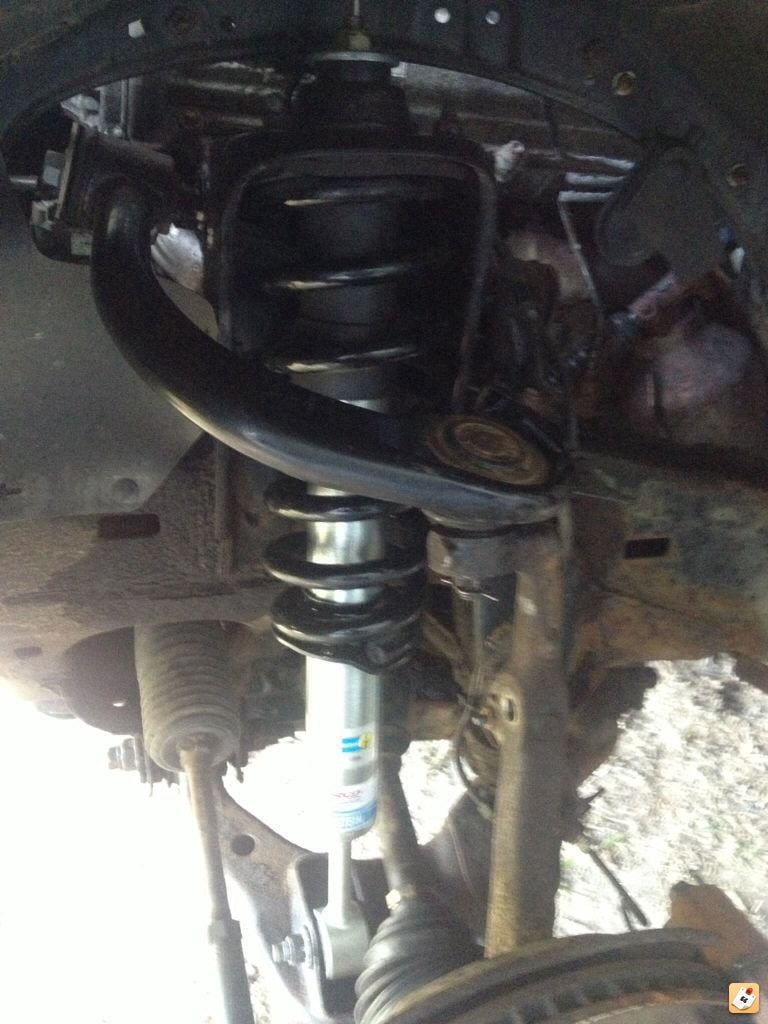

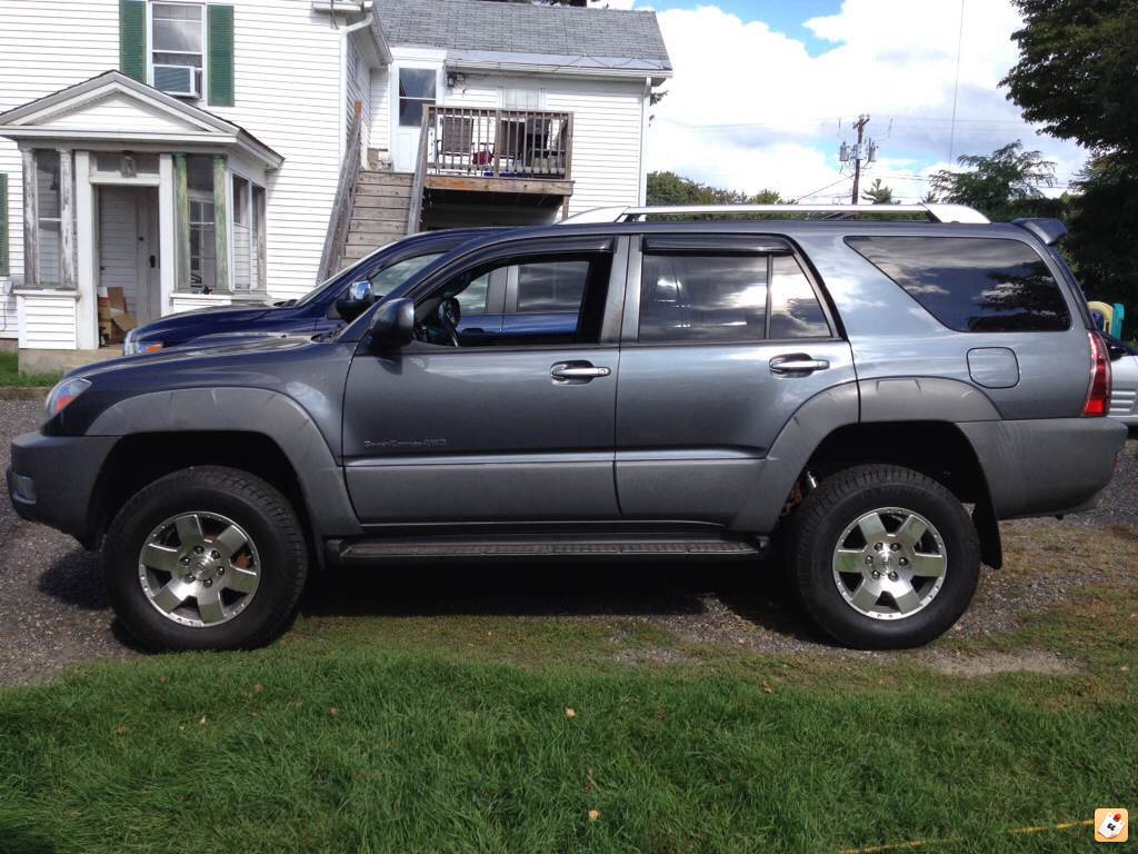

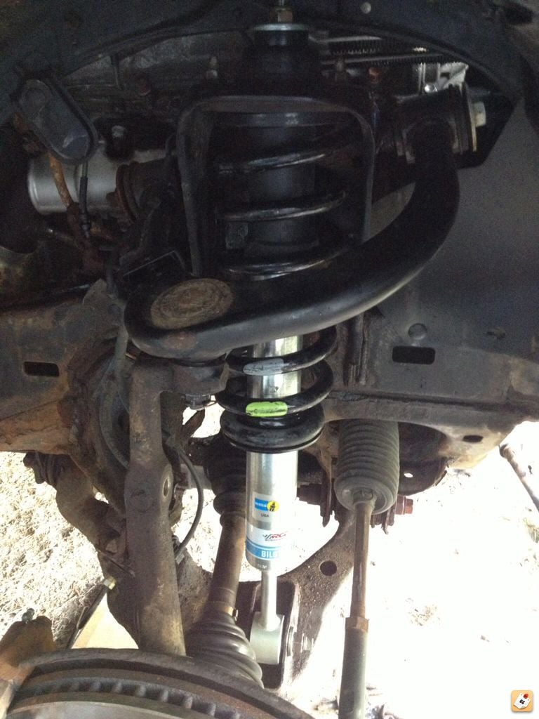

The truck came with the XREAS, and at 123k it was soft as hell and I didn't care for how it handled. Picked up a set of 08 TT FJ Springs, a full set of 5100's, 1 1/2" Daystar spacers. Ended up having to do the driver side sway link. Did the front sway bushings just because....:

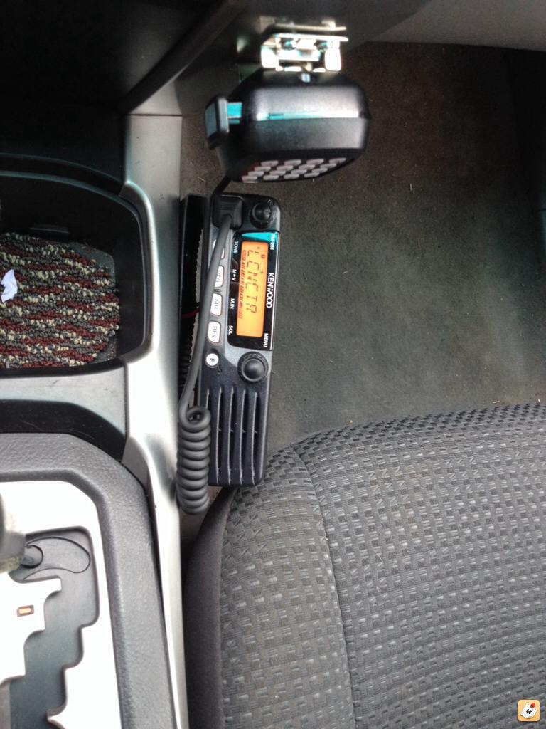

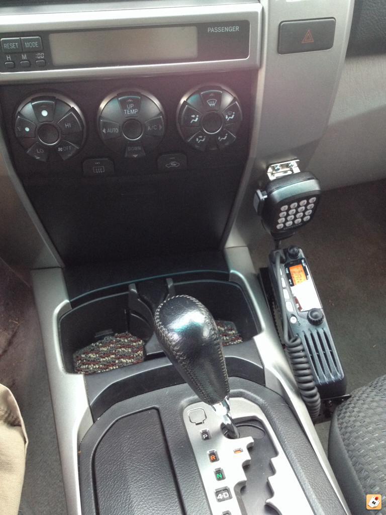

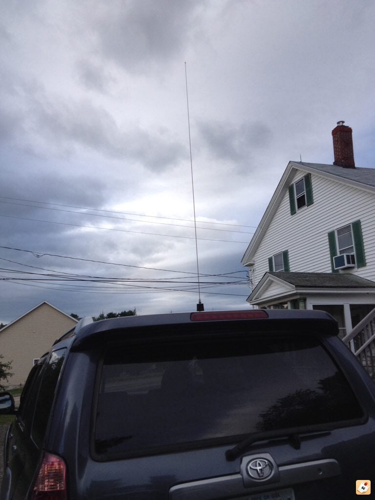

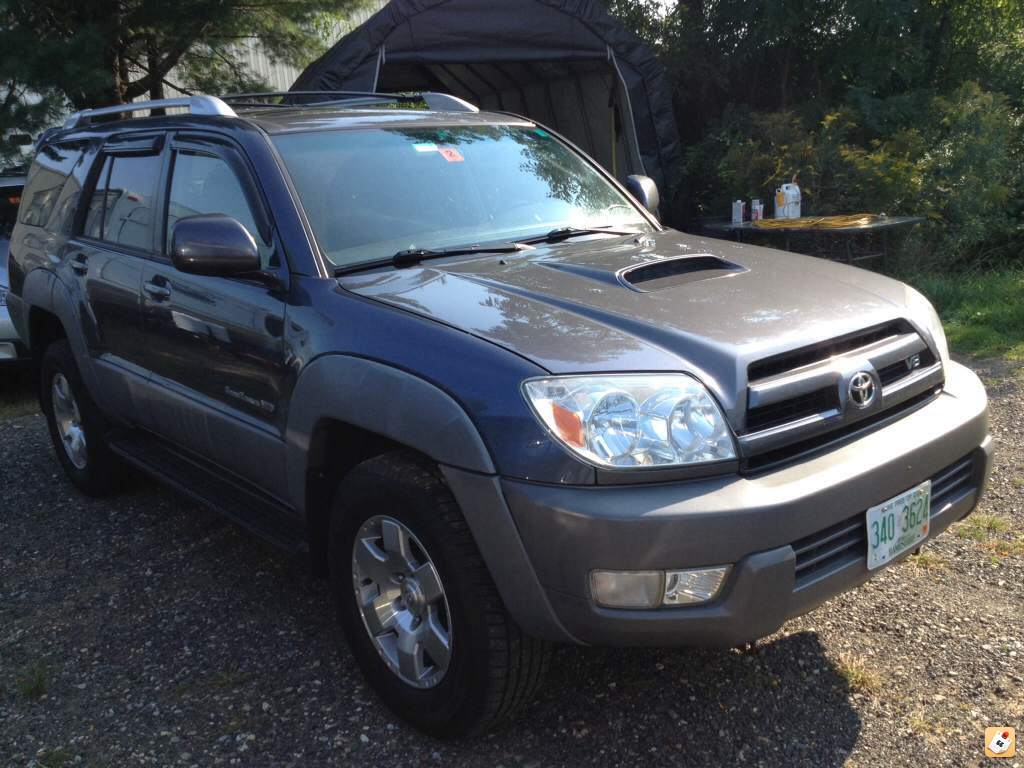

I LOVE the look, the ride, the handling of the 4Runner now. What an improvement!!! I have done a couple other things too, added a Kenwood TM-281A & 53" magnet mount antenna. Once I get more pictures ready I will update this thread.

Looks awesome! How long did it take you to do the springs?
Thanks for the compliment!
I did things a little unorthodox. Ordered everything over a period of 1 1/2 weeks. Also, I delayed getting the Daystars thinking I wouldn't need them. After considering that I wanted to get all of the lift possible out of the 5100's I took the advice of another member (don't know how to tag folks here) I ordered the spacers. It took a week for those to arrive (in addition to the sway bushings and link). All told, I did all of the work myself, hired out what I needed to (tire mounting, alignment, etc.). I took a whole week to do the suspension. A day for the fronts, and an afternoon for the rears. both presented their own unique challenges, but I had a good time just the same. This is the first time I have ever lifted anything. I have been working on my own vehicles my whole life, just never did a suspension mod....only replacement.
Great ride, handling & look as far as I'm concerned. All for ~ $500.00ish

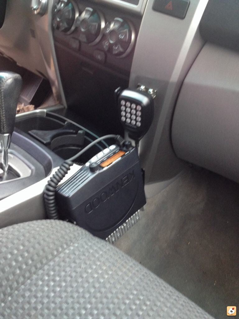

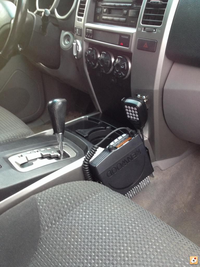

Got some pics of my TM-281A & antenna installed. The location is growing on me, wasn't that crazy about during the planning....but the options are limited.

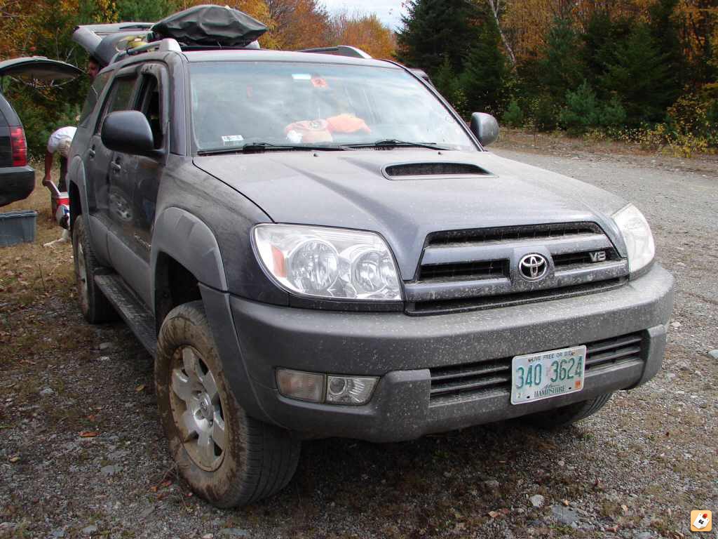

Another lunch stop, this time we got the trucks together....
The birds were tough to find, but we had a great trip anyway!!

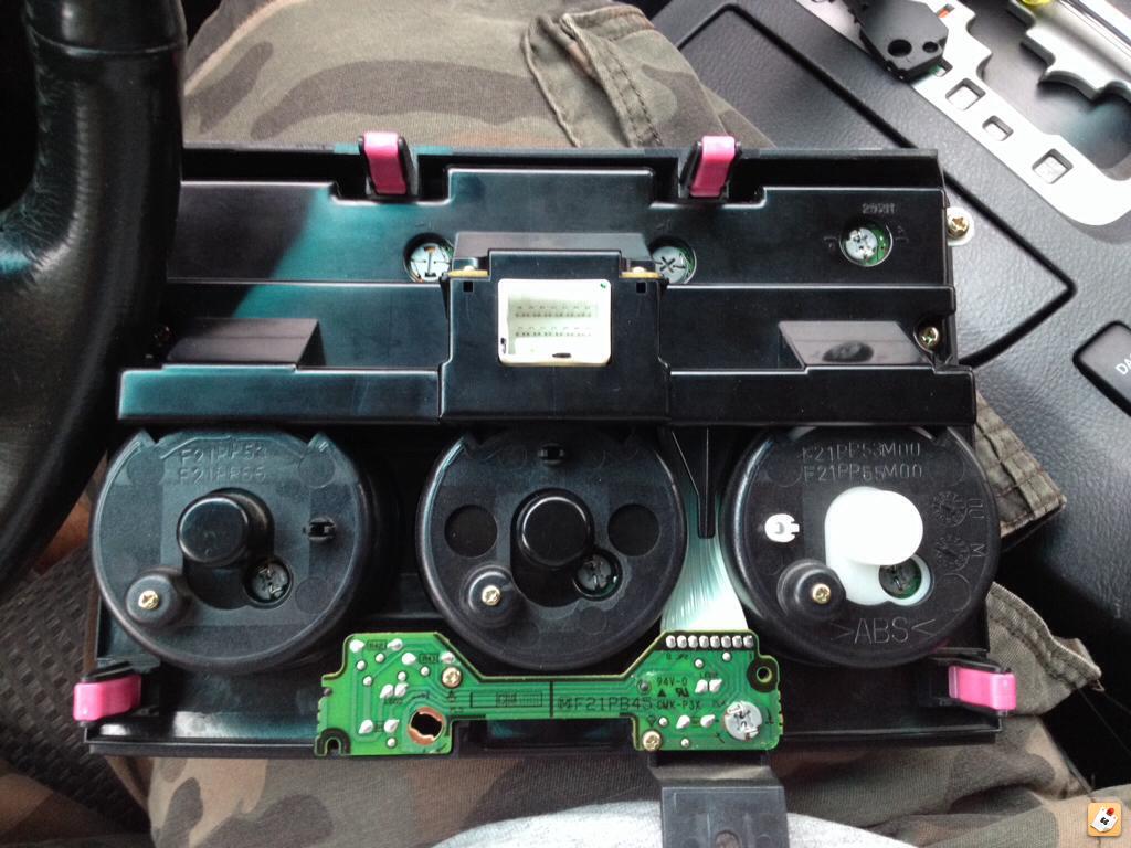

Go my order of LED's from Superbright LED's in and did the install.
I ended up being short one Neo4 for the HVAC backlight. For that matter, I still have to do the wire mod to get the HVAC LCD backlight to work.
Once I have it 100% finished I will post more pictures (as well as a complete list of LED's needed to complete this mod).

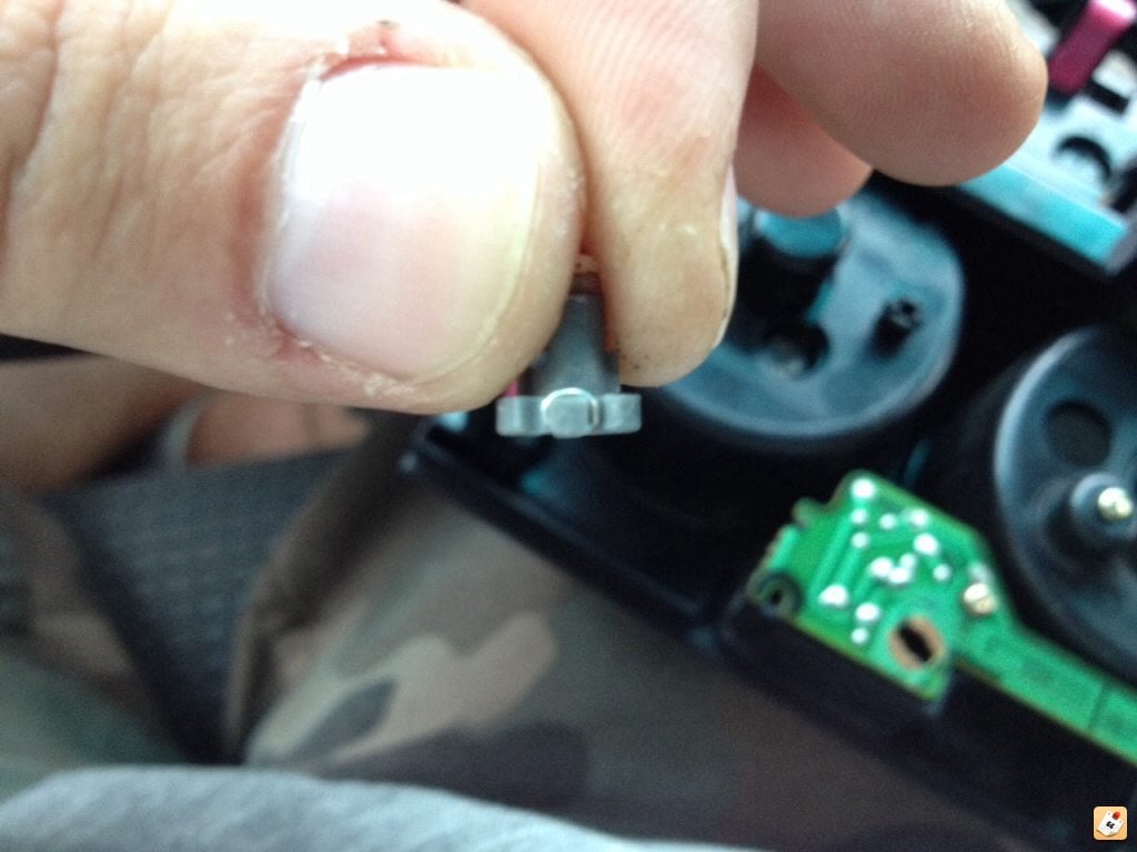

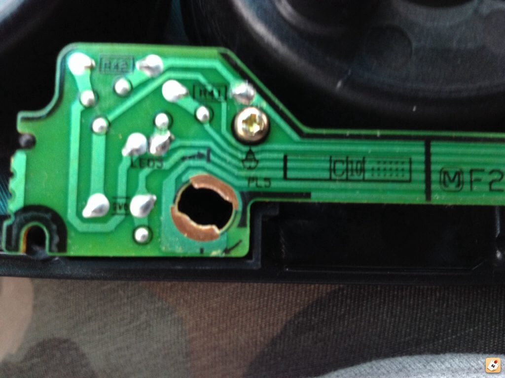

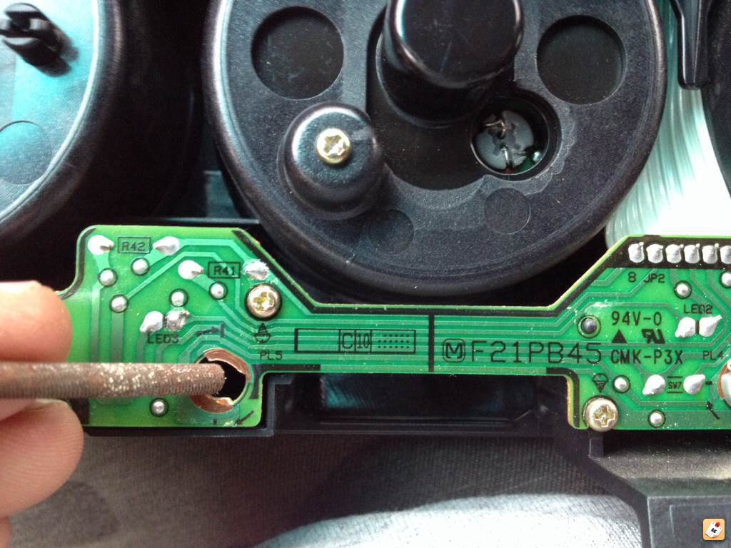

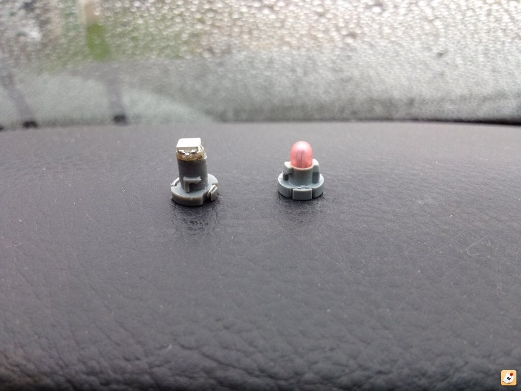

A quick note, the LED's are polarized. If they are in backwards they won't work. Try flipping them around first. If that doesn't do it then it is possible the leads are not making solid contact with the board.
Here is a shot of the new/old lights:
If you are not sure if the leads are making good contact then use a small pick or screw driver to pull the lead out a bit. This way it will make good solid contact with the board:

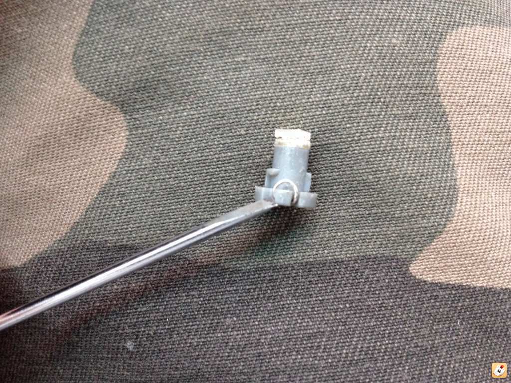

Don't forget, the opening in most of the Neo3 size devices (switches, HVAC backlighting etc.) are too small for the LED's to fit (DO NOT FORCE THEM IN, YOU WILL BREAK IT IF YOU ATTEMPT TO GET IT BACK OUT)! Simply take a small file and open it up SLIGHTLY:
Again, I will do a write up and post a full set of pictures when I have the whole interior swapped to LED. Just ordered the interior light kit for all of the regular stuff (Dome, Map, footwell, cargo light LED's).

Great looking rig [MENTION=98468]BigNuge[/MENTION] ! i was wondering what size michelins you have, 265/65/17?
Thanks!
Yes, that's the size. And I LOVE the tires. Very nice comfortable ride on road, and quite capable off road for what I do.
And I still do 19.5-20.5 MPG average on every tank!!
