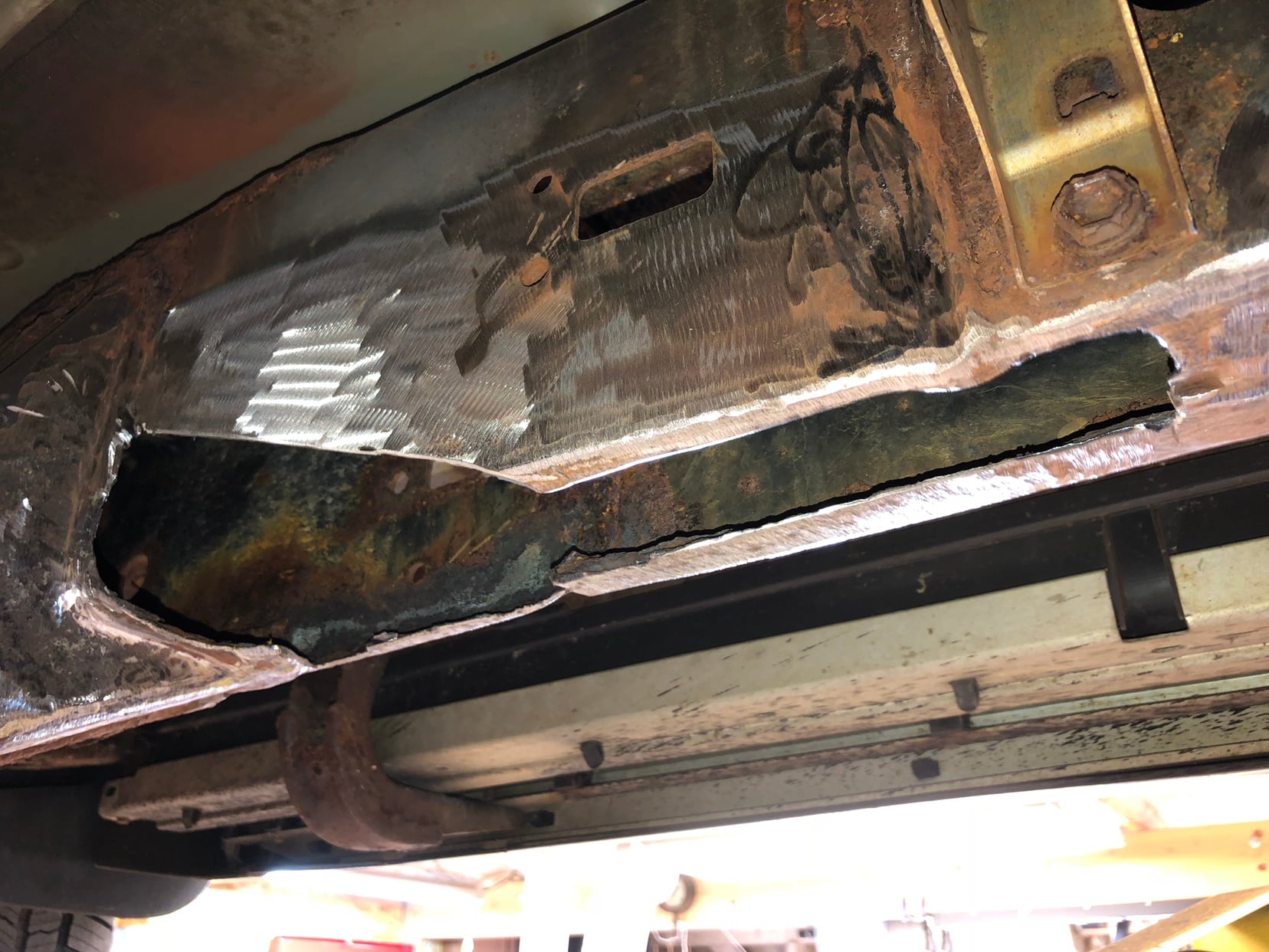

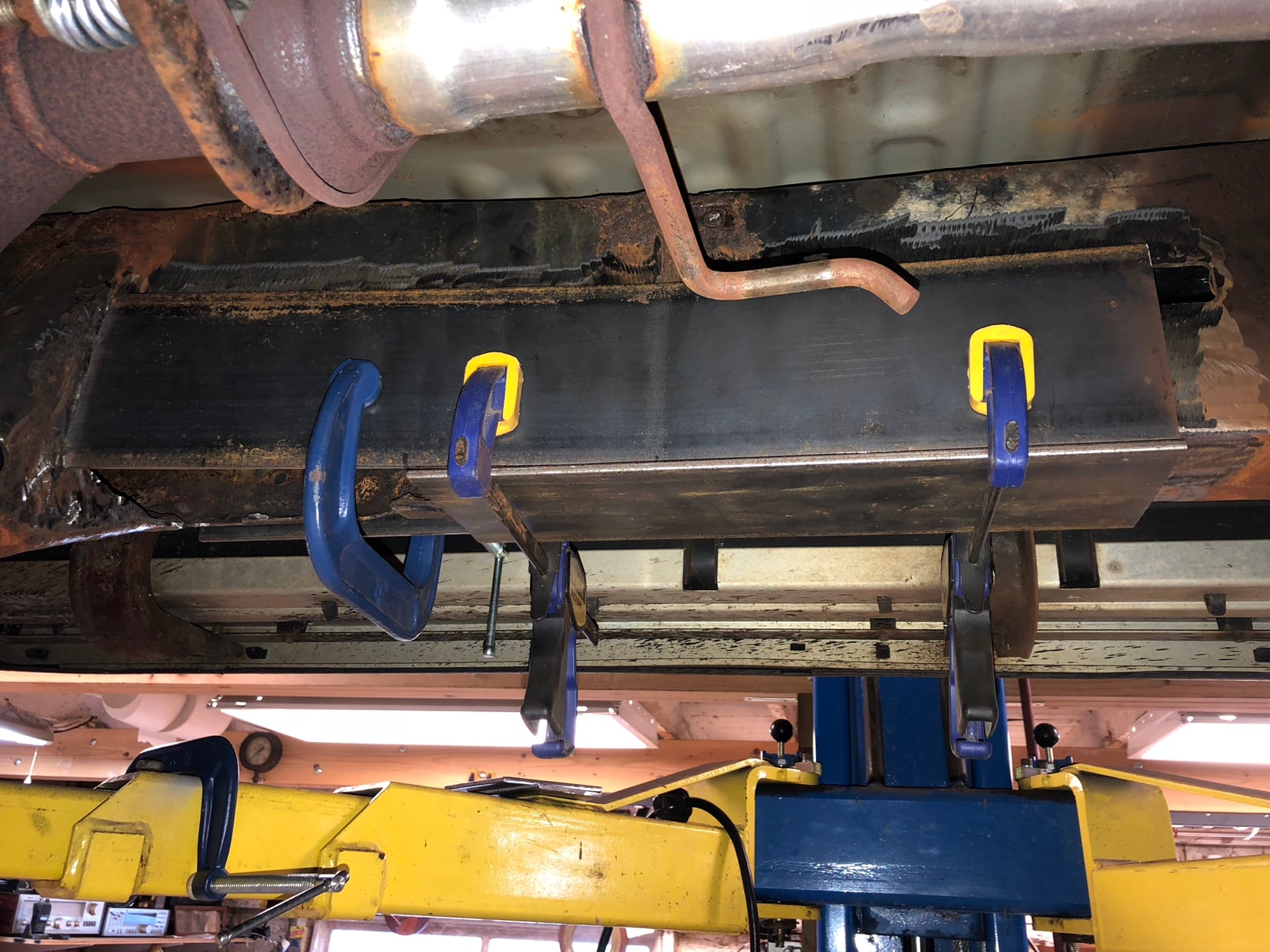

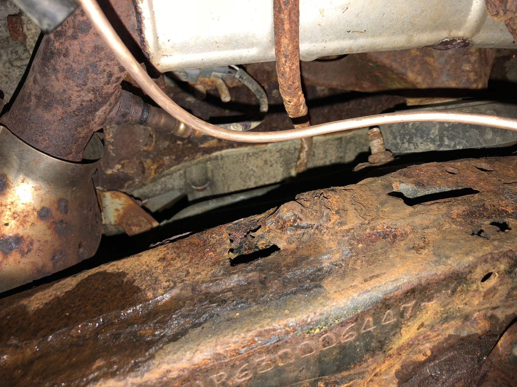

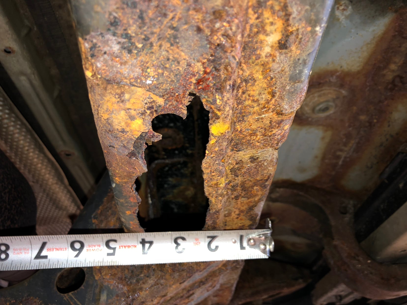

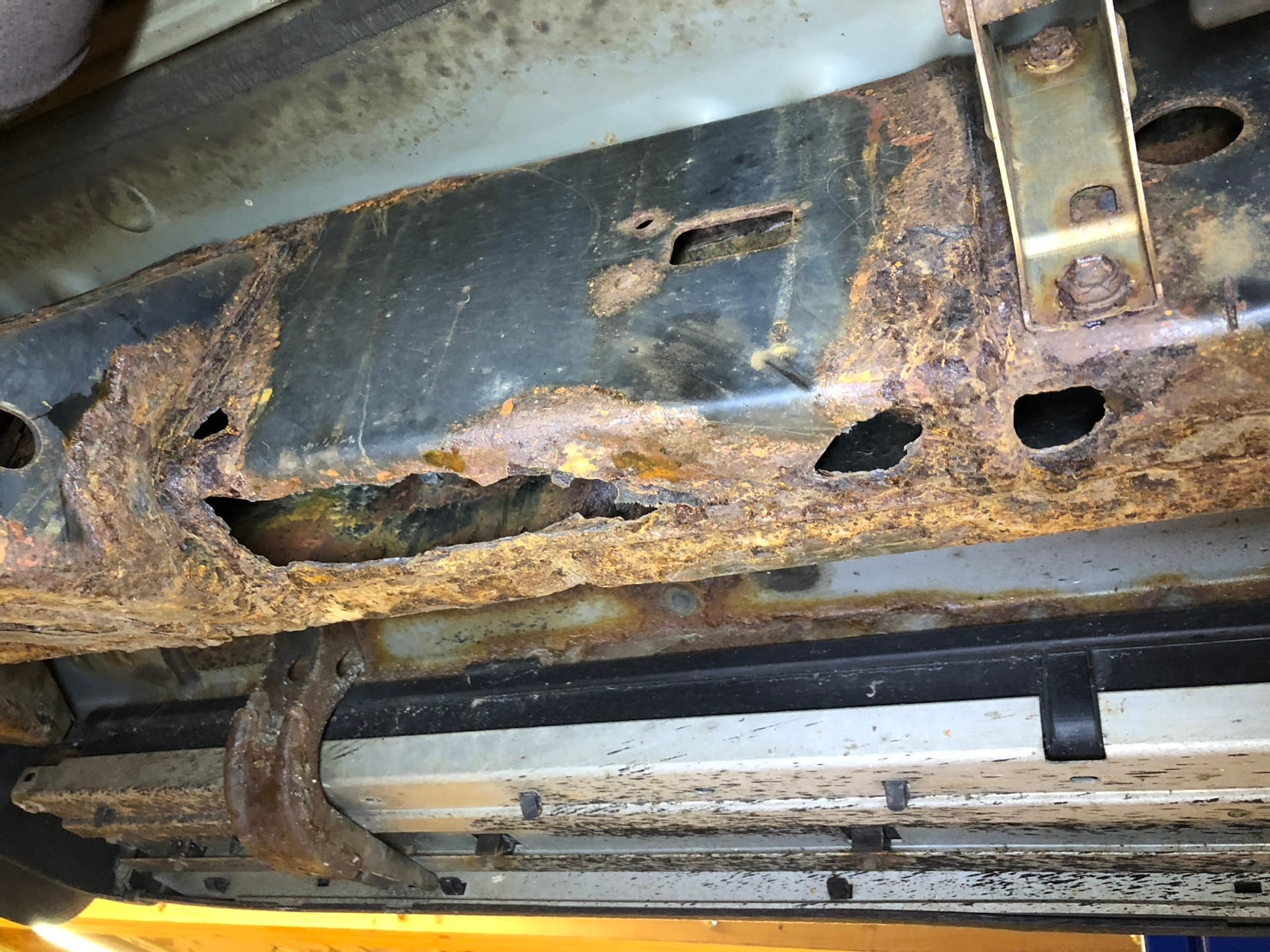

Frame is beginning to fail. I recently had it on the lift for brake work. While looking it over from underneath I noticed an ugly area on the frame, under the passenger side rail. Took the hammer to it....not good.

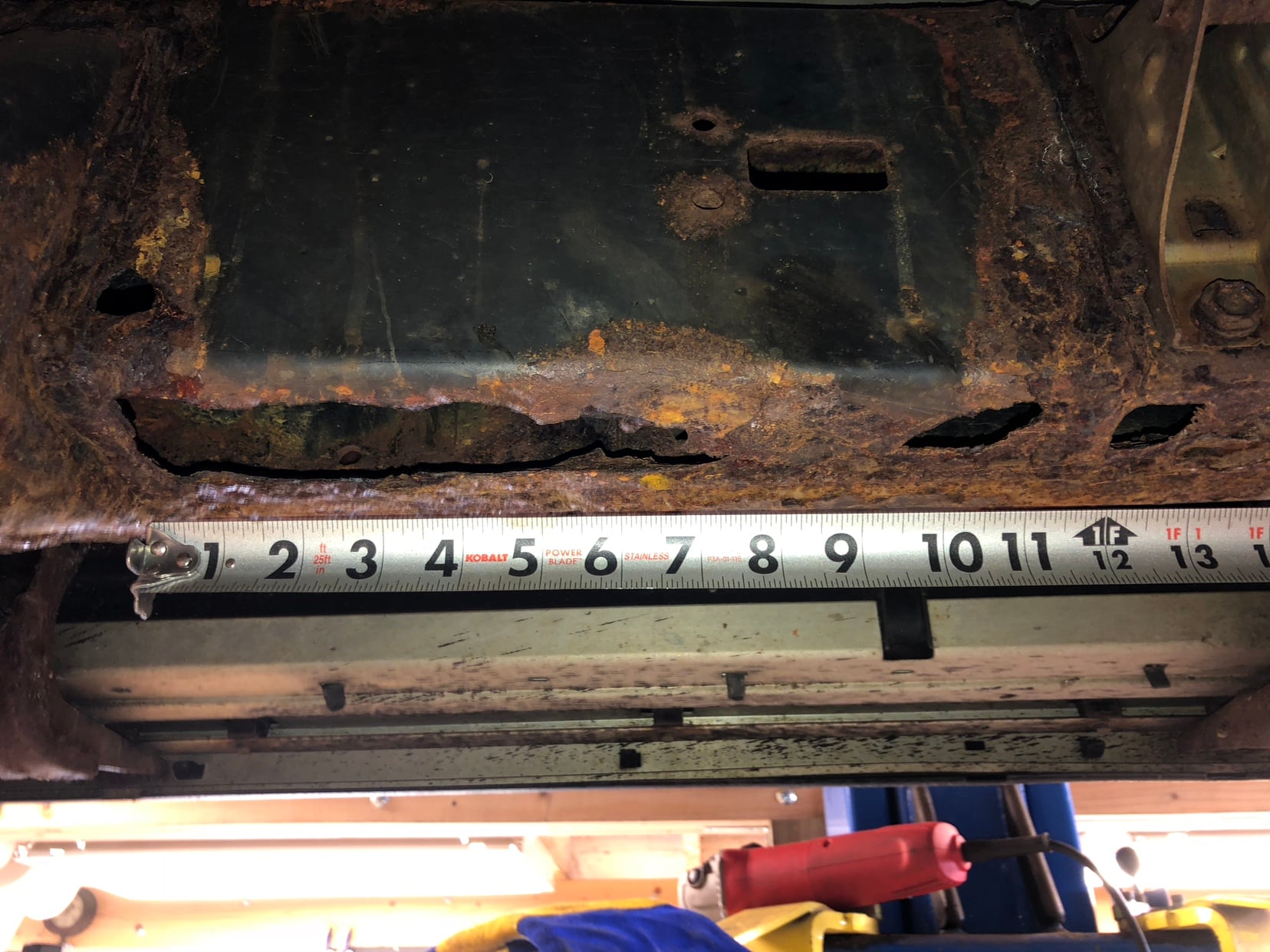

Also found a bad area on top of the front frame rail section (both sides).

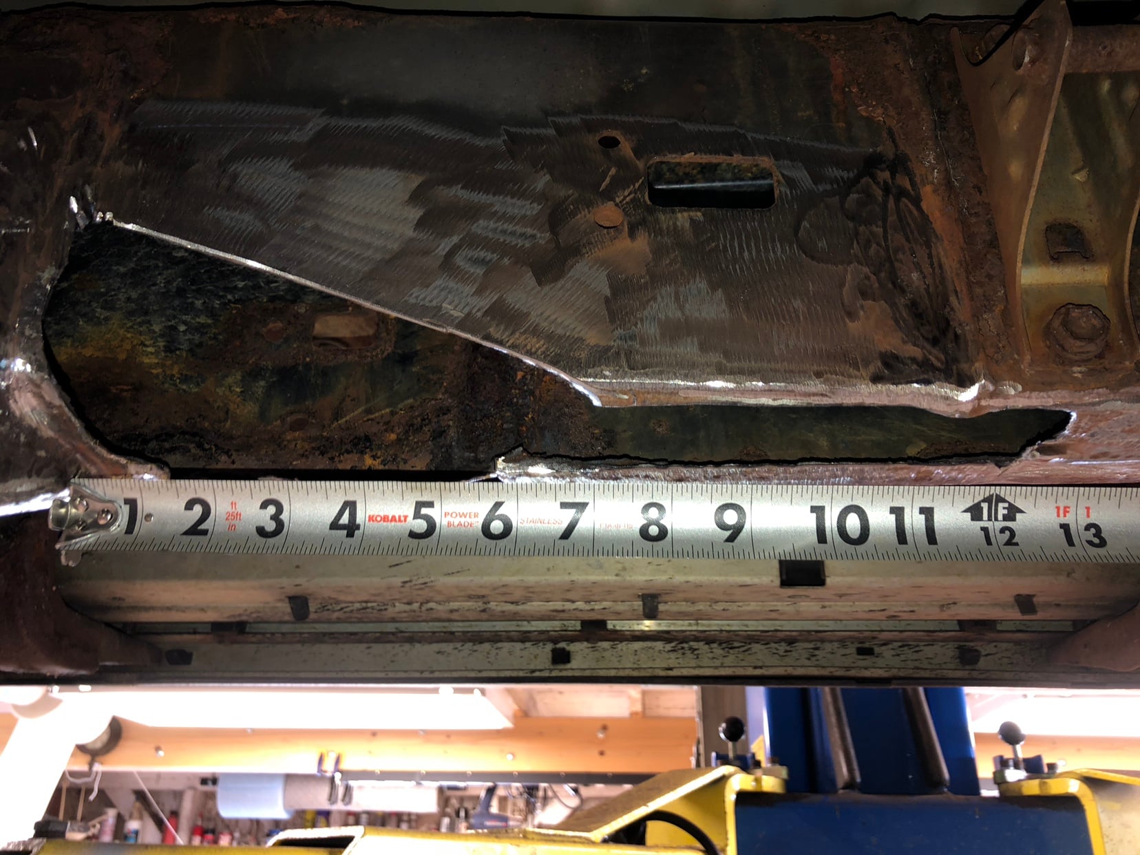

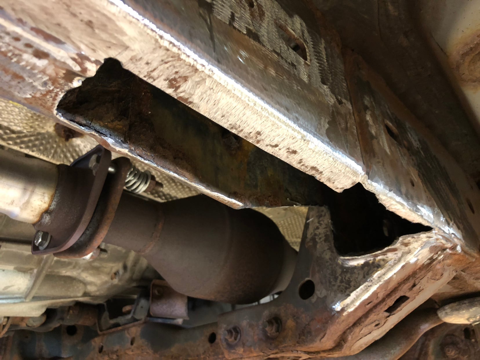

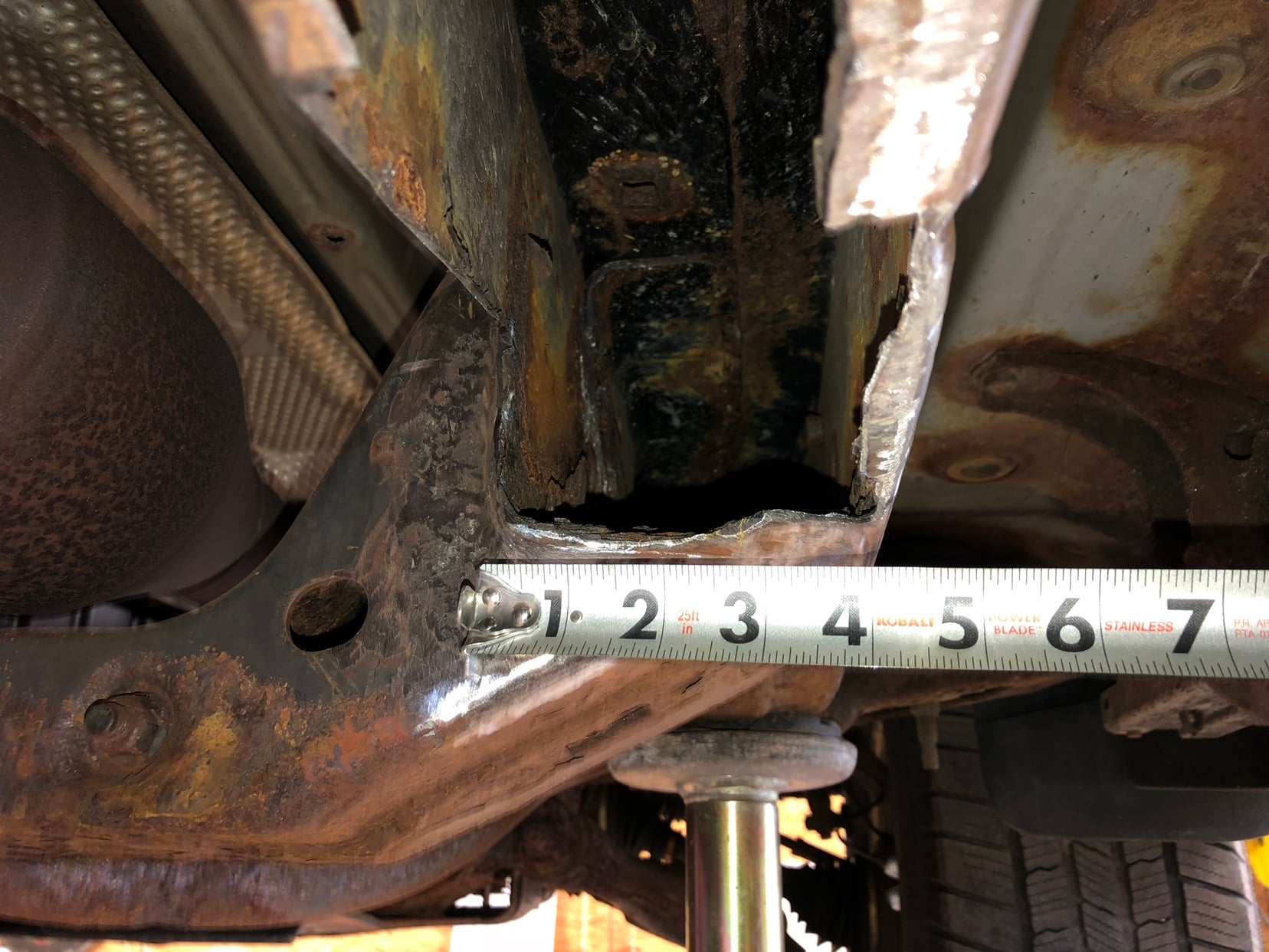

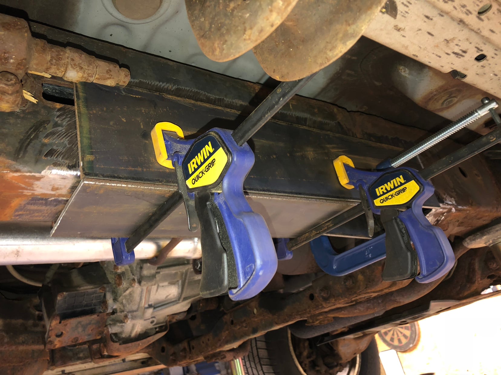

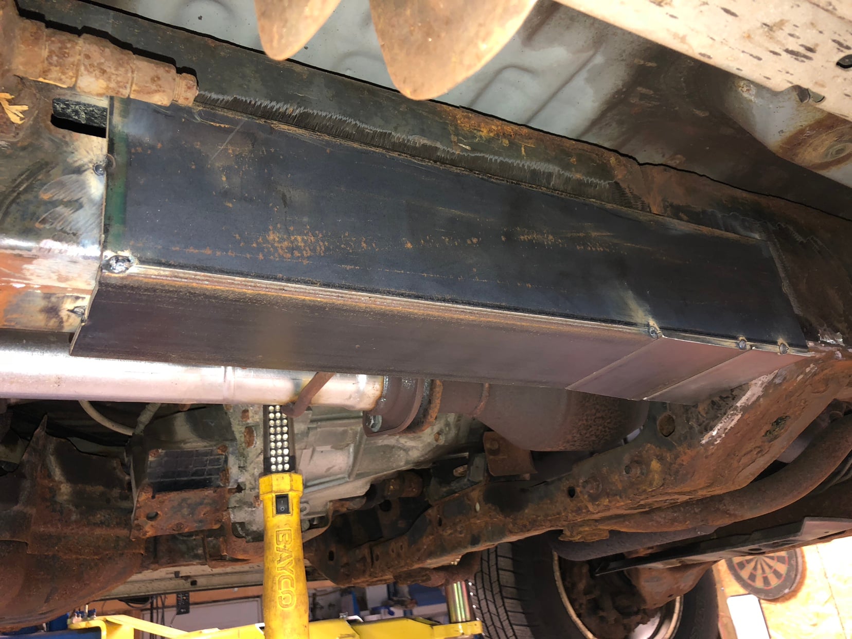

Got to work on it today. I have some 3/16” for making repairs. I started by cutting away the bad until I got to solid material.
That’s it for today. Pats are on, and it’s been a long weekend already.
I will report back when I start welding in the repair.
Looks pretty gnarly! A tad worse than mine. I don't have welding skills or equipment, so I think in a year or two I'm going to just swap the frame, and try to keep it from getting worse in the meantime.
Yeah, it’s not good for sure.
If a frame swap wasn’t an unimaginable PITA project I’d consider it.
What I’m really hoping for is Toyota steps up and does something for us. They recalled all their COF vehicles of this vintage, save for the T4R for some crazy reason. The NHTSA has opened and investigation into these frames (August of 2018). I hope something comes of it!
Till then, I’ll keep patching this up for a while longer. It would be great if I can get till spring....we shall see.

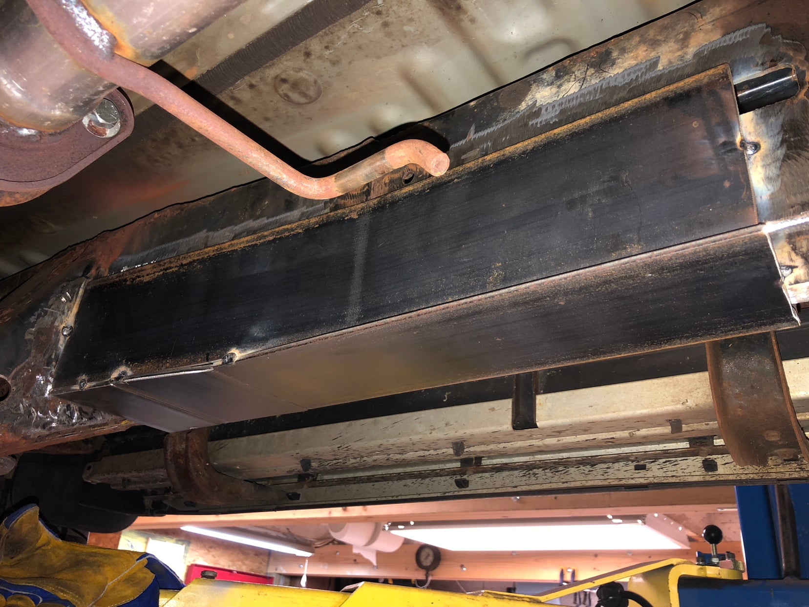

Got some time to continue the frame work tonight. Unfortunately my Lincoln MIG died half way through welding out. Got this section all pieced out and racked up though.
The welder crapped out just as the wife finished dinner....I took that as a sign to stop for the night. I will poke around with the welder a bit tomorrow, hope I can get it back up. If not, I’ll be looking at a new MIG machine...just not looking to drop that much money on a welder right now.

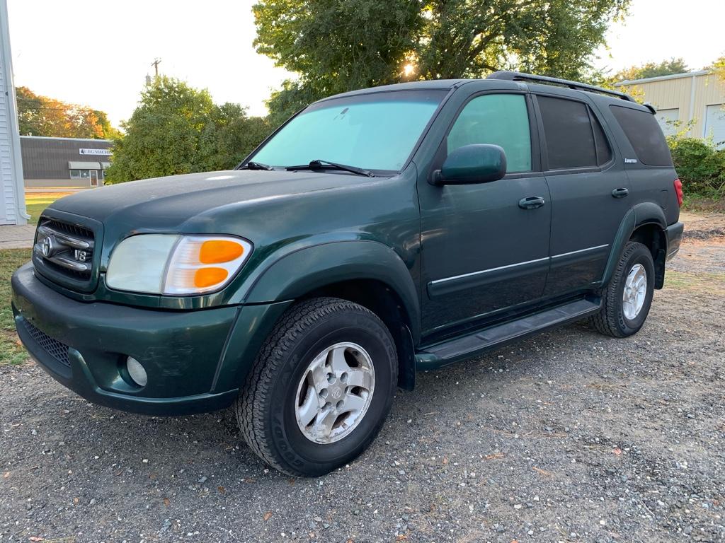

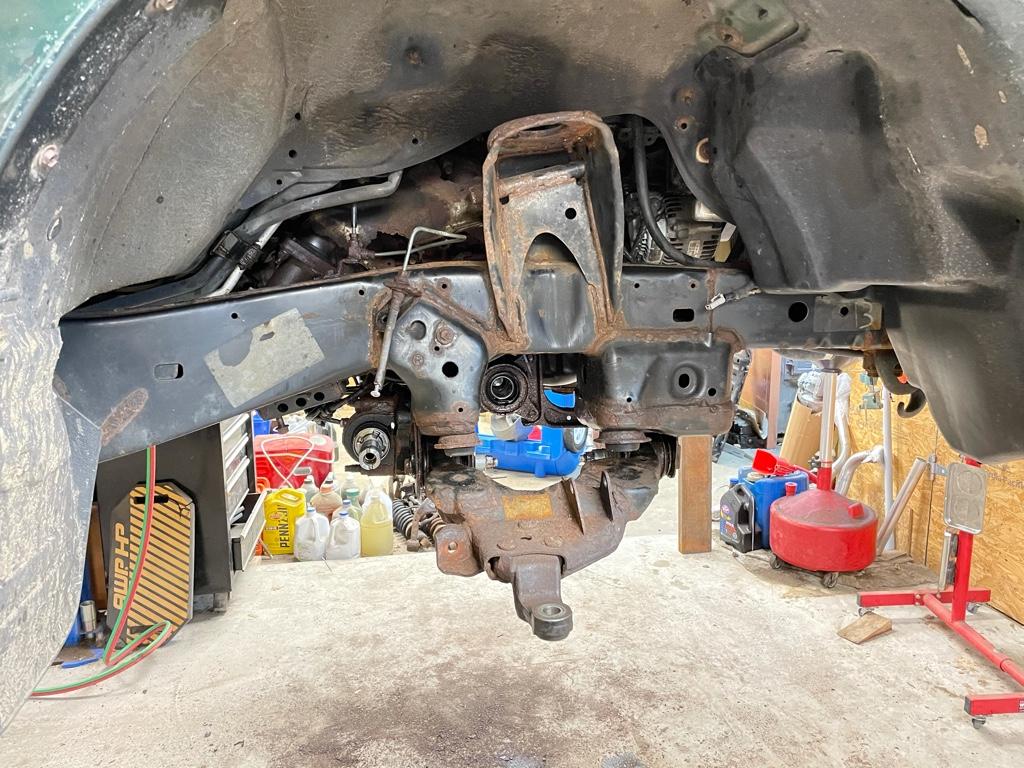

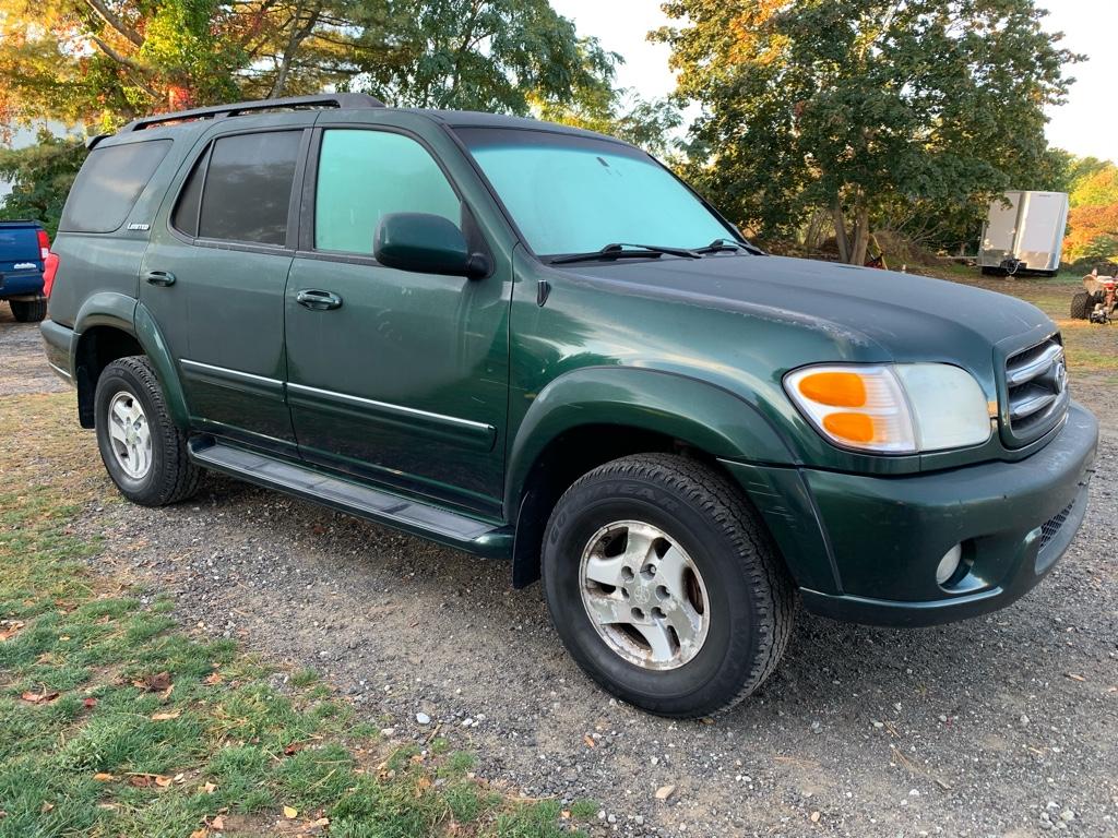

Got into a 2002 Sequoia Limited. These Gen1 Sequoias are basically a T4RXL, I love it! I found one that had the frame replaced in 2013, so it still looks great! Needs body work, rockers were toast, I’m lifting it (3”), 33’s, and doing all major maintenance.

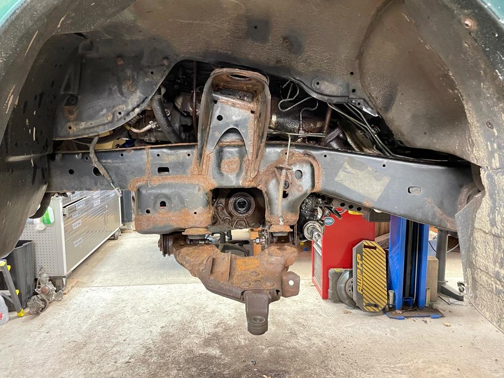

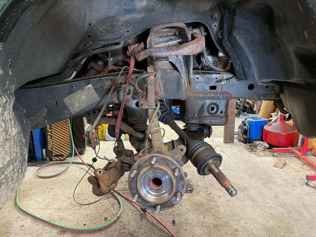

One thing I need (actually 2...lol), both front knuckles. The originals are rusty/crusty, and I’m not fighting with the damn speed sensors or broken bolts on them anymore. If anyone is parting out a low/no rust southern T4R please let me know. The Gen1 Sequoia shares a lot of front suspension components with the 4th Gen T4R.

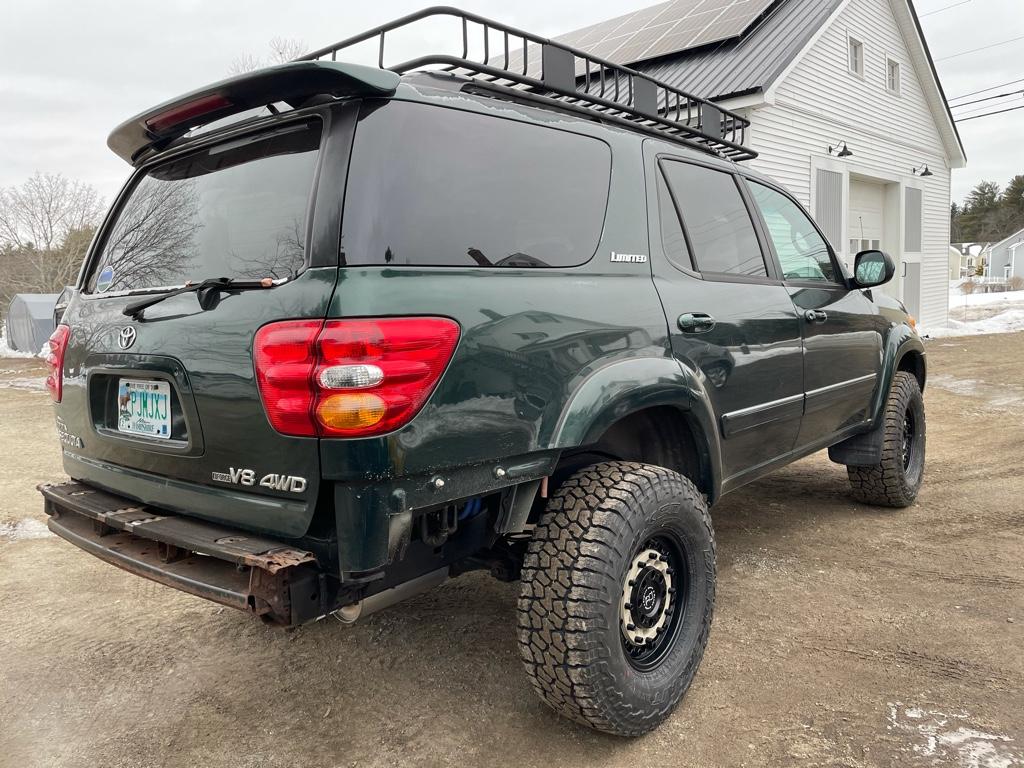

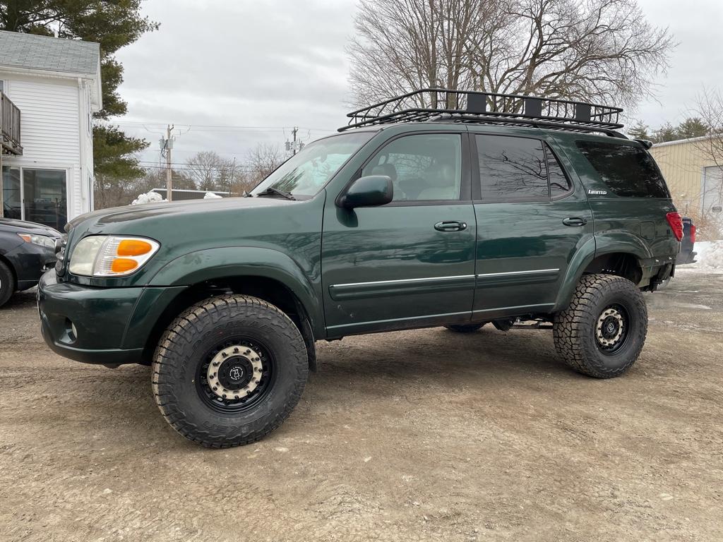

Getting there.....
I call it my 4Runner XL [emoji1787][emoji1787]

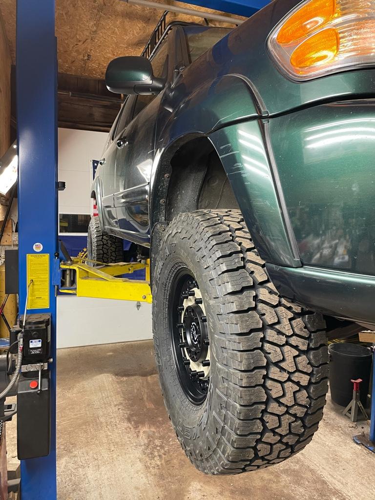

This thing is badass! Especially like the wheels. Not a fan of those style wheels on the 4R or taco, but they look good on the Sequoia!
You know, I skipped right over these wheels at first. But after a fitment issue with my first pick I went with these as a replacement, and I’m glad I did! I like them a lot, they really go with the rig.
