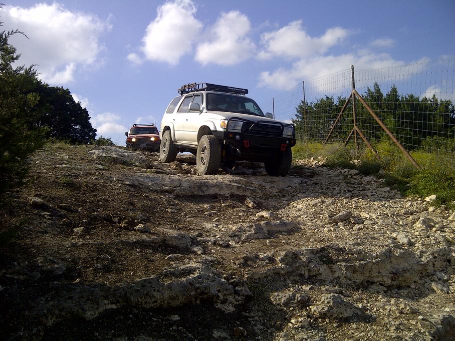

Just got back from Wheeltober fest down near Marble Falls TX. Had a blast and the park was amazing. Here are a few pics from the weekend......

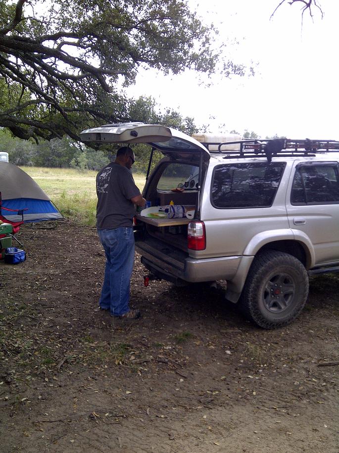

The rear deck I made has become a great pull out work table/cook table. I actually ended up using my dual burner coleman stove on it with the rear window rolled down. Worked great.

Right on good build so far! I'm really diggin that cargo area you created. I would like something like that but I prefer to use the rear as my tent. You should definitely paint your rear bumper to match the front, would pull it all together!

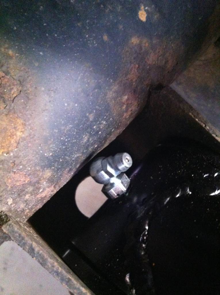

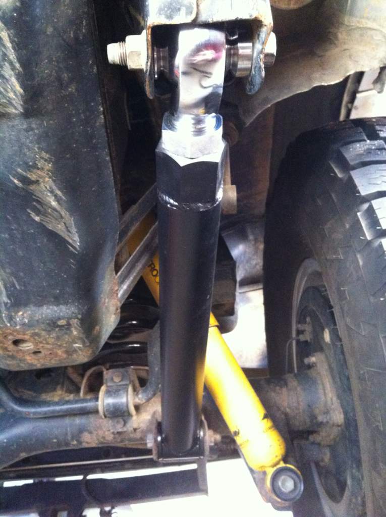

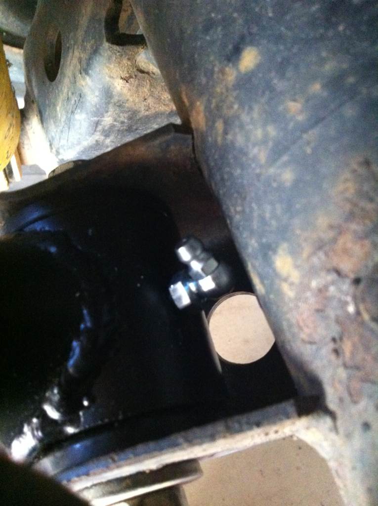

Installed new adjustable Rear LCA's today. Factory setup was kind of bent up. Props to Toytec for the beefy build definitely will not be bending these. I do have a little concern of the location of the zerk fittings as it relates to the axle (right at 1/8" of clearance). Going wheeling/camping next weekend, so ill let you know if i run into any problems.

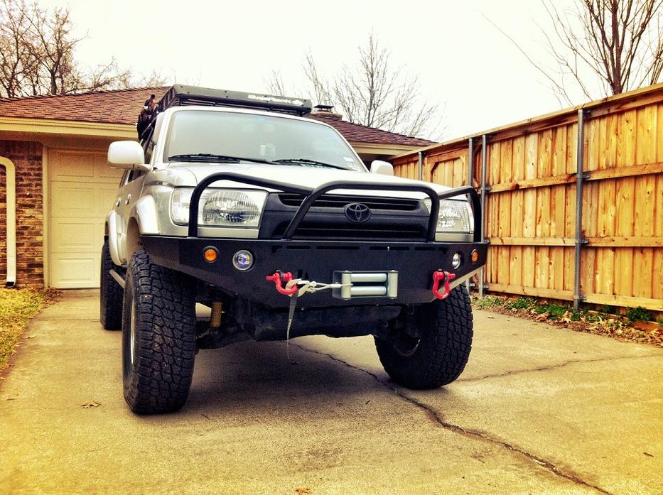

Little update on the build, I pulled the plasti-dip off the rims, plan on going back to black but want to actually paint them. didnt care much for the plasti-dip, seemed to stain that i couldnt even power wash off. Will paint once temps get back up in the 70's regularly. Also threw on some clear corners.

Your 4runner is looking great. I agree painting them is the best long term plan and much easier to touch up. Any plans for a rear bumper?
Thanks man!! Skid plates then a rear bumper. Waiting to see what ODL comes up with for the rear. Definitely getting a tire carrier. Really like the new one addicted has put together. That thing is sweet.

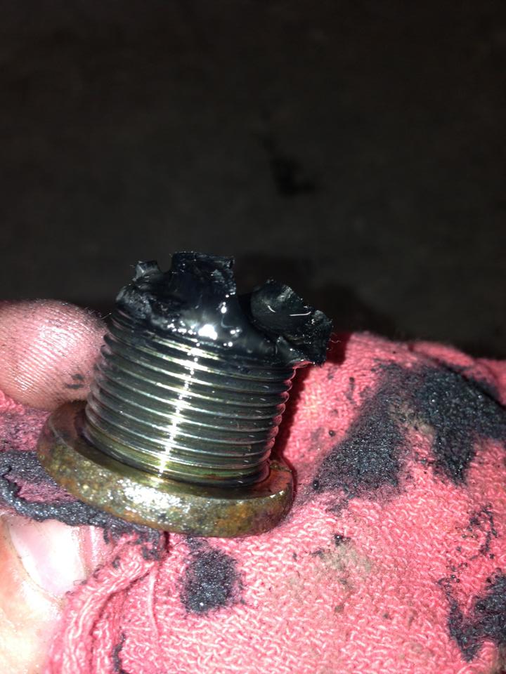

So I plan on dumping the diff fluid out of the front and see what all falls out, there is a heavy clunking noise in 2wd and 4wd so that leads me to believe there are some teeth missing. I have already talked to a local shop and they are working up some numbers to regear front and rear and add a ARB w/ compressor. Gear wise i am looking at nitro 4:56's and 4:88's. Id be interested to hear what your experiences are and if you are wishing you had done something else. I have read [MENTION=47945]brian2sun[/MENTION] comments on the 4:88's he has on 35's but I never plan to go with that big of tire selection.

Well it appears I have chewed about half of the teeth off my front Pinion Gear.

Also i do believe I am going to yank the diff drop off the front end and stretch the CV boots out so they dont rub. I have no idea if this is what caused the problem, but the thought has been making me rethink the application.

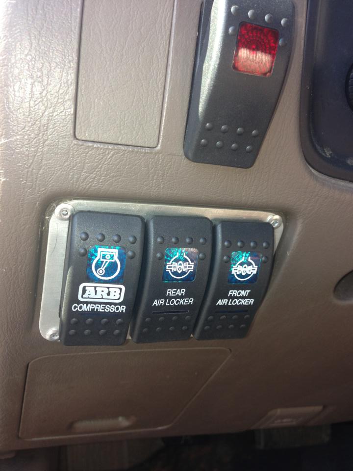

I will probably re fit the switches with a 3 slot OTRATTW switch cluster just to clean things up.
