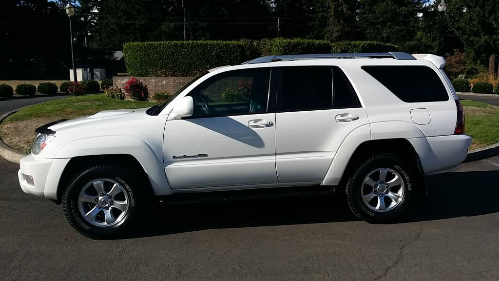

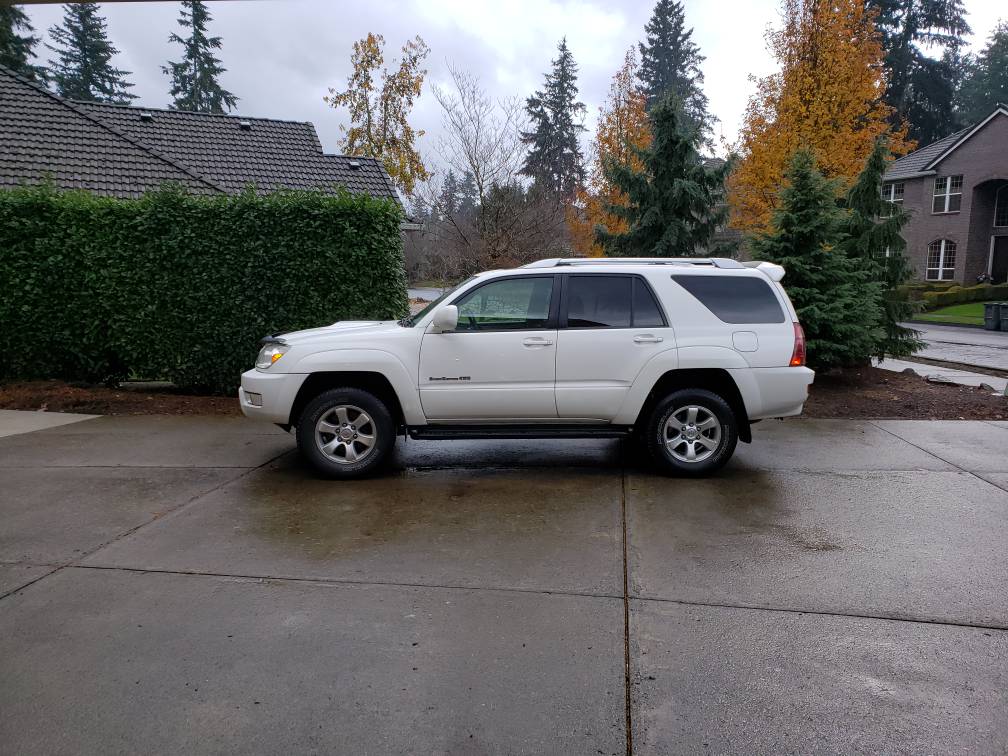

Well I got my Bilstein 5100's installed on all four corners today. I have a stock 2005 Sport V6.
My mechanic disabled the XREAS system (w/166k miles - was handling kind of squirrely) then installed the new Bilstein's.
He has plenty of experience working on these 4Runners so I felt good about that. Some other places just looked at me like I was from another planet when I started talking about disabling or removing the XReas.
He did not add anything like spacers or coils. Just reused the stock springs.
Set the front Biltstein's at .85 in. ( one notch up from the bottom) then did an alignment.
This raised the rear by .25" and raised the front about 1.50 ".
I started with about 2.50" of rake and after he was done it left me about 1.25"of rake.
It has only been a few miles but I am real pleased with the look and the ride! Definitely handles bumps better, reduced the amount of roll significantly, feels real solid.
The old XReas was shot and a couple of the shocks were leaking.
The before picture is on the right, the after picture is on the left. Sorry the rig is dirty (raining)

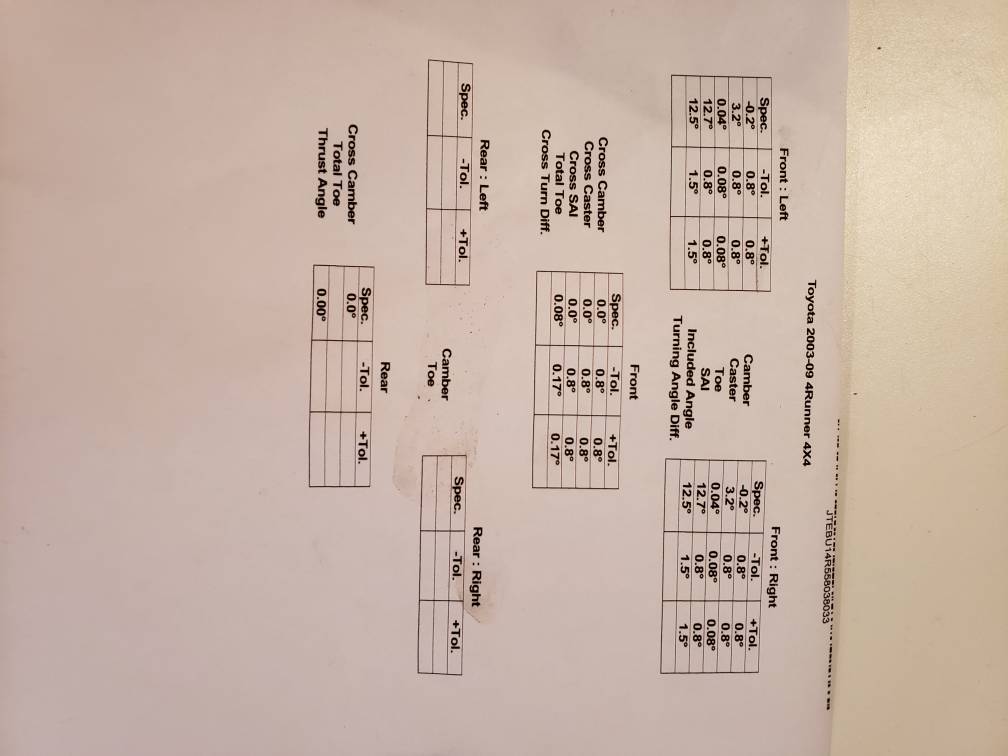

I am not quite sure what to make of the alignment specs in the picture? Are they good? Bad?
This is the vehicle my wife drives so I wasn't going to get crazy with a lift or big tires. Hope this information helps somebody that is thinking about doing the same thing.

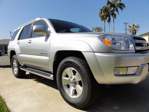

Found this thread useful (as well as many others on here) and thought I would give back. Just did a 5100 install with new OEM type (AC Delco from Amazon) FJ 4WD springs. I have a 2WD SR5. I just set mine to .85 up front and nothing out back. Springs took care of the rear for me. I got quite a bit more than I figured I would. I love it! Rolling on TRD Pros wrapped in Cooper AT3 LT's. 265/70/r17's. Also, I did this install with no spring compressor, as suggested in other threads, and it was as slick as could be.
Running boards are very close to level. And this thing rides and drives amazing!
Before:
ogIQzcvUAF_2sp7Tzm-hC4o1n-WGeWri9ZxbW7P_aeMfuwAGDGIZpN--YYw6J4Rhe0yxvrQtgNB65HtfmqUCJlRFN-h5NSkPOeW8ZvRHnRcoAI6AZeSV_KpzyAu3APiuv1Eaj8UYf_-XxAAPvHCm5Z05v1Sx6eIf6U2Iyx6xb5mmg3zr6B-DoItcOK-Mbr_cCbVjX7smTKncPVxtYuE4hv_bwCozfD_se9H4YbCQWxqdUt190MIgyJmCnpvHL7_gwGFAhiVbR7AKwhfNJBRN9BV2yY0f1sNhHVWsLUbc4BUz9Dn-NDgSUIMxOsnJoNN6koAgbvE90-PqUYu6KqgI5Z9S1gAwUNYMbQpH9BaTMtOxtisigaF5saf-J6s_K0ovV6iR7Z8m5m3-cO9CcOAxpj8y-g0iIeS2HAJy_xuuQ5NM_mKLms_RBsby7HCtQ4hiB96Yc2un6NCpI-iGFvTSGedeRnqHSaT_bDpieviaBwGbyhcoA4CbVzT0G49yLw-DMHL1vUPG7JCi9yHqJzkWkvqD9RtsB68bRsF2HUtzZ9taKuHzHjm7qH9s4vKTRwydX70OcGiw8OJa5xoZrcvSJ031_mJze5s7ylnLrhFoNCTJgeyT-aAlSo5gj-4I_laMtDgHTGqjSxVaJJKimqu64rJN8ePDmLOeMnZyVu3LIwmTSLPaDBPxNRVp=w1100-h825-no
After:
(sorry about this first picture)
EnbBY5GubqnyesMTiVCL-9HITNz9WU-WZxpaOuCIH7ty3o21-y0lrwrt12UK1kEUUtJSxKaoLkkIRAvCuWkcXkCbDUP-Y1FWkwUxyAbSqhec4z-SwBhtMZAR7DCrnSA8Iuxefv3_aFnNr4VklDCIzPfJtgKsS5GXqRQ5Nfc21wB3klb68Jb9ubepyatRZaariDNHX7V6tDeLpFyrdBr_q43EP6IAQwadN3-HbkVtUdueG8D3n8ik5wgEv3Om-UGcp3SI-AImli_ehBWn3eNF5F30Gp7CdsYSY_WOgK0EtXZZH2kpEehD05_aMTpPP5LcWa3nRM0qC-PiesHPSNhxJVzkwxbPt0pmB00fojQnZ6Ab9xhvXrgEATsA0Vp2HM7RcGvlSLEXnQ2QhBT7xSuuAAF_Vz_gksknR3CGCzPwWNFEsR1LOFZ87K0ZWJGaFfxwmynVYyRqfalnBhrS10g_OGKgZLt6qk6wLRyf8XWCI8pn5xzbpS3EoemJ65_dEYa64Lc-CgC--xYxkz8yLegXHYEgzz8J77_UimJXkbe_61cqupc-IHoJokohI5LzdM1x_2orCUDJGQ_vydX4HV4Ks_O3FOtYHjl-_t1e4Wv4tb240NlLxd2a-_27A-4hvbMCgm6SoUQM-YADcQrjM7_mJ-rmhDdvfv7EFgmFSTQ1BRgEc1lYsdpUJXRs=w1100-h825-no
With the new wheels and tires
C41FGFff94gle4iTXI60T6Jwgoic9wgrS8XoDPa4e8cySytLO-ubVUl1uQLhAB4FndrtDLtV6rvLAsbI8gKH87aJButf-axmHYJP5O_Znt4JVHWa61olAN4yHm2g8wvoiQvrVGMM8iLT8_3y9d2LCQriQM-4ag_UItzKofttRyNMy3COn3dZCrVHXwrZ5CYIKWjjqrNC_bKUpVEVYk4GigcIiCEFuo7bjkU7Rm00mh5b4MIQgEtE9Bv0lvSy-K1n-0JW5MVvrV4ApJO2tM6WydFrT3XtYgByNCF2Scg6YQtB0ni_X1S4pxRoL5uCLj8mXkvXjmbkfA934oe2jHB2pfuIqpvKPSJawe2JgiEttMJ6bEDPeuleg2F6_FFuNXiIacPTUfWwib8hKlsxF8iNXiT-l8qDEAyRPzMTlUq8EovvCSa35Mty7BMWIT6W3wOSApv1Zqw1cirhDr0Q0FqpVopwuVZlpZzZOeq9UTLQZtE7tR3_MkaoM0UYRPQ2Vl-cNiSYHXne7JvbcpSYcOA2wwz05lCzReMenKaicPL3AECi9DDVlKrV9-xzpYN8q1MB-Yrqkkt_5-cEZltVTaC380VeZdcZEVYdfEW4AaBjI-phRS63HZhGUQgwSStXIzr66oZ-t6QN8hpLuShgkVb-J6qjX3VH55J8gd6pQERzyic47QFUy9BQ5pc8=w1100-h825-no
0hmqwVnI5QlSdjNm9JKy5I9sR9BsSApGOQS7iQDpgonO4qWIloM5dJVmnFzl55BiqEotlaBbBvuU5r-LSASwYRe6NynbUNzFD9c7NpZySdNs0vGpJJFph6AORg0IfyyLeSUIMNT0TbCOc3Sac5aGK7X_ypN1BsvBVJRgV_Y4nTs0M1dhAq0jjVbYDOjQeIO-Pz63G6fHnWgo6XlaLVj3kaKdMlmwOkLaxjLySdKwr_I0v2iQ3mdsgMkR1ByGKPgFr6bdh6PVHVVs6gAxg2Sddjq6GWB7dwF-CLSebjzPccTI5rkzXM6gI6NuMweff_RJrXw4-rmMG4TkvjD6JInq64rea-BvOQX5f5x6eQnkWFC4pcuNqZzZpvAwdhfAN-XH1vGW_BsEgCCKLp8lumVVy8XILodORq5ahw-WJargTkcSYs1UIus735-3xlUbJo1sc74rlTha5G4CgnSx-TiJSIfpOaEc6096KM0E6wXaCzKByHYlO_pusC-P2G2NIB8o_ju5a-rEVdgAQHoUCdr03b2-i7ivz4hkcc66y2Z5xGxOxUsxNUrSX4w2mO3N42ulNhyzCBZxLoNIH7amcw2gyI2B7XW4jZkFZecJIkfEcZE6aAWdqd2r7TycqlX7EqoTSxpq64PZruGOKKUBVwlb-XLab4KxnasJ9RQKKc6lVG3tKbPziXpnsIox=w1100-h825-no

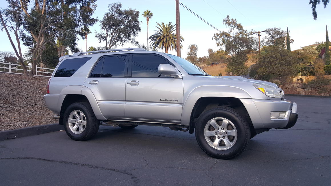

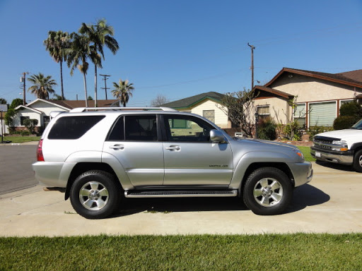

265/70R17 tires Bilstein 5100s, Front @ 1.75, 2017 5th Gen 4runner coils front and rear. sits nearly perfectly level.
<a href="https://ibb.co/PxRNBG5"><img src="https://i.ibb.co/rkgmn2Z/IMG-4905.jpg" alt="IMG-4905" border="0"></a>
2006 V8 Sport with FJ/Moog springs all the way around on 5100's set at 1.75" and a 1" spacer in the rear. It settled about 3/8" lower than this pic. Alignment was able to get 2 degrees of caster with the stock arms

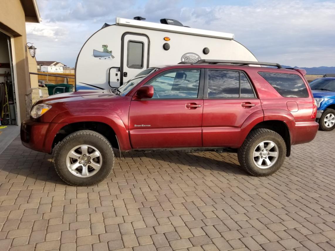

Here ya go ... actually I was wrong, I guess I'm at .85" not the 1.75" ... keep in mind these are still stock coils all around as well... 265/70/17 tires too.
2nd setting from bottom up...
