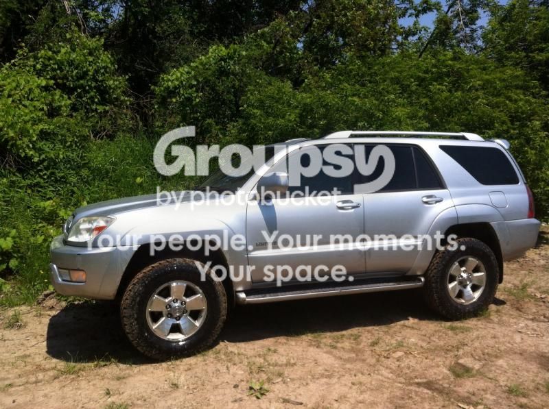

1.75" setting here. Factory coils front and rear. Sits with 1/2" or so of rake, but can only tell with a tape measure. Looks like it sits almost exactly level when looking from the side.
What? No love for the 1.75 setting? Here's my V6 on fj springs, no spacers, so slight rake to the rear.
