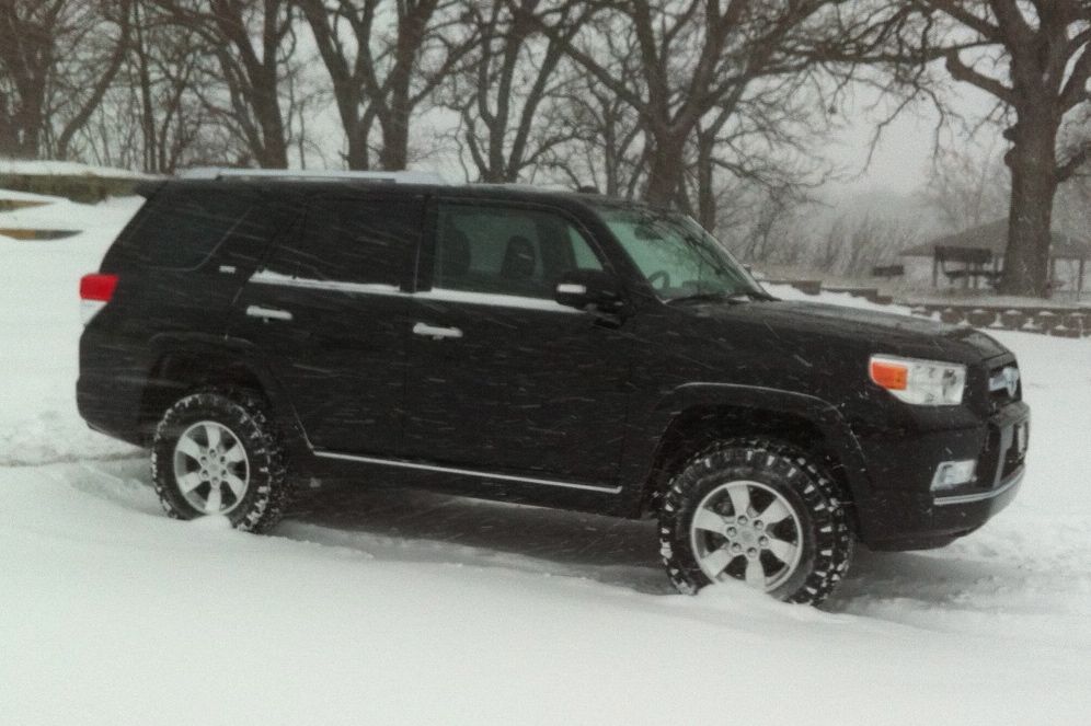

Can't say what will happen with your scenario BUT I installed the 5100s front and rear. Front set at the 3rd ring and with my mechanics measurements, he stated the front had ~1" drop from the rear.
From my perspective, it does appear to have a slight rake. The objective was to minimize the brake dive and firm the ride, objective met.
Also added the Goodyear DuraTrac's (265\70\17), a little more tire noise than anticipated but livable.
I now have a 4X4 verses a crossover and lovin' every minute of it.
