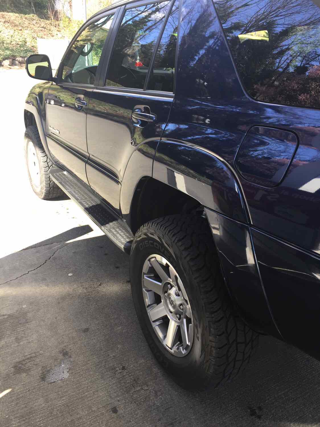

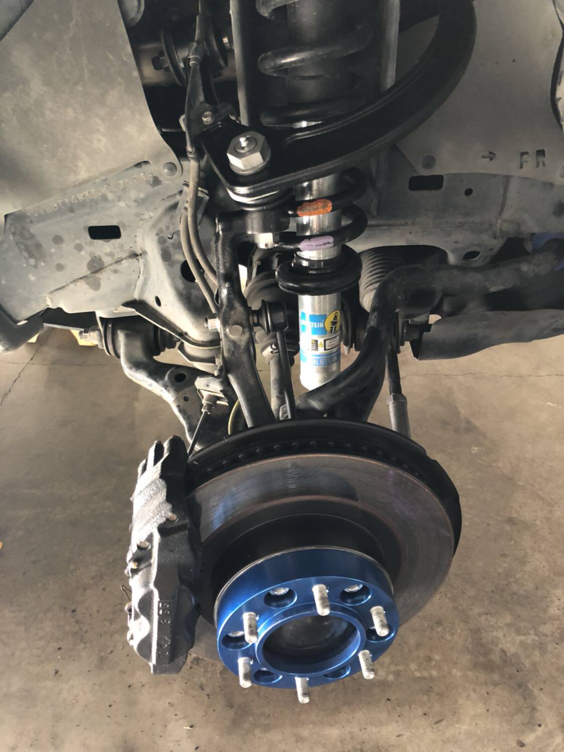

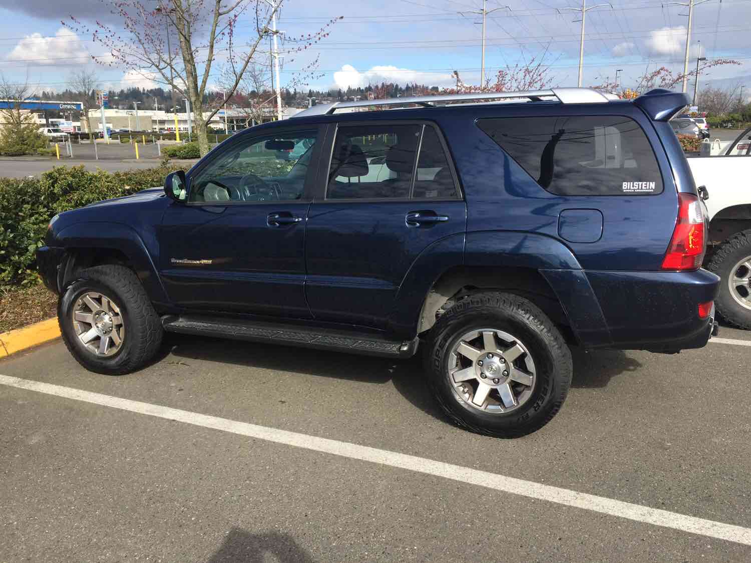

This is definitely an acceptable setup for the average occasional off-roader or daily driver. I've had it for over a year with no issues. I don't find the ride to be overly stiff at all. I helped a friend with a 4.0 4th gen do the same lift and he is happy as well. Stock UCAs. Got around 2.5 degrees of caster. Drives like I would expect a ~$360 lift to, maybe even better. The only change I made a few months ago was replacing the rear springs/spacer with Toytec Superflexes. Only reason I did that was because I had some extra cash and wanted to improve rear flex off-road and sagging when I have my camping gear loaded in the back.
It really comes down to what your budget is and what your intended use is. If you are planning on wheeling hard and often, then you should spend some more money on a better lift. For those in between and on a budget, this works well, IMHO.
You have pics of your 4runner on this setup?
Sent from my SM-G930V using Tapatalk
