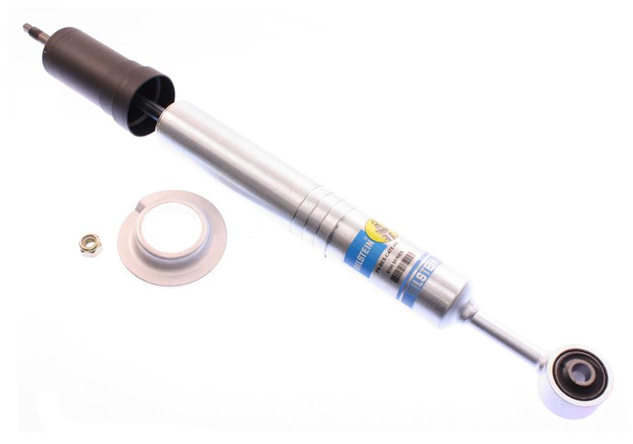

A pair of snap ring pliers is what i use, granted there are many different types, you will see what you need when you get the shocks.
I have the shocks and I have snap ring pliers, but I did not notice any holes in the clip ring on the shocks - will go back and have another look.
No holes on clip for snap ring plyers. But snap ring plyers are the correct tool Just use the tips to spread the ring and slide over shock body into position. The twist ring in groove to ensure correct placement as previously stated.

Over stretching the ring would definitely cause issues...what you can do is instead of trying to remove the ring fully from each groove, just pull one end out and slowly walk it upwards to the next groove; rinse and repeat for the other end of the clip. You continue this until you get to the desired groove, but this way you expand the ring very minimally and it would be less likely to loose it's spring tension.

Yep, that's sort of how I approached it. Instead of spreading the ring wide enough to clear the shock to slide it all the way up to the 2.5" mark, I opened it just wide enough to get one end unseated and moved it to the next groove. Repeated that until moved all the way up. Still seems to fit plenty tight. Does not spin freely but turns easily by hand.

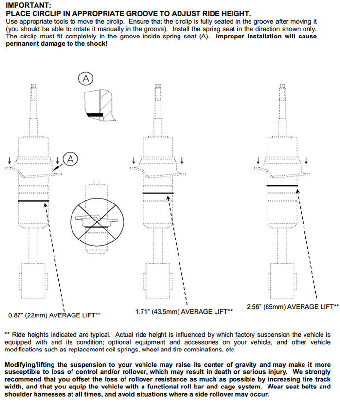

The clip rests in a groove and the spring perch sits on top of the clip (about half of it's width is outside the groove once installed)- so all the weight/force is on that clip.
It would take a tremendous force to shear that clip off when it's installed correctly- I bet you would blow the spring over the perch before it could bend or tear the clip. Just a guess on that though...
It would take a tremendous force to sheer that clip off when it's installed correctly- I bet you would blow the spring over the perch before it could bend or tear the clip. Just a guess on that though...

I'm just going by what Bilstein themselves say...in that the steel spring seat would fail long before the circlip; so logically speaking, if a circlip gave out instead of the spring seat failing, I would imagine that something was not installed right? Obviously I don't have fancy calculations and the brains to do it, lol.
Fast forward to ~0:30, straight from the manufacturer, they sure sound confident enough to make a statement like that publicly?
Besides, the way I see it is...having vehicle sitting with one shock busted on the passenger side is not much different (in terms of forces on the spring seat/circlip) then having the front end flexed up with one wheel in the air? Hence why I went with my guess that the other shock must've been installed similarly as to the one that first gave out on the road...
Not that I plan to, but I mean should we expect failure of the circlip if you have it flexed up for too long? :noidea:

agreed. even if the clip broke in 2, as long as the perch is positioned correctly, it would still do its job.
the perch contains the clip, I don't see how its possible for the clip to come out.
op, can you get us a pic of the lower portion of each side? both the one still working, and the one that failed.
