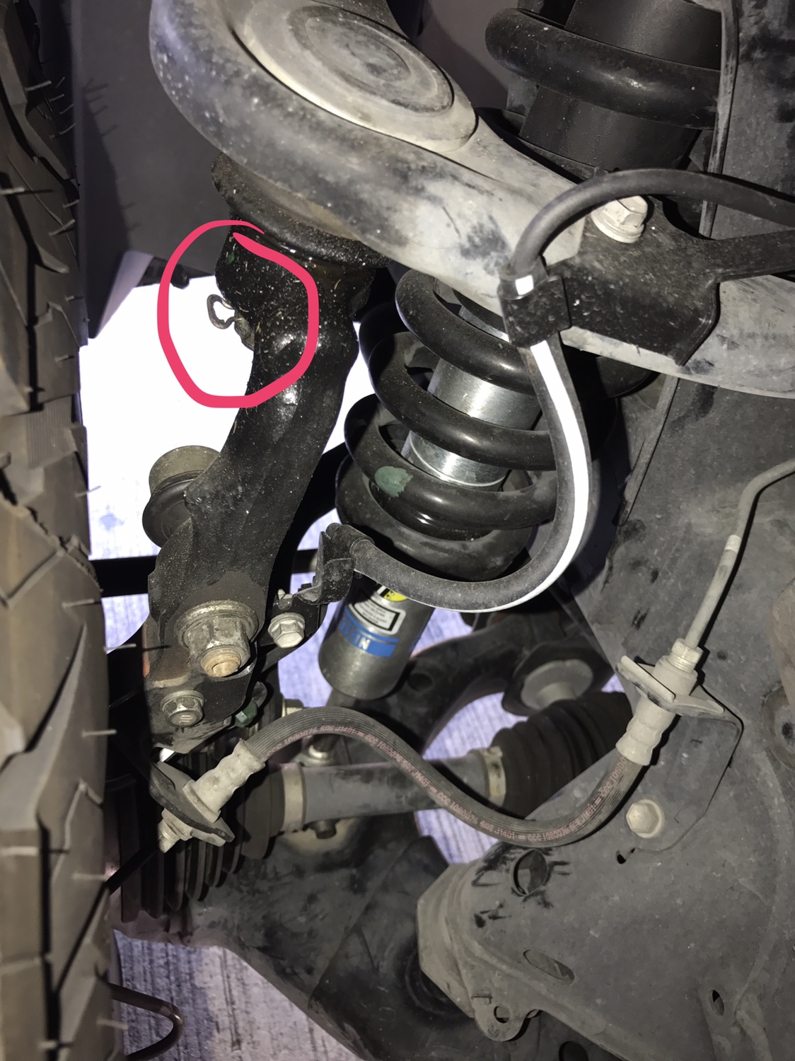

4. Random rattle noise from front end. I heard a tiny rattle noise now and then from front end. It’s not loud at all, I can only hear it during mild accelaration from 20mph-40mph. It’s like a small bell ringing sound, I’m not sure if this is the best way to describe it. During the installation, ABS wire was stretched and replaced. Maybe the wire was not installed properly and makes noise? The mechanic who install the suspension said he cannot hear anything (of course) and they offer no warranty on customer supplied parts, so I have to diagnose the cause myself, any feedback is appreciated!
The rattle is likely a c-clip on the suspension up front. The noise has been reported before several times and that seems to be the culprit because it is loose in the notch. Not a safety issue. I would not run the air any lower than manufacturer door spec (32psi). Their reason for that recommendation is it provides the best compromise between ride comfort and tire durability. And anything lower could generate more heat in the tire causing early failure. Heck, if I could get a way with it I would run the 20 psi I do off road! You want a Cadillac ride? Lol
Thanks for the reply. Are you referring the c-clip in the groove that holds the spring perch? I will do some search on that.

Oil leaking here...
