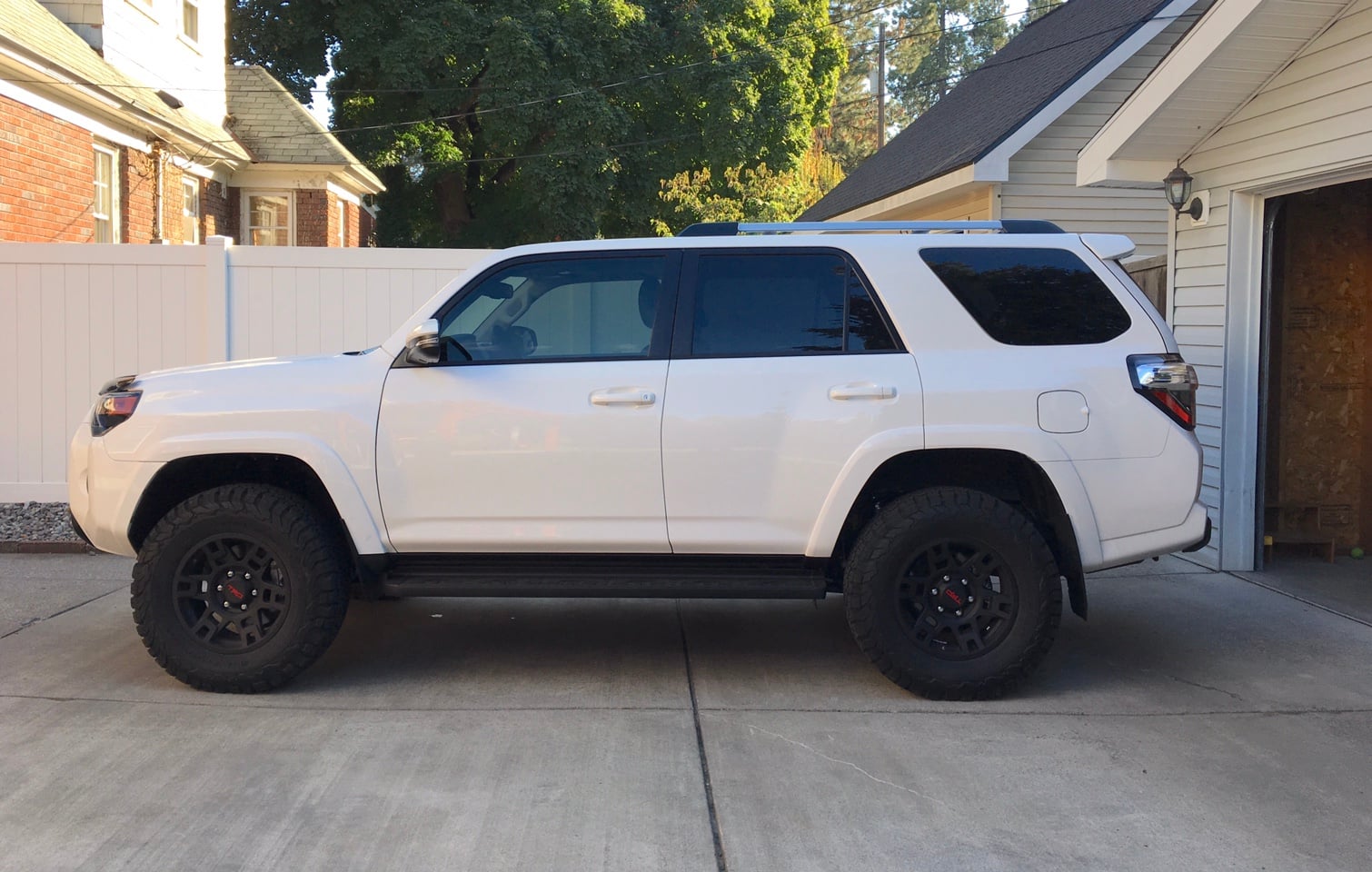

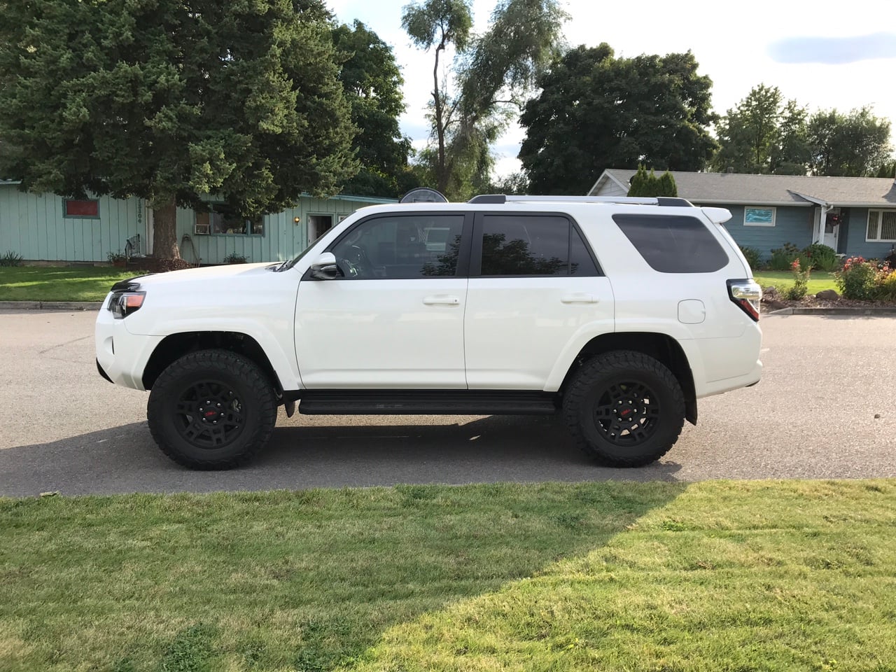

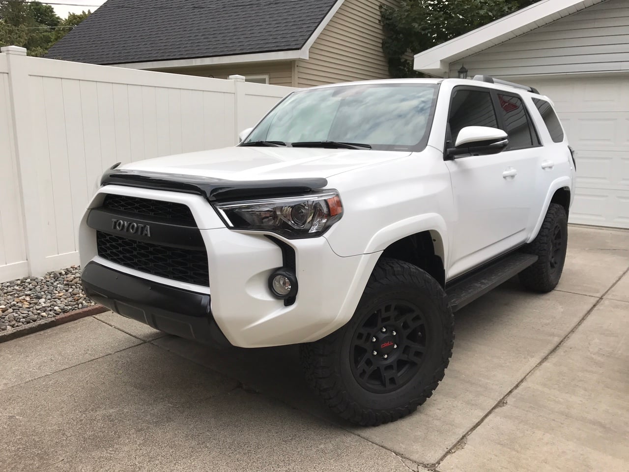

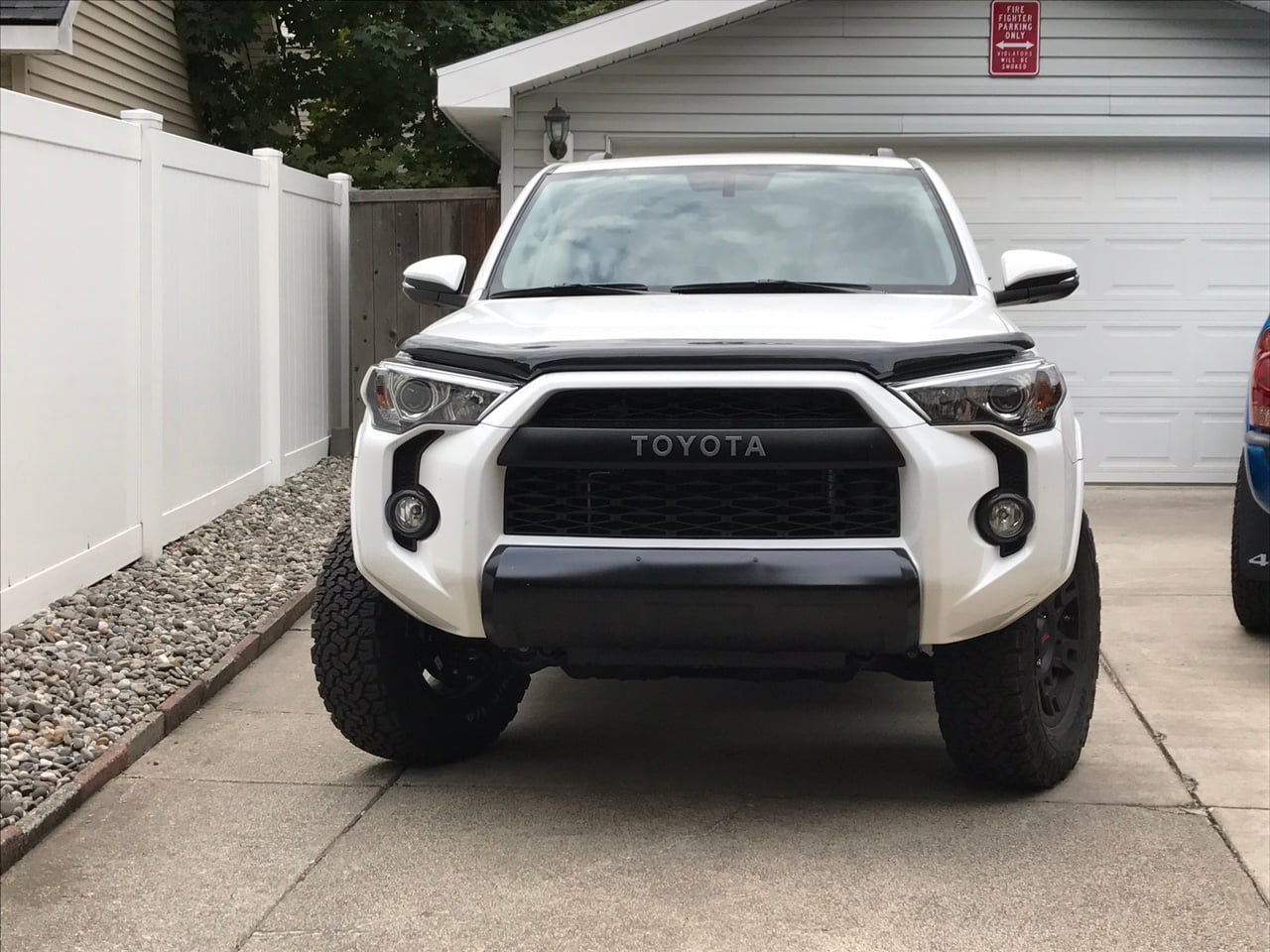

I only have this one. I need to take more and still haven't gotten a good before/after comparison.
Is this with a 1" spacer as well? The stance looks a lot different than others with the same setup, maybe the ground is uneven here or you have a load in the back perhaps. Either way looks great!
I think it's the ground playing tricks. This was also right after we pulled it out of the shop and it might have settled since. I'll try and get some better pics later. This is 1" spacer in the rear

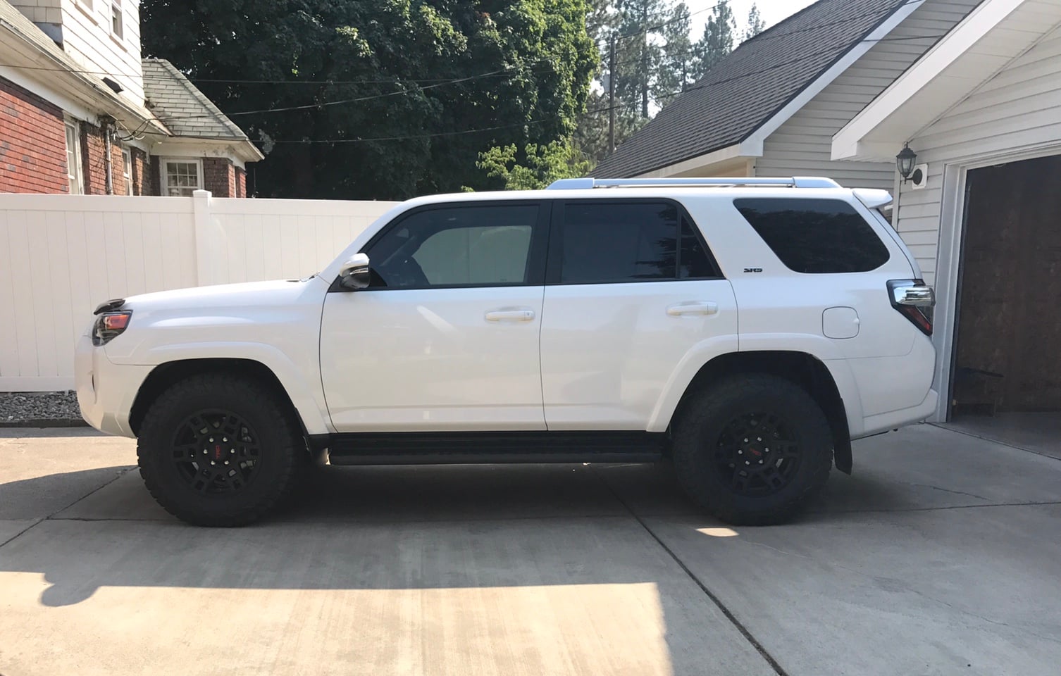

[MENTION=170834]samwhich[/MENTION] [MENTION=154369]Superwhite17[/MENTION]
Top: w/275's Before 1500's
Bottom: After 1500's + 1" Spacer
