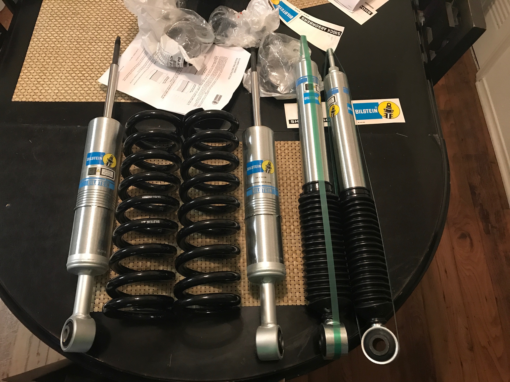

6112/5100 showed up yesterday! Most reviews I've read said this setup if similar to stock rise but definitely better. The 6112 will have improved dampening over front 5100. You should know that for 2x4 models, there is only 1 lift setting which is 2.5".
