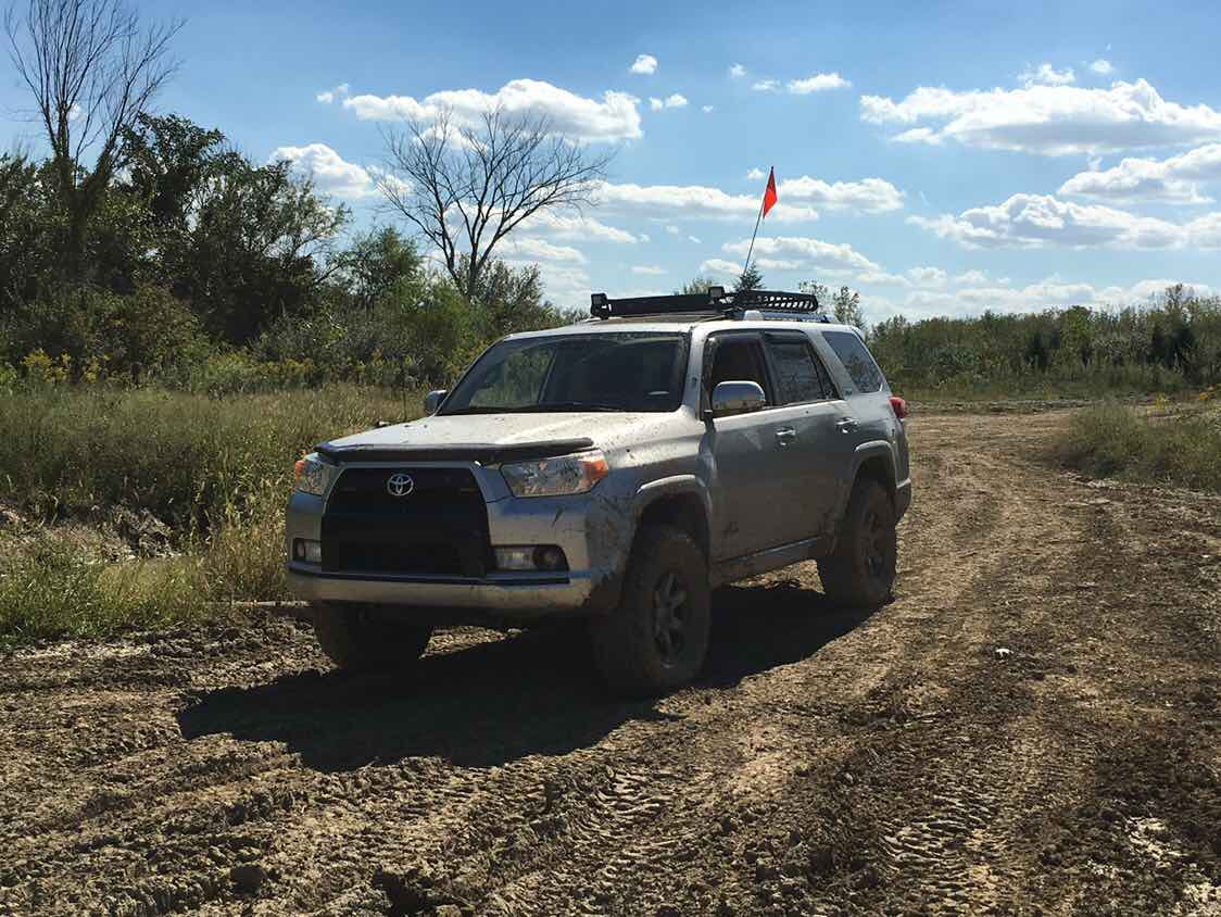

I’ve been running the 5100s in stock coils now for about 20,000 miles and I absolutely love them. I off-road regularly and they have never once failed me. I don’t even think about the suspension right now or wish I had gone a different route, which says a lot for me.

Yes, I believe it does. I off road more than anyone I know and I’m totally impressed and satisfied. I also tow a trailer regularly and these 5100s have exceeded their price point. It’s possible a suspension snob would be able to tell me how “crappy” my suspension rides, but I honesty love driving the truck on and off road. I’m sure a $3,000 reservoir setup is better but this is such an improvement over stock and given the sheer amount of abuse I’ve put these through, I’d buy another set in a heartbeat. They have exceeded every expectation.

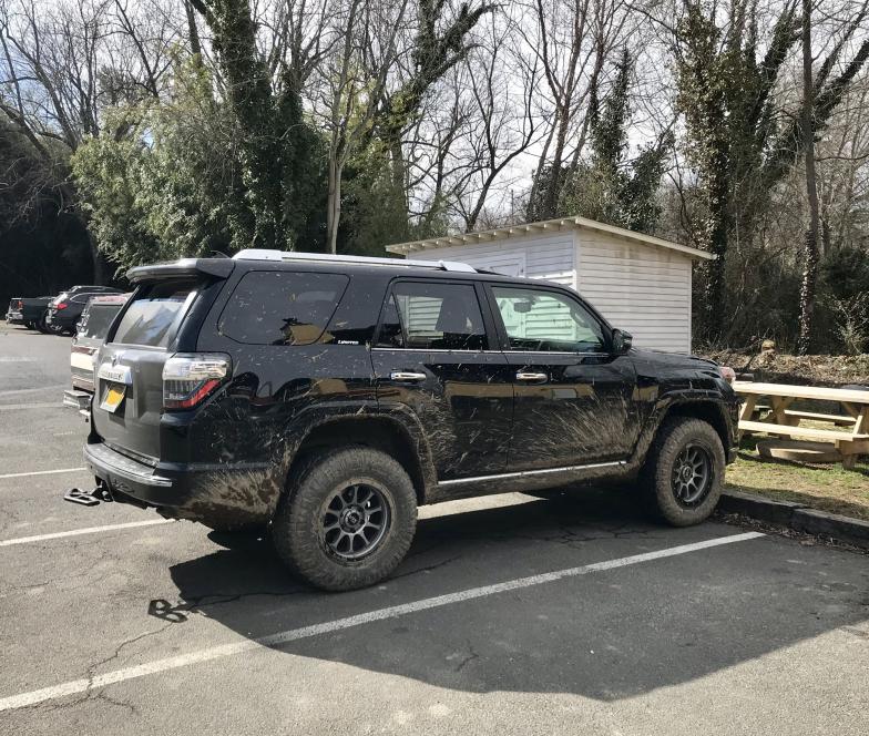

i did 6112 and 5160s on my limited. set the 6112s to the 2.5" setting and added dobinsons C59-505r 1.5" lift coils. I dont have a lot of weight in the back of my limited (no third row, etc), and i got 2" of lift from the coils. you may get more than 2" with the icons. i have a 1.5-2" rake with the 6112s at the top perch settings after the bilstien coils settled. 22 and 22.5" hub to fender in front, 24 in the rear
