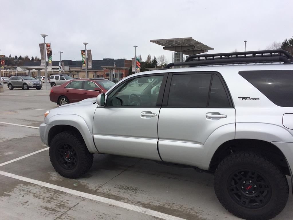

Interesting stuff. I'm currently running 5100's all around on my 4th gen, with Eibach/Toytec springs front and rear. Like 'em, but since I may buy a 5th gen model soon, I was very interested in your opinions of the 6112's. I guess you're all lifting the front a bit, for leveling or whatever, but nobody mentions UCA's. Does that mean the stock ones suffice? It's always a weird one with my truck. Nobody would say yes or no, so I left them stock when I did the install. Cheers, G.
