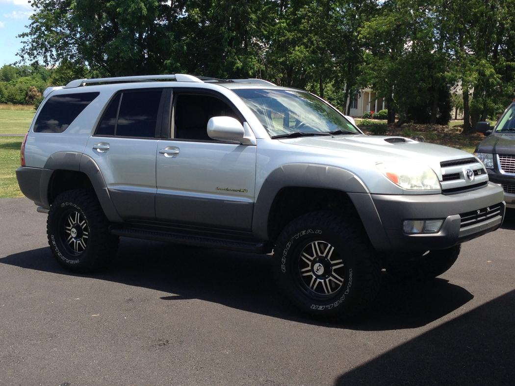

Here is a pic of my OME 885 with 5100s set to lowest setting. Only difference in my setup is I went with Toytec Superflex coils to soften the often reviewed "stiff" ride of the OME rears.
I used the no spring compressor installation method and with the help of a long pry bar and additional set of hands installation was not too difficult.
