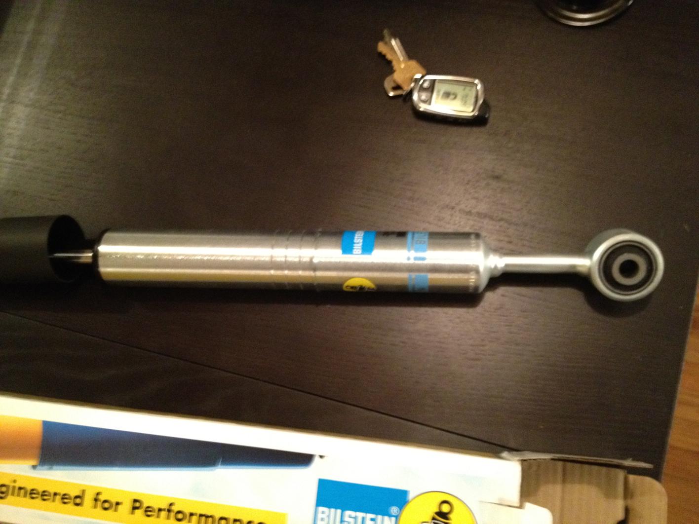

I just picked up the new bilstein's 24-196499 last week. I was told the difference is the bushing mount on the bottom of the strut. Plan on installing them on Monday.

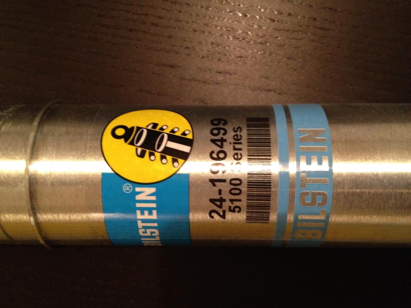

There is a distribution co. thats works directly with the Bilstein factory in Poway (San Diego) called ASI. Their website is shox.com these shocks are not listed on their website or Bilstein's. If you call the Bilstein Poway location they will confirm this part # and ASI(shox.com) has them.

P/N 24-196499 Differences
I just called Bilstein in Poway, CA and spoke with one of the tech guys. He pulled up the data sheet for the old and new P/N's and told me the following things were different:
- Valving slightly different (though I didn't ask him to clarify this and should have)
- Compression is slightly stiffer for high-speed and low-speed
- Heavier rebound
- Small length difference (as noted by OP)
- Eyelet is 3.5 mm wider
- Different bushings
I've been planning to get a Toytec Ultimate Lift and just called to ask if they're going to rev the Ultimate kit to include the new P/N for our 5th Gen's now that the new shock is actually in stock and available from Bilstein -- they're looking into it. I'll post what their response is when they call me back.

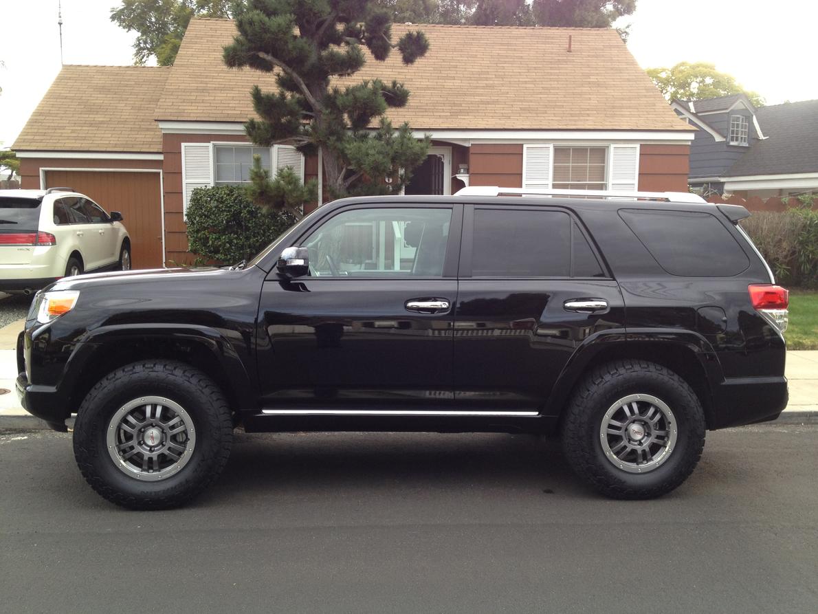

So the fronts are set at the max 2.5 - did you replace the rears as well with the 5100's and, if so, did you do the 1.5" or 2" spacer?
The truck is 'leaned back' (with its mind on its money, and money on its mind). I am assuming there is no cargo in the back?
Now that the new parts are out I am just debating on if I want to do a spacer in the rear.
