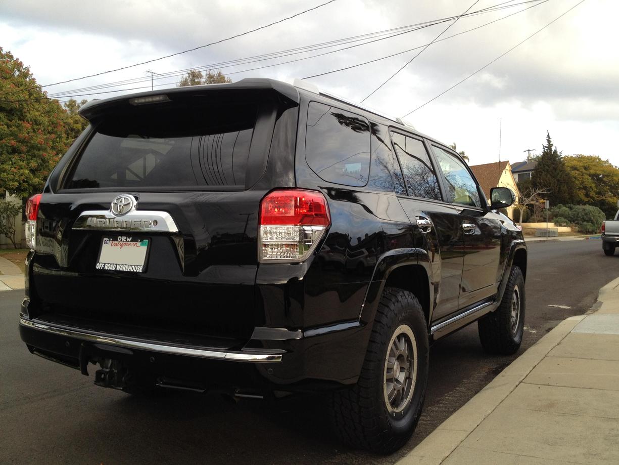

So the fronts are set at the max 2.5 - did you replace the rears as well with the 5100's and, if so, did you do the 1.5" or 2" spacer?
The truck is 'leaned back' (with its mind on its money, and money on its mind). I am assuming there is no cargo in the back?
Now that the new parts are out I am just debating on if I want to do a spacer in the rear.
Yes I replaced the the rear shocks with 5100's. I was thinking about adding a 1.5" spacer or replacing the springs not sure which direction to go. That first pic looks more " leaned back " than it really is. Its around an inch higher in the front than in the back. either going to lower 5100's to 1.75 or add rear lift spring/spacer.
