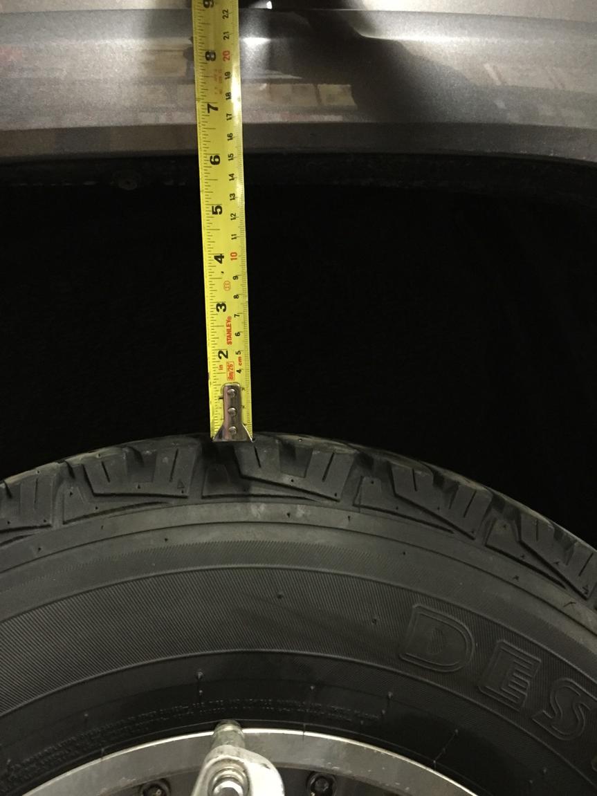

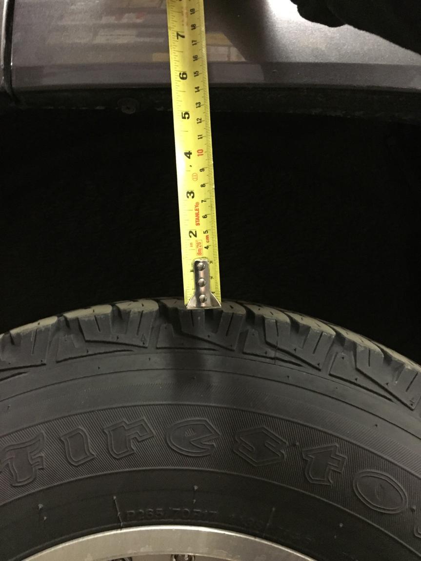

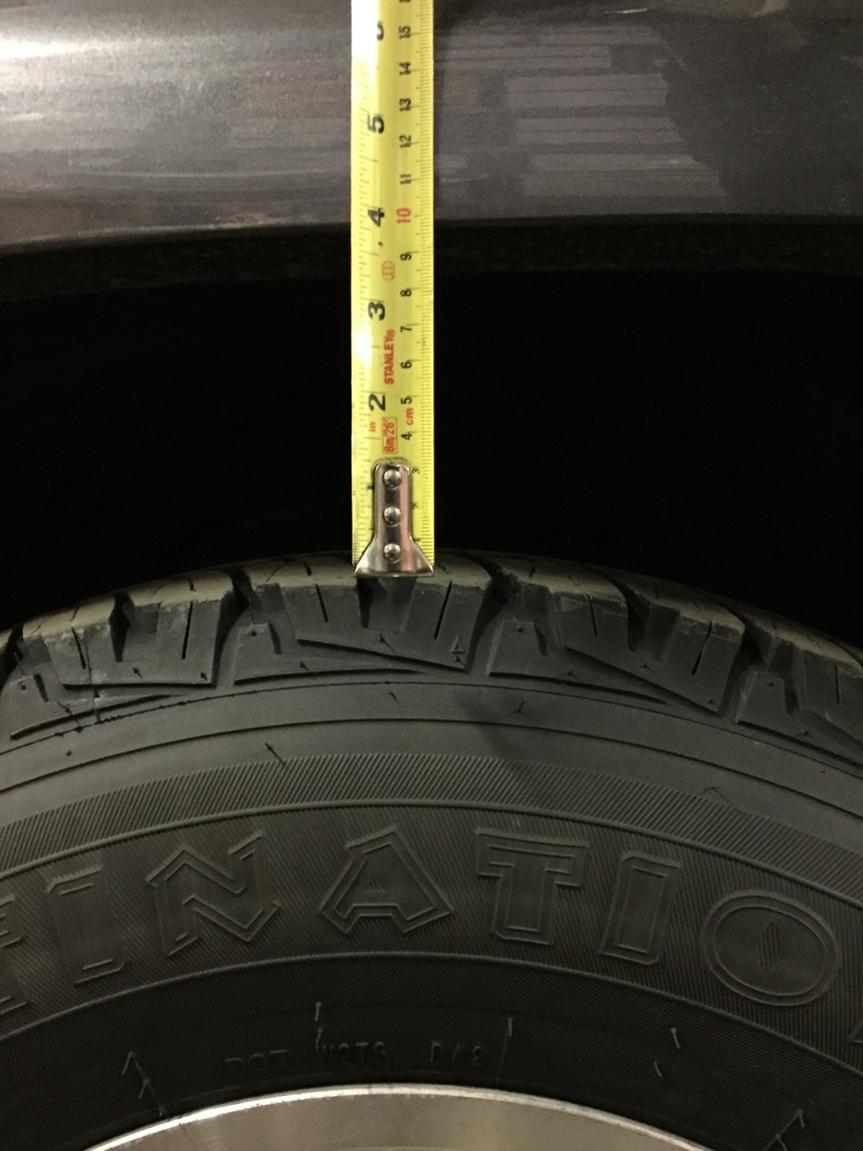

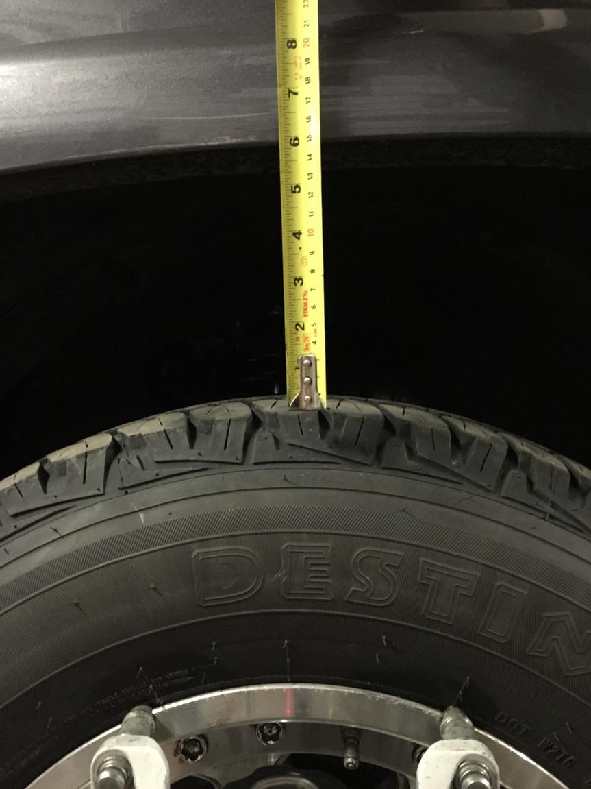

Here you go. Kam specialties in reading PA did the install. They spent almost 4 hours on the aliment. And man its perfect.
Pictures 1. Front before lift
Pictures 2. Rear before lift
Pictures 3 front after lift
Pictures 4 rear after lift

What setting did you put your circlips on? Rear is stock?
Yes I put it on the middle or 3rd setting. Yes they are equally left to right. As far as the aliment is concerned these guys set up scca cars and also just about every other kind of race vehicles in the area. They don't do a 30 min OK it looks good aliment. I am sure the tech owner is more then qualified to do the job right. He was elio Castroneves and same Horneishs head engineer for 5 years at penske. I think I will trust him a lot more then you doing it on your lunch break just saying. Anyone could do the job but I prefer it done right. Oh yeah so that might be why I am the only one who didn't have problems with the lift being installed. I did put new upper shock tower mount and bushing maybe that is what is causing issues with right to left ride heights. The car had half a tank when install was done.

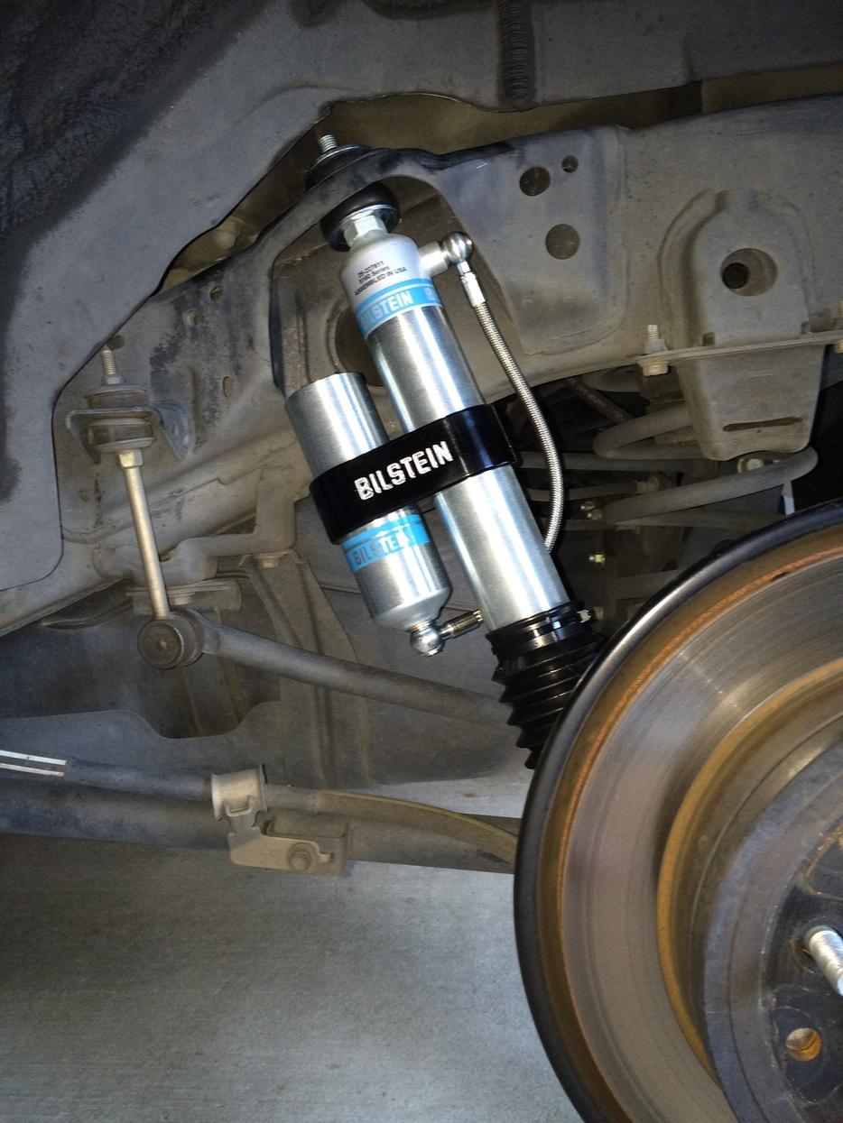

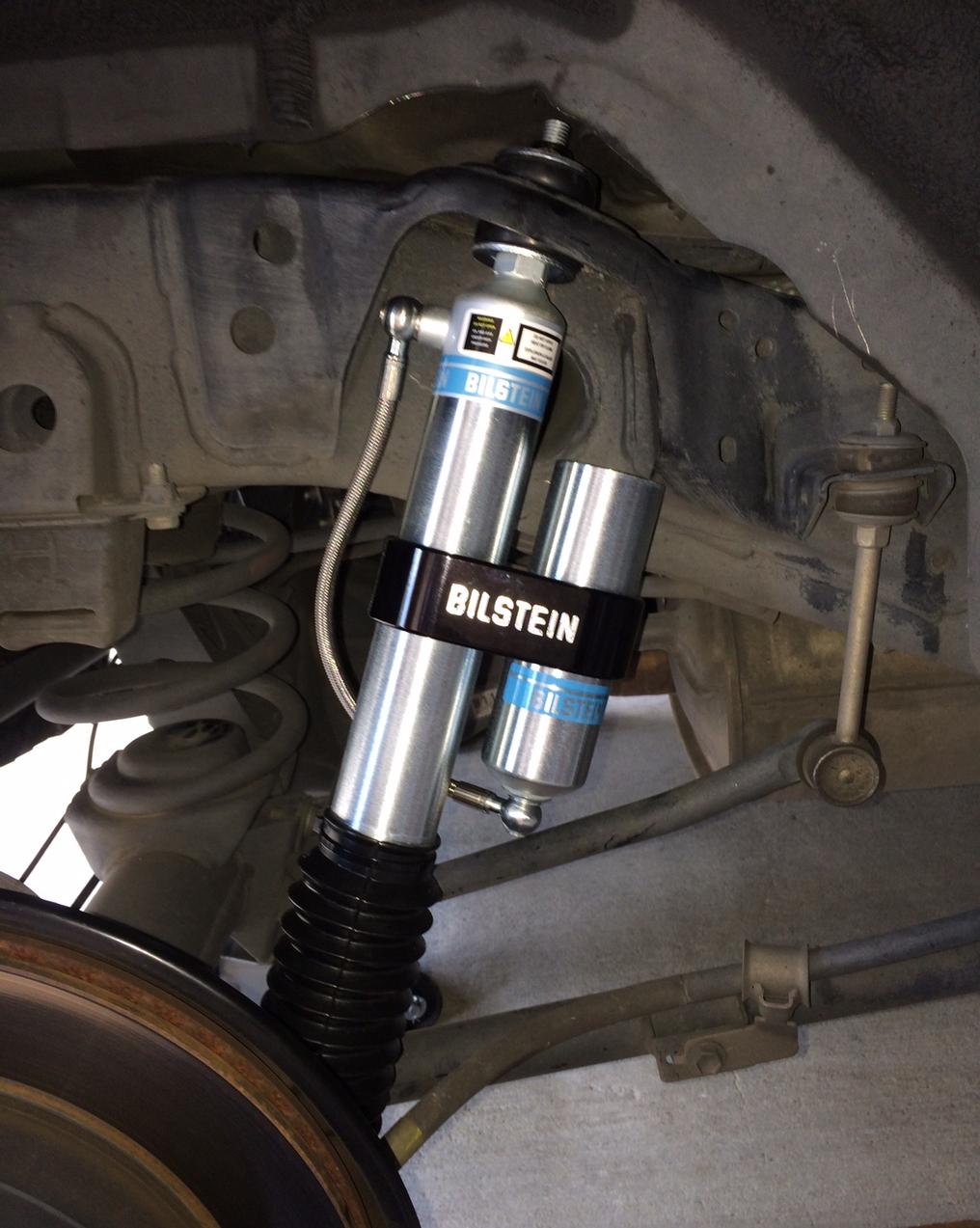

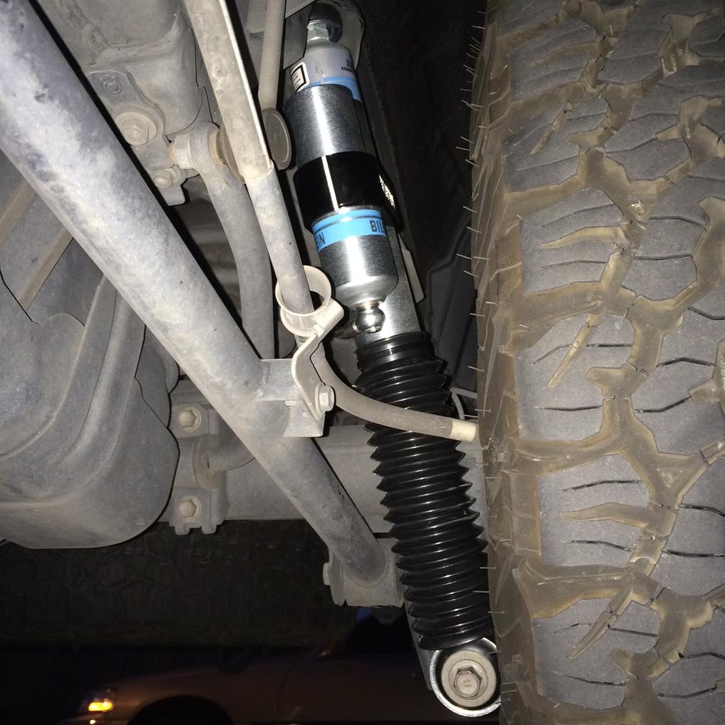

Installed my 5160's this afternoon, will get 6112's installed next Tuesday.
[MENTION=77958]Zeusmotorworks[/MENTION], --> Thank you sir!
I used Zeus idea of flipping the label on the remote reservoir. Thanks again!
For clearances of the remote reservoir to frame, here are the measurements I used:
Billet Clamp is 2 1/2" from bottom of decal at top of shock.
Top of the Remote Reservoir is 2" from Billet Clamp.
These measurements should hold true to 2010-2015 T4R's.
I used these after installing and checking for any clearance issues.
Once satisfied I was able to use Blue Locking thread compound & tighten everything up off of the vehicle, then install.
