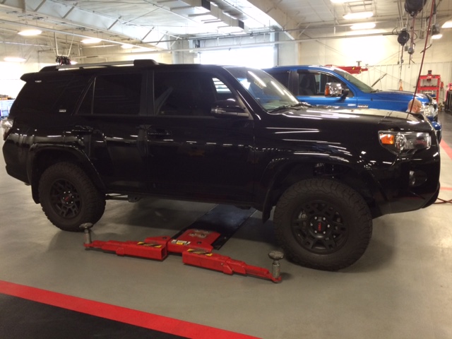

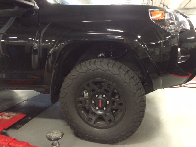

Status Report:
After seeing what the lifts were at the different spring seat circlip grooves, I decided to place mine on the middle groove and shoot for a 2" lift.
It came in at exactly 2"
Front L & R Side = 37"
Rear L & R Side = 37"
Alignment done...drives really good and nice ride quality with these 6112's!
Photos included!
I threw in a flex photo. Flexing in a small ditch...
