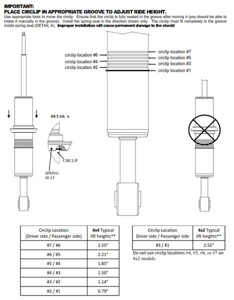

I just ordered some 6112's (47-259768) for my 2016 TEP. In case anyone else is curious about the clip settings versus the 5100's, here are the specs:
roborob1969-albums-2016+toyota+4runner+tep-picture44021-bilstein-6112-47-259768-2.jpg

Here is my concern with the specs.
I'm going for the full 2.5" lift on the front, and used the 7/6 setting as shown on the bilstein instructions. But because of the KDSS system, I still have a 1" lean (passenger side is low). Once the rear struts arrive, I'll get the wheel alignment done, and if the system hasn't leveled itself out by then, I'll have the dealership do what they can (ie. bleed the system as recommended by this forum... but expensive if I screw it up). The passenger side may need to come up to the top notch to get help level it out... which means it'll be another couple hours work to pull out the strut, disassemble, move the circlip, assemble and install.

The non-KDSS trucks have a driver-side lean so the 6112s are supposed to correct that when set to the Bilstein instructions. If you do that on a KDSS rig you're exaggerating the already present lean.
If you go to the dealer and they measure anything under 0.787" of lean that falls officially within Toyota spec and they won't touch it.
I would bet you could swap your two front 6112s set the way they are and your lean would get better.
It's best to take measurements of your stock setup and make necessary adjustments to the 6112 prior to install.
Well damn. I sorta wish Bilstein had put that in their instructions.... oh well, I guess I got work to do. Thanks.
My point exactly. The instructions assume that all T4Rs have a passenger side lean. They should be revised to tell the installer to measure the front of the vehicle for any lean before setting the circlip positions.

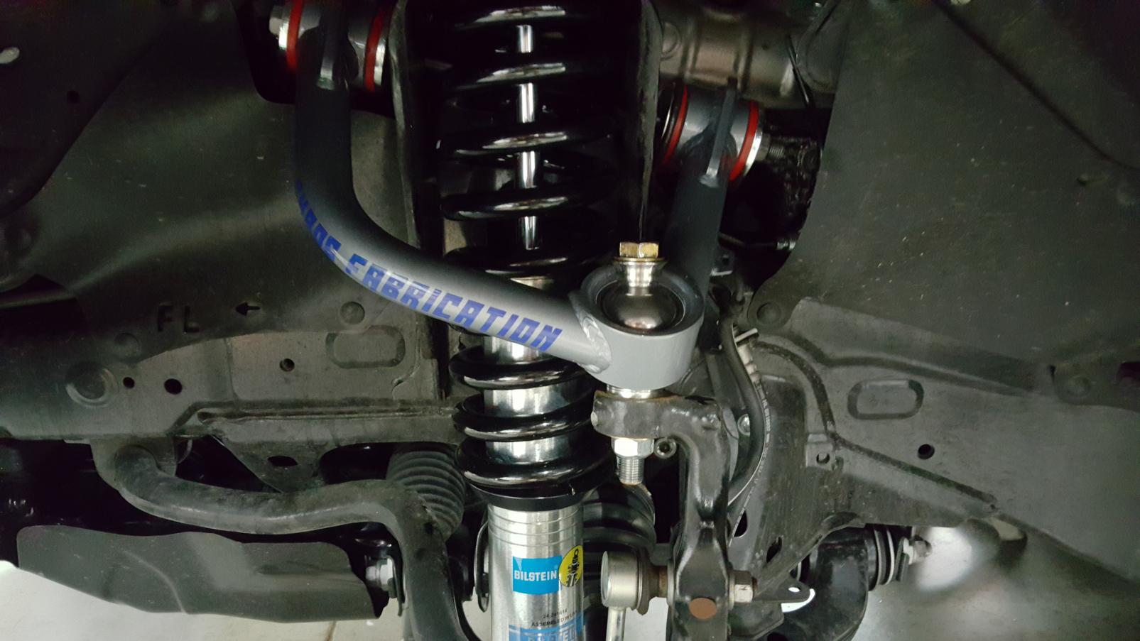

6112/5100s with OME 2885 rears and TC UCAs. Ride quality is amazing compared to stock. Gone is the nose dive, lean while cornering and overly soft bouncy ride. Highly suggest the 6112s if your on the fence about them.
Looks great. Few questions, was there a reason for going with new UCA's? Which setting/perch for the 6112's? How many inches of lift in the rear? Thanks...
Everything was off the truck already so i figured it was a good time just do the UCAs as well. Added stability and flexibility for alignment. Figured I do everything right the first time and not try and cut a corner. You could get by without getting UCAs though. Just have to find an amazing alignment tech.
I did not do the install myself but I'm pretty sure the tech with went the 6th or 7th setting.
As it currently sits its a little high in the rear. I think I'm around 2.25. Lift went in yesterday so springs have some settling to do yet. Will give more precise measurements once they do. Front is just a tad over 2.5. These are measurements without factoring in added tire height I got from 285s.
