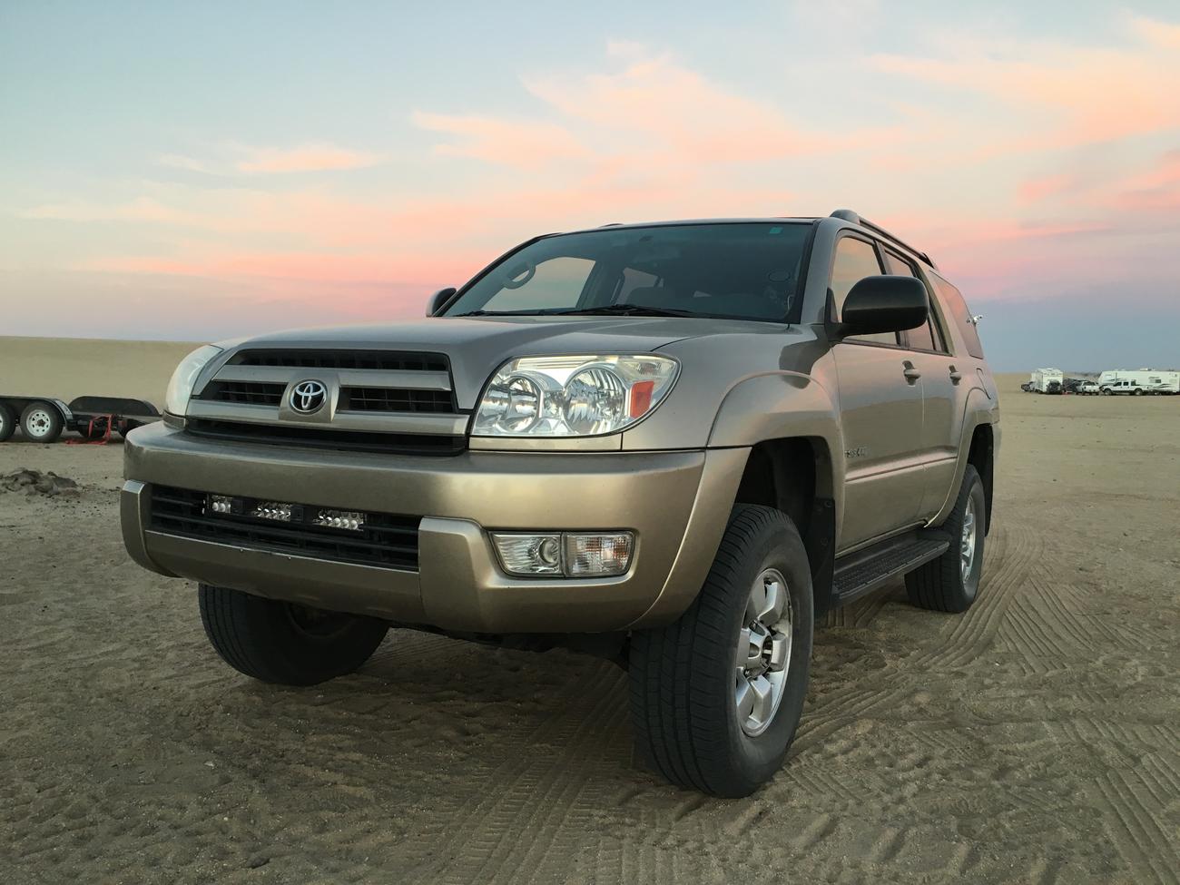

Bilstein 6112's Installed!
I'm curious, could you install the 6112's and 5100's and maintain stock height?
The mrs. is short and we have a new baby so she'd like the 4runner to stay stock for now. We'll lift it later.
My XREAS is going on 100000miles and I fear it's days are numbered...
Your rig looks great BTW.
It's a twin to mine although I see you have the limited rack and side steps. Better looking than the tubes to me...very nice.
Yes. You can maintain stock height. You'll probably gain an inch at the lowest setting from settling.
Agreed, thats why I swapped the tube steps. Their lines competed with the shape of the truck and left some awkward angles and gaps.
