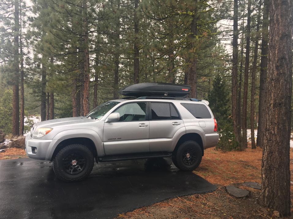

Here is a picture of the 4Runner from this weekend. Bistlein 6112 on the front with Wheeler T12 and Icon 2.0 on the rear. I'm going to give the T12's a month or so to settle but so far the rake is more than I would like.
Just as a comparison,
I used bilstein 6112's at middle notch with a 1/2" spacer on both sides up front.
And then 5160 + T12's + 1" spacer on back left for the driver side lean.
I ended up perfectly level front to back, which is too bad as I wanted some rake. I think I forogot to adjust for the V6 vs V8 when I added the spacers up front (I have a V6 4wd).
Oh, and with 255/75r17 load C KO2's and the 1,25" spidertrax I got some pretty good rubbing until the Caster was aligned properly (took 2 tries). Had to heat the front fender liners and push them in, and when I flex I'll still have rub.
This picture is BEFORE the Ko2's went on (stock duelers 265/65r17's)
It has settled a little more since the pic I think.
Here is a pic with the new tires for reference. It snowed about 30cm Christmas night - Santa was kind this year :)
