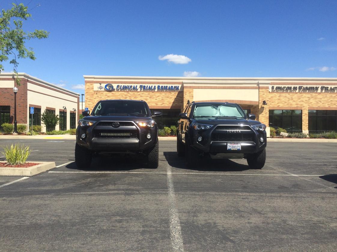

This spacer installs on top of the front coil assembly not in between the coil and top hat. I noticed no difference in ride quality from stock, just added height and ground clearance. Front drive line angles are almost flat, with added ground clearance. IMOP this is how the 4Runner should come from the factory. The rig now sits even with a bone stock TRD PRO.

My TRP next to a TRD PRO.
