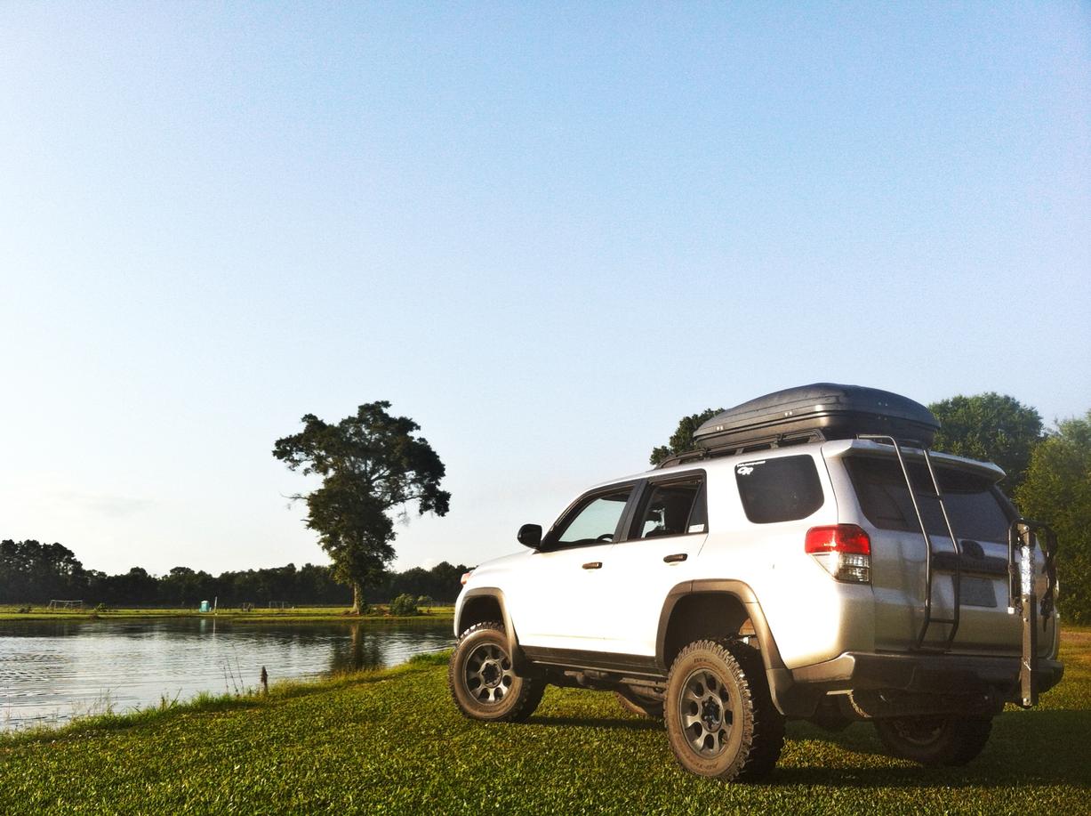

wasn't sure if you were asking me or Newf4R, but just in case you were talking to me....
285/70/17 Duratracs...to keep from double posting...you can find the most recent pics of my truck @
http://www.toyota-4runner.org/off-roading/143217-dc-va-md-wheeling-trips-14.html
http://www.toyota-4runner.org/5th-g...-5th-gen-toyota-4runner-off-road-pics-45.html
its pretty much the same pics in both spots.

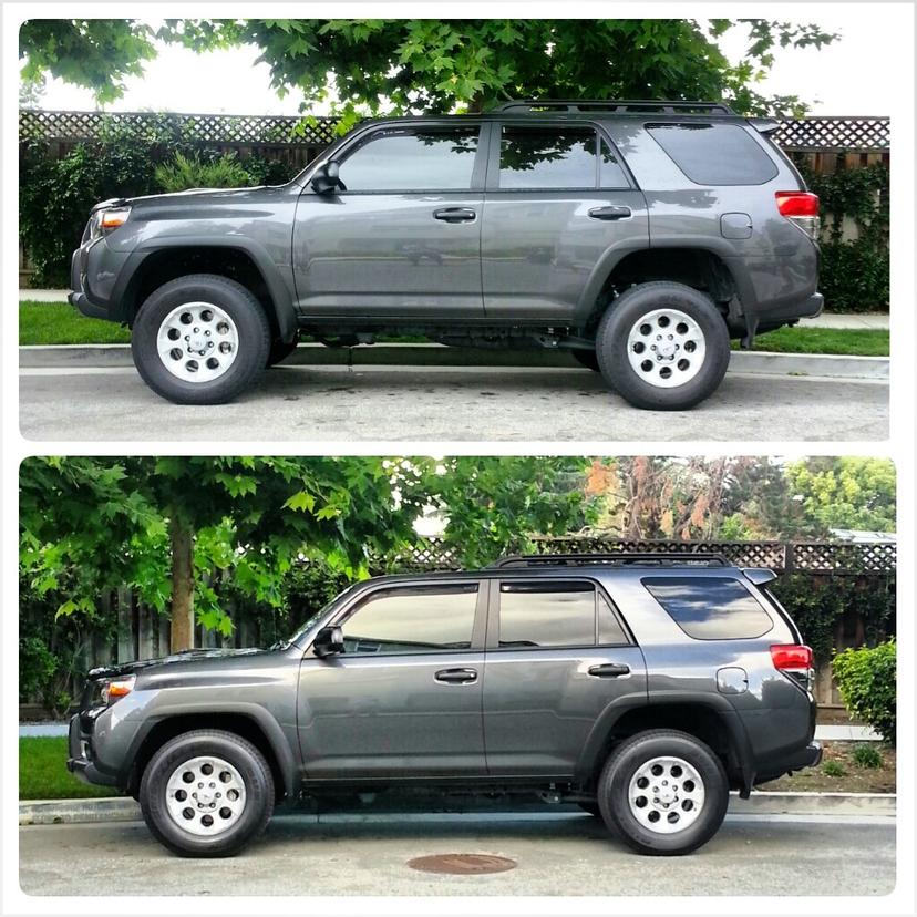

But to answer your question, here are a few members pics that helped me make my decision. Hope noones mad i'm re-posting these.
@SanhoTE
Front - Bilstein 5100 set at 2.5" w/ stock springs
Rear - 1.5" spacer w/ 5100 shocks & stock springs
@JohnnyA1103
Bilstein 5100 2.5 - Daystar 1.5 / Duratrac 265's
@J-BlickPhoto
OME 3 inch / BFG 265's

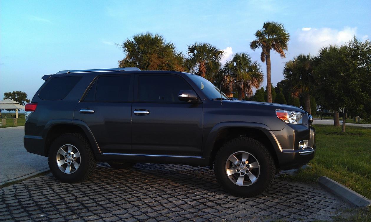

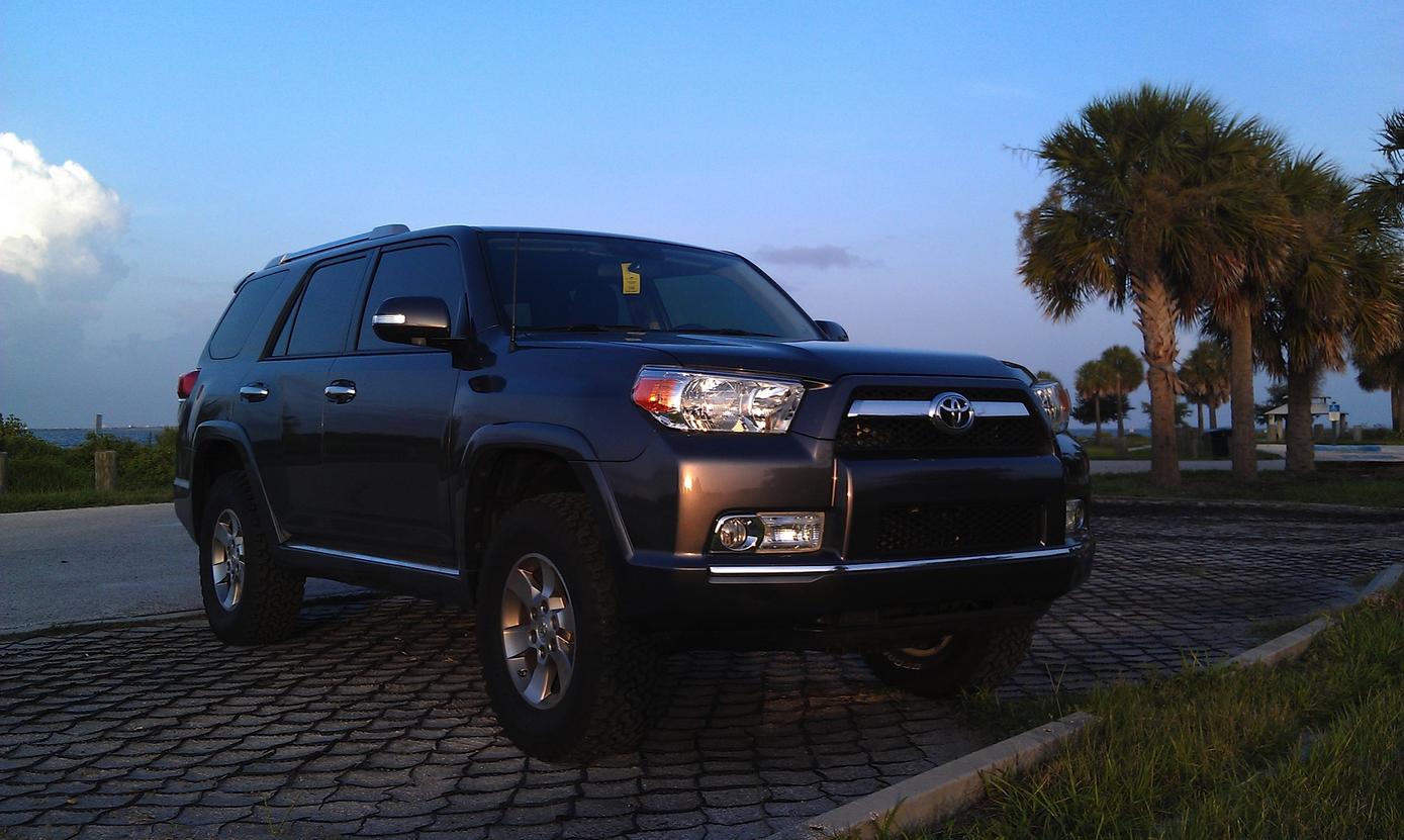

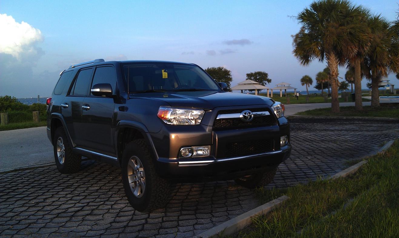

Just had Bilstein 5100s (x4) installed on my 2013 SR5 4WD. Fronts set to 1.75 with no rear coil spring spacer. I was looking for improved handling and a more level stance. Prior to the new shocks, the truck sat 2" lower in the front. New shocks set at 1.75 raised the front end almost exactly 2 inches so she sits nice and level now. The improved handling is tremendous, the BFG 275/70/17s look much more proportionate in the wheel wells and overall I am extremely happy with the results.

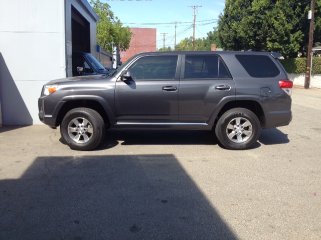

I decided to do the assembled and adjustable 5100's frpm ToyTec up front. In the rear I did Bilstein 5160's. I set the front to be level w/ the rear. The driver side lean at the rear of my 4R was pretty noticeable so I installed the OME 10mm spacer to correct it. Still trying to find an aftermarket wheel that I like. I will most likely stick w/ 265's
looks good man! I think it looks pretty damn level.... I think a 1" puck out back would be perfect

I am thinking about the same setup on my 2012 sr5 . 4 new 5100 on stock spring. My only question that holds me back is did you get negative rake with 1.75 and also did you do a diff drop and replaced your UCA. I am under the impression that 1.75 lift in the front will give you close 3 inches lift.
It sits level within 1/8" from front to back. No negative rake with full gas/passengers/some gear in back. I imagine there would be a little when towing. No new UCAs needed. Alignment got everything dialed in post install. Actaul lift was more like 2 inches. I could always put a 1" spacer in rear. I have been very happy with results/looks!
