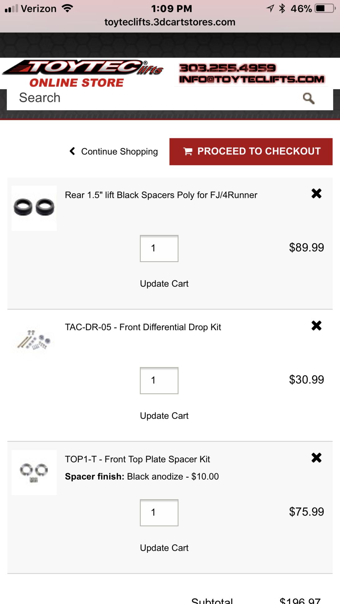

I bought the kit. So what I read it only lift the front to about 1” and it will look level. What I was planning to do is add spacer in the front and rear to get a higher rack. What do you guys think about these parts or daystar KT09134BK. I was looking for a 3” lift.
