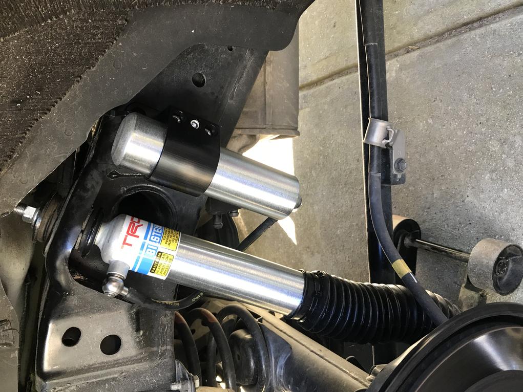

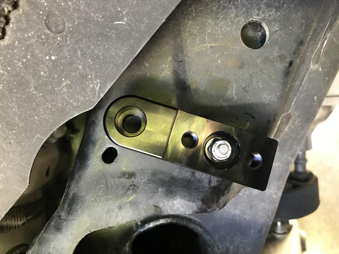

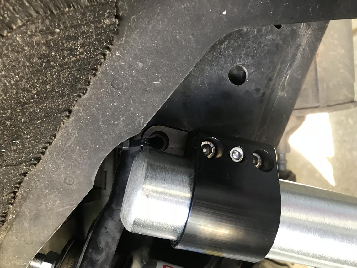

Might only be able to get the rear on today. I’m not sure exactly how to mount the resi holder other than the one angled bolt. Zip tie should hold until it can be figured out.
Edit: No idea why they are sideways. Every other forum I use has no issues with photos. They are automatically resized, correctly oriented etc.

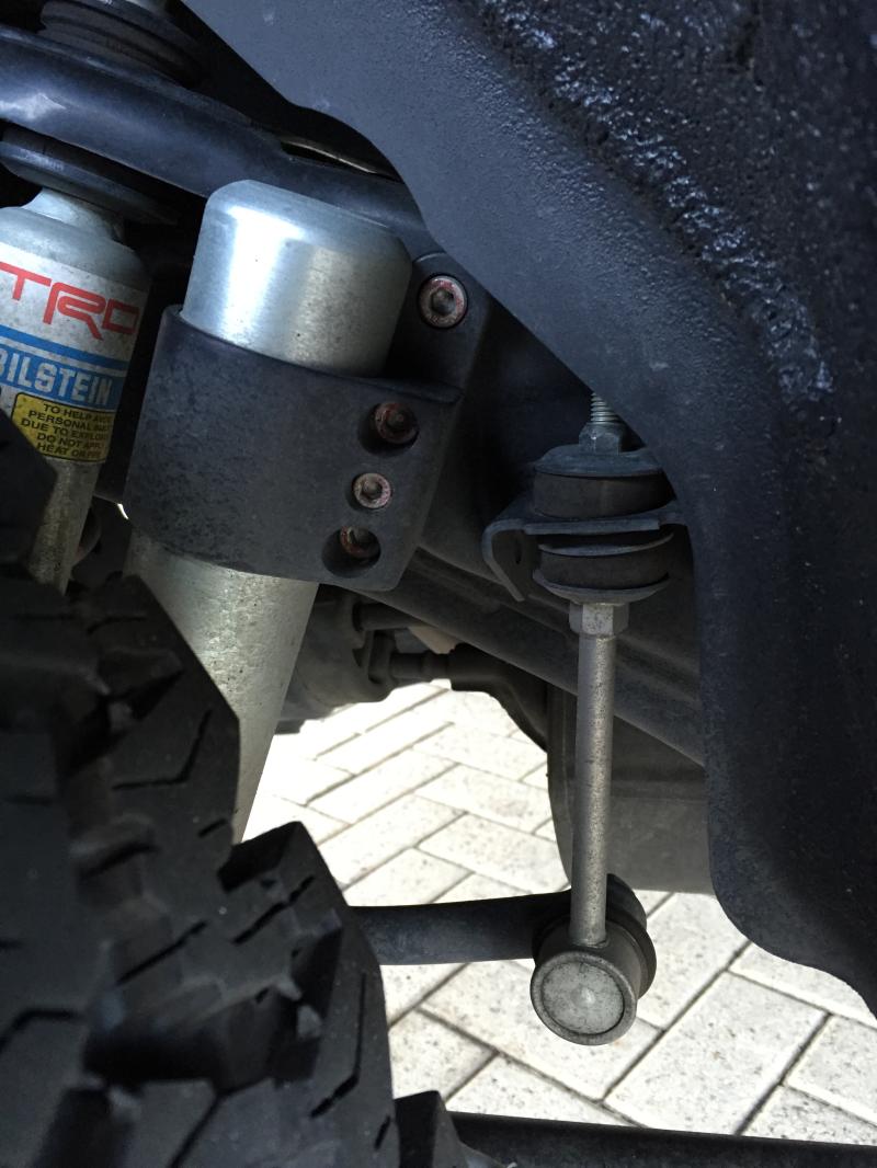

The frame has that threaded hole, does the top bolt just not thread into the frame to keep it mounted like in this pic? Taken from another thread of a Pro.

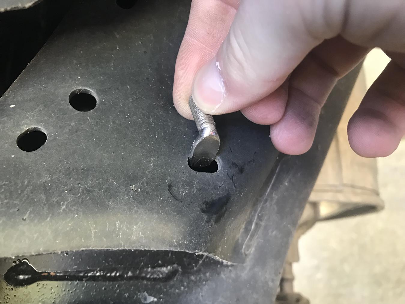

Mine doesn’t have a threaded hole. Gonna see if a blind nut or something will work. The bolt goes in but there is nothing to hold it.
I have KDSS. There was no thread on the upper hole for the rest mount. Had to improvise and use a river nut insert. Could be that they use a different frame for KDSS equipped. My buddy with SR5 had threads.

Yea, I've gotta go find some m8x1.25 rivets or something tomorrow.
Perfect!
So I wonder why mine doesn’t have that hole threaded? Wonder if it’s cause I have kdss?
Hmmm, that's a good question. I'll run out and take a look at my non-KDSS ORP.
Edit: OK, mine are definitely threaded. Are you sure you're looking in the right place? Just for kicks, I took a look at my wife's Limited and Toyota used that threaded hole for the X-REAS lines.
