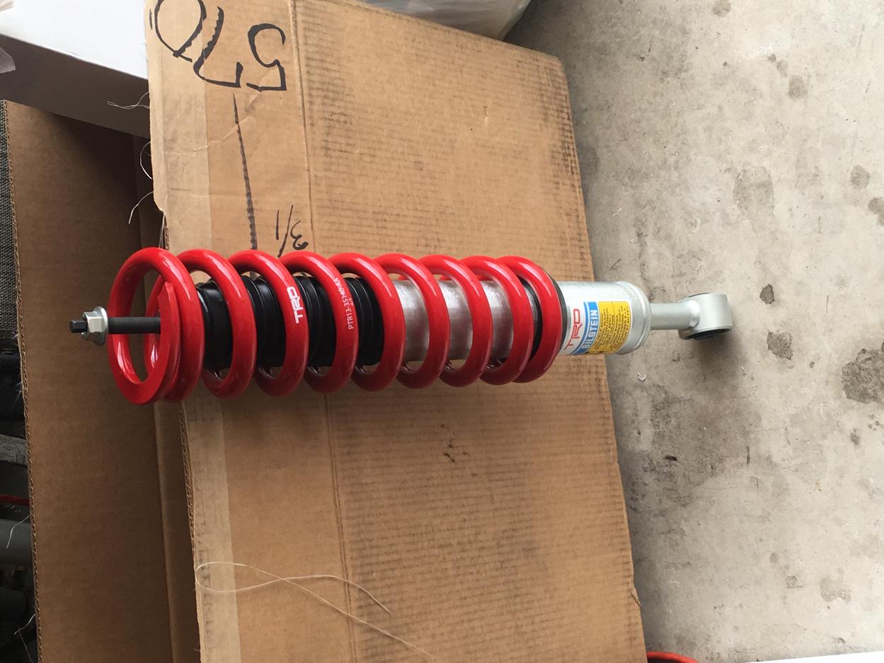

Mine came in on Thursday! When I go to put them on, since the front have 2 settings, do I put the drivers side on the higher setting and the passenger side on the lower to offset the lean? Just want to make sure I assemble them correctly so I don’t have to take it all apart and fix a mistake. I’m assuming both front shocks and coils are the exact same and not specific to a side? I didn’t see any markings when I took them out
Yes..... drivers side is upper clip (higher setting) passenger side lower clip to compensate for lean. Otherwise both fronts are identical. Post some pics and let us know your before and after center hub to fender measurements.

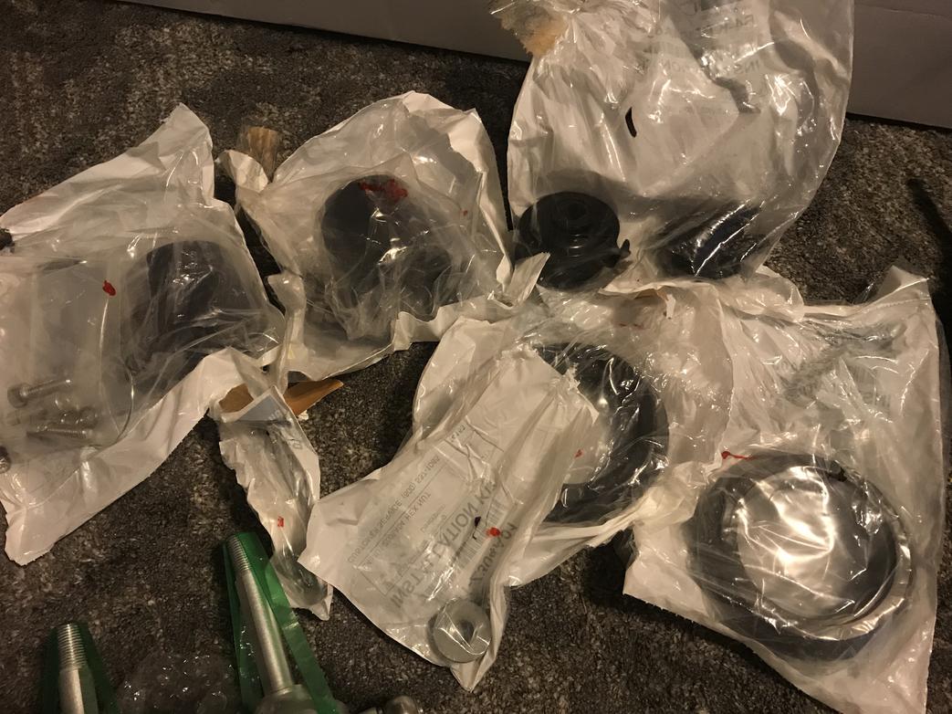

Curious to see if everyone else installing these will be re-using the top portion of the stock coil over or if they’re purchasing new hardware I’ll wait for install pics before attempting mine.
I ordered new top coilover plates from amazon for 21 bucks each. They were KYB. Not worth the hassle removing and reusing old stuff as well as old coil bushing/isolator. Go check amazon fellas

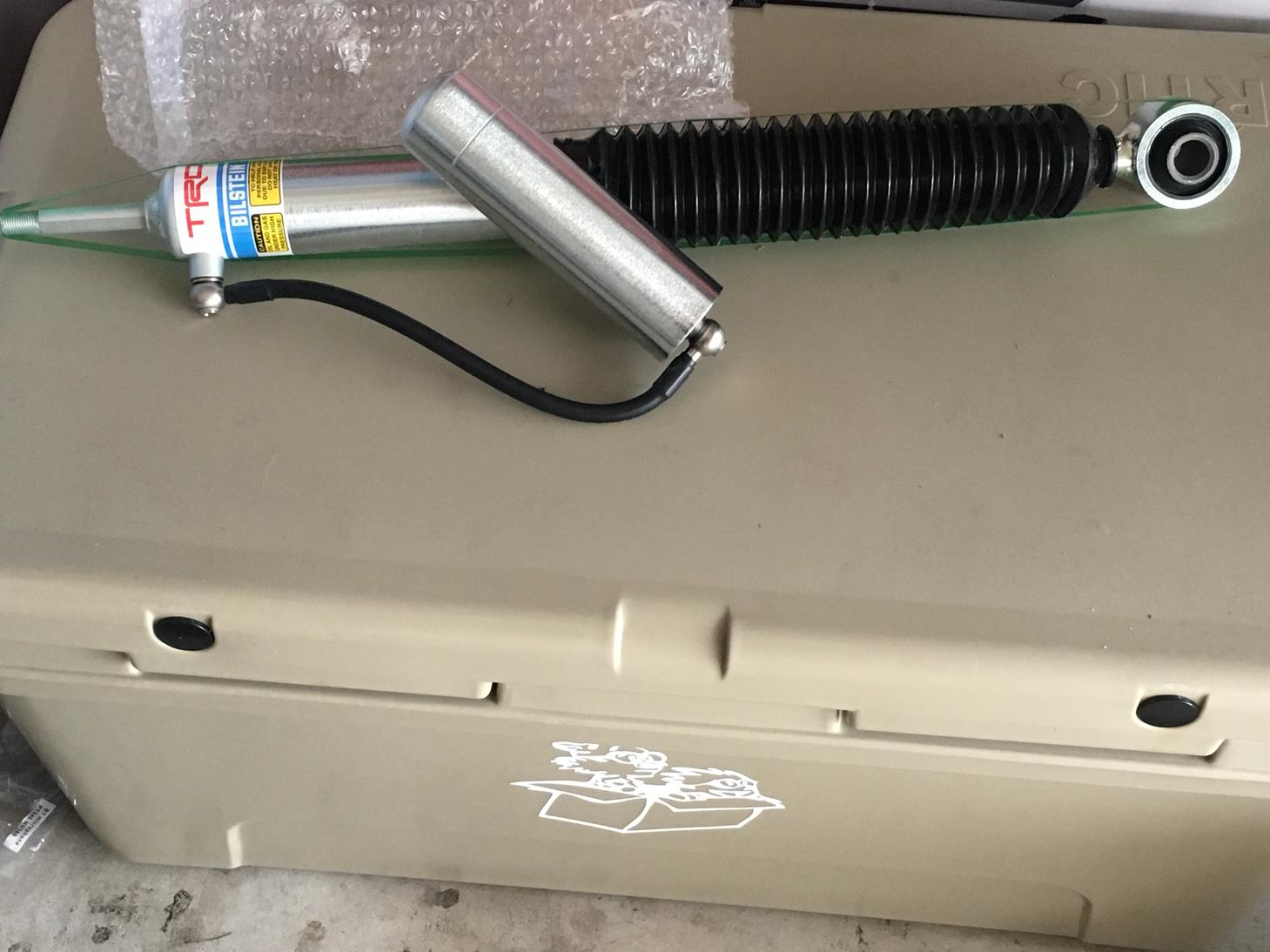

O!!! Received my kit!!! Damn it’s beautiful! I did have a issue tho. Received the box with damage. Also the box to the rear shocks in the box were damaged. Items looked ok. I did wanna take precaution so I called Olathe Toyota to make them aware because what if something starts leaking or whatever. They said they notated it and refunded my shipping costs because of the issue.
