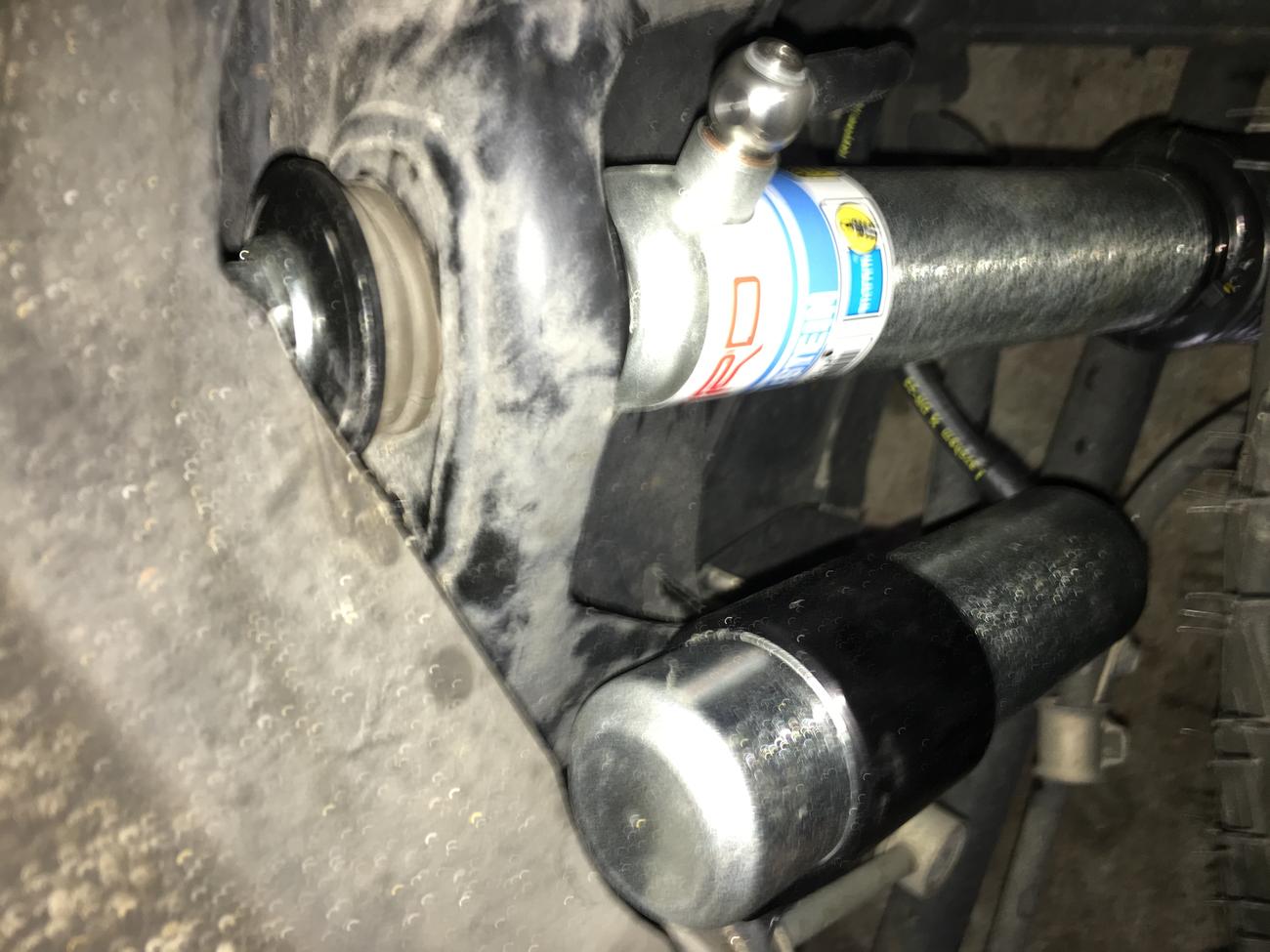

Installed today, no spring compressor method.
