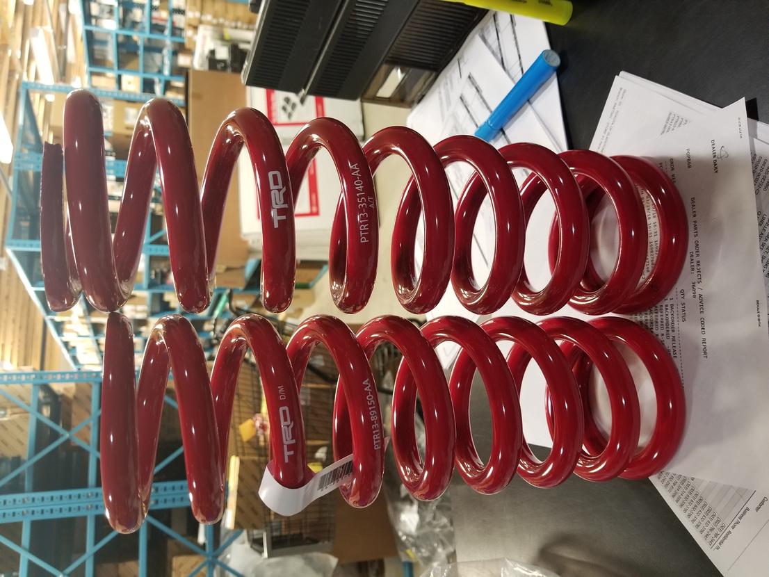

Spring comparison
So I have the Bilstein ptr13-35140 kit and bought a Toytec TRD PRO 2 inch lift. I'm trying to decide whether or not to replace the springs from a 4runner. I'm really confused. Here are the two springs side by side.
un14dtddz
So what trd springs are we looking at here?
3"x13" 550# (4Runner spec) and 3"x14" 600#(FJ/tacoma pro spec)
That's correct. Here's where I'm confused. If I add the Toytec Trd pro 2 lift to the 3x14 spring, will that cause a really stiff ride? Would it be better to use the smaller spring originally intended for the 4runner?
I used only half of Toytec 2” lift kit (ie only lower spring perch for 1”). I can compare my set up only to OEM due to my limited experience. I feel like the transition from OEM highway tires to BFG KO2 make my car slightly more stiffer than OEM suspension to the current TRD set up.
Also, you will lose ride height if you use 4runner’s 3x13 springs with FJ kot shocks. I think FJ kit’s spring perch location might be lower than 4runner’s kit to accomodate longer springs.
Thanks for your input. You bring up a very good point about the spring perch location. Once I have my stock shocks off I'll measure. The thought crossed my mind about using just the lower portion of the Toytec kit. I've got both sets of springs just in case.
This is kinda why I wanted new springs to pair with this kit. Ended up going with the TRD compatible Dobinson's 1" lift setup.
Please measure the spring length of Dobinsln’s 1” lift spring for 4runner TRD Pro and let us know. I feel like it will be about 13.5” in length which is right in between 4runner TRD kit and FJ TRD kit springs.
I'm a bit suspicious the FJ kit and the 4runner Pro kits may have different perch locations too based on the fact that the 4runner kit has both a lower spring rate and a shorter spring, yet both achieve 1" front lift over stock. I measured exactly 8.0" between the center of the lower shock bolt and the lowest snap ring groove on my FJ front shocks (ptr13-35140). Can someone with a TRD Pro or with the 4runner kit (ptr13-89160) take the same measurement? This may provide some insight into spring compatibility.
