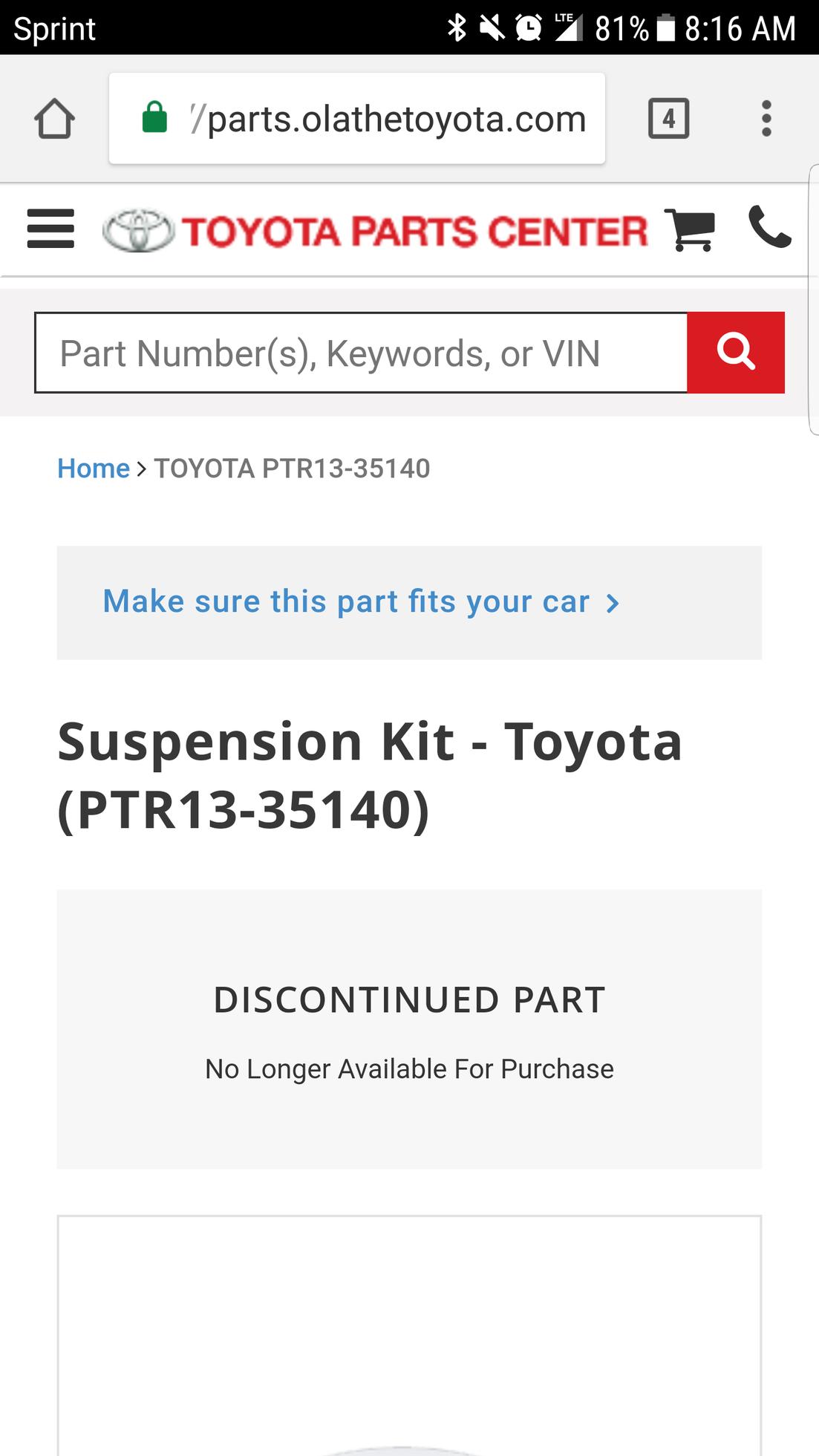

Quick online search... Sold out
Haven't had a chance to call this am. Wrapped up in meetings. But a quick online search via a link provided earlier in the thread turns up empty at Olathe. Assuming that's the case with all as they were ordering them in from a Toyota warehouse?
Annnnnnnnd there we have it, folks. Shoutout to [MENTION=165740]Kamalani Mahie[/MENTION] for confirming. TRD Bilstein FJ shock spring perch sits 1" lower than the 4Runner version. Does anyone think this will have an appreciable difference when it comes to performance?
