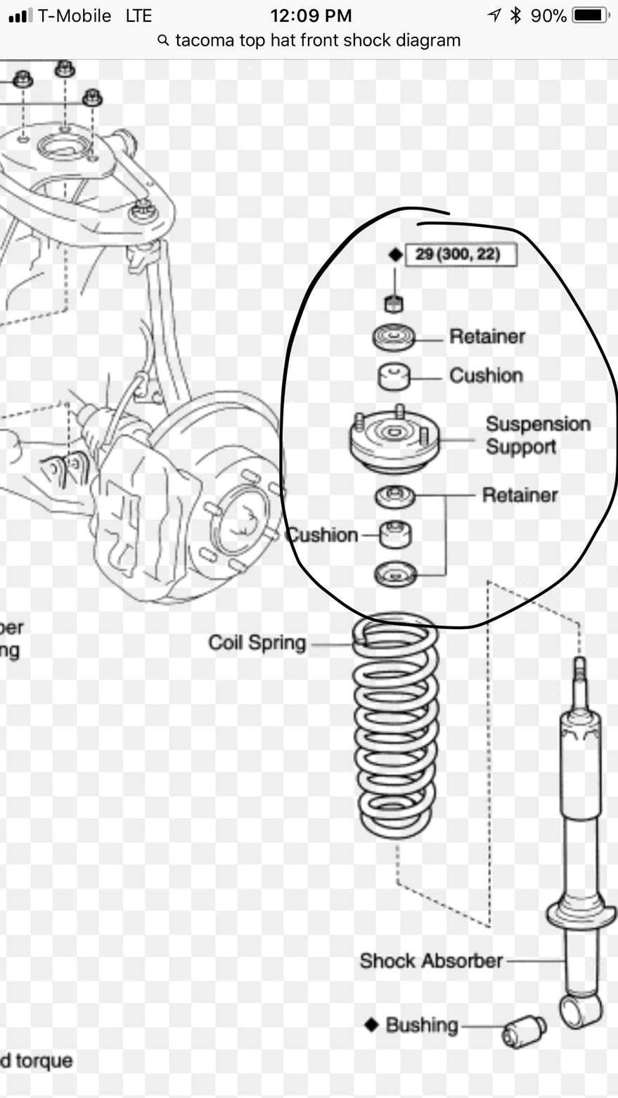

All the washers/retainers are there properly. It just seems like the shock is actually bigger than the space so the nut sits a bit higher than the top hat. Wanted to see if others put extra bushings or anything just to fill the gap.
That’s odd.... your 6112s /top hat should be assembled exactly like in this diagram. The retaining washers and cushions below and above the top hat should take up all the “gap” you have. The bottom retaining washers/cushions prevent the shock piston from going too high into the top hat. There is a raised “seat” on the piston that the bottom retaining washer sits on top of. The cushions will compress on both sides of the top hat as you tighten the top nut on the shock piston.

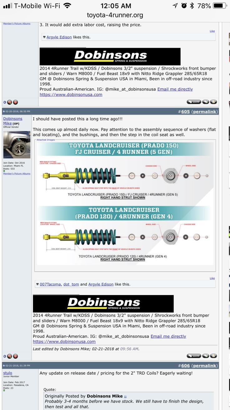

Can someone confirm for me/send me a pic, is there a rubber bushing attached to the top of the dust boot that ultimately sits against the washer and the bottom of the top hat.
THe bushing and washer either comes off your old shocks or you get a new set with the top hat. There’s a diagram a few pages back of how these need to be assembled and if you don’t install the bushing you get from the old shocks or with a kit it causes your issue.
I have looked at that diagram, but that’s from a taco. The 4Runner diagram is actually a bit different. My stock ORP setup did NOT have a rubber bushing under the top hat. Just one above, which is still being used. There was a metal retainer under the top hat that I have confirmed is being used still.
The Tacoma and T4R shock/top hat bushings/retainers assemble identically. Retainer-bushing-retainer under top hat...bushing-retainer on top of top hat. Exactly how I installed my 5100s on my T4R. FJ kit 6112s assembly should be identical.
Link to pic.....http://www.toyota-4runner.org/5th-g...unner-suspension-options-lots-choices-41.html
Here’s another link discussing bushing retainer placement...
http://www.toyota-4runner.org/3rd-g...u-shock-bushing-placement-not-like-stock.html
