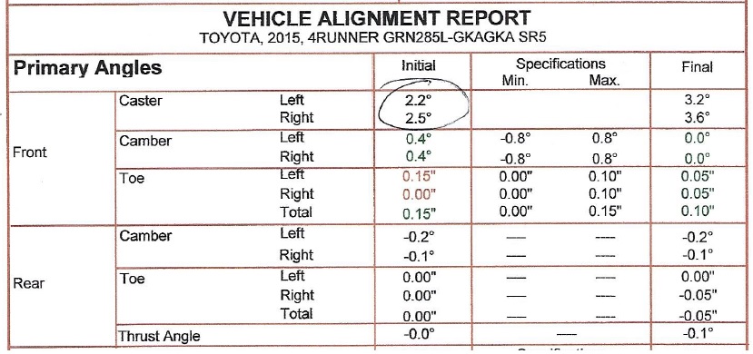

I agree. and for those on the fence about an alignment with only an inch of lift, do it. I thought my truck drove fine after the install but had an alignment done this morning and its much more confident now. More heft to the steering and it feels more stable at speed. I asked the guy at the shop and he said the added caster they got into it is what improved the feel. I am sure getting rid of the positive camber didn't hurt the steering feel either. Here are my post lift before and after numbers.
Also here are my pre and post lift heights in inches from the floor to center of the fender:
LF: 34 1/2 to 35 7/8
RF: 34 3/4 to 36
RR: 37 to 37 1/2
LR: 36 1/2 to 37
Torn on whether to bother with a trim packer for the left rear seeing the 1/2" variation was there from the factory.
Also, as a weird benefit of the suspension, I don't seem to have as much vibration at 60 mph as I used to. same wheels went back on the same hubs so its not wheel balance. We'll see how this goes over time but I'll take it if its permanent.

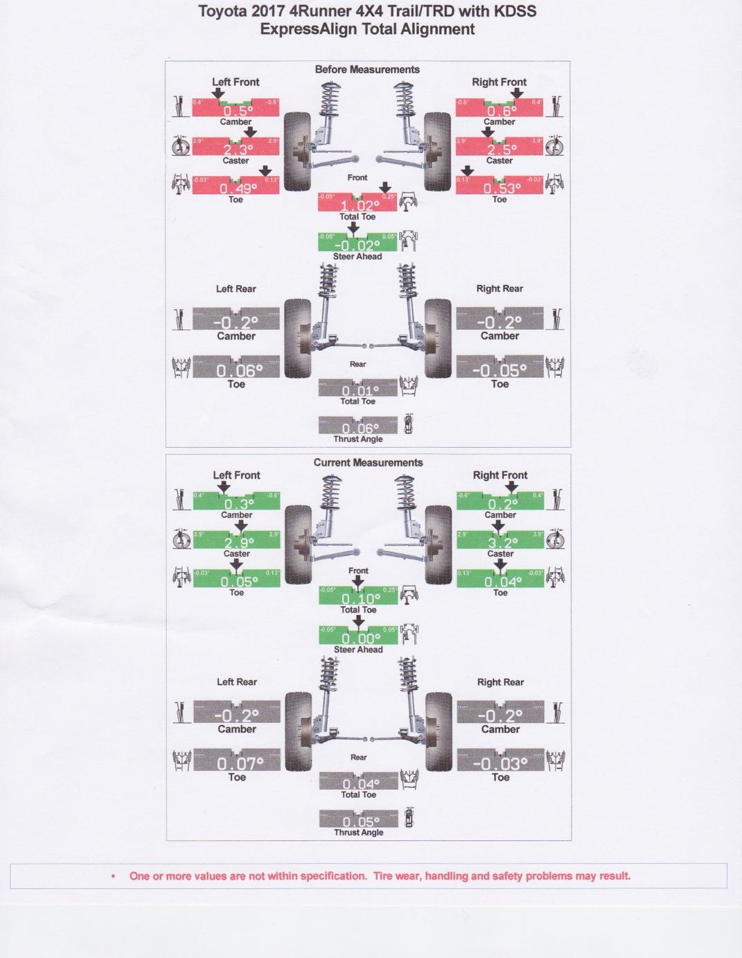

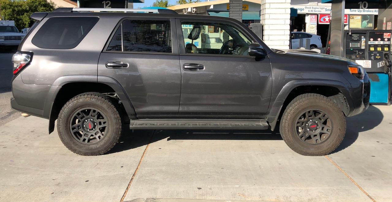

Here's a pic of my KDSS equipped TRD Off Road after install and alignment. I'm getting a little bit of vibration through the steering wheel at about 60 mph. Not sure what that's about?
