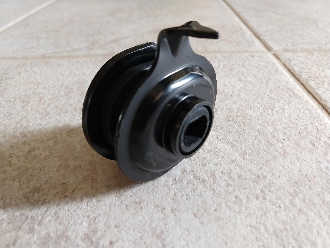

I Just received the suspension kit and would like to know what this part is for. It is a Bilstein Upper Stem Mount. I have not seen this part in any other images in this thread. Thanks.
