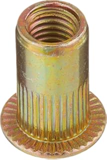

Could you post the type of rivnut you used? I grabbed one from ACE hardware that looks like the picture below but it wouldn't fully go through the hole in the frame. Do people drill through the back side of the frame as well?

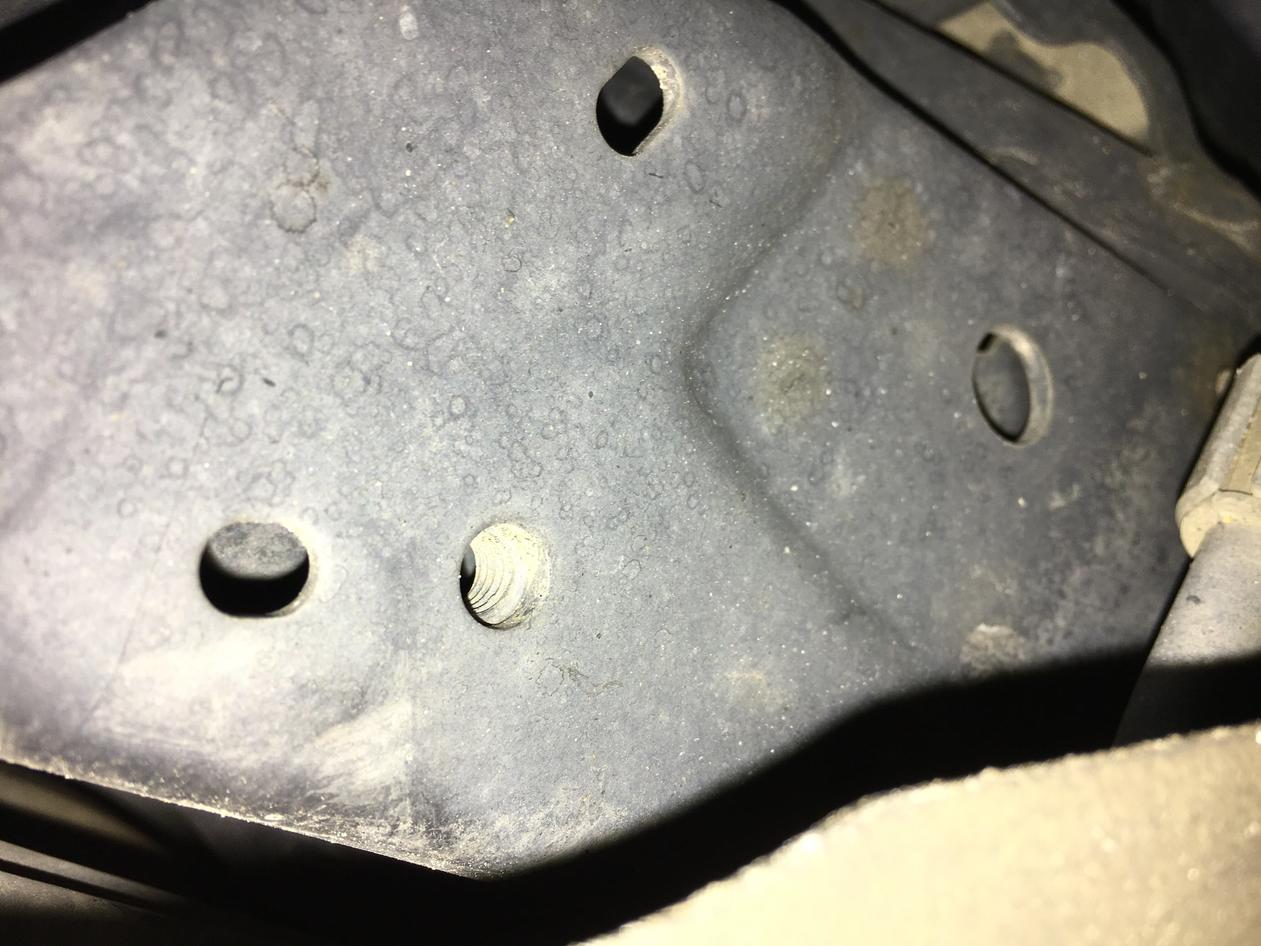

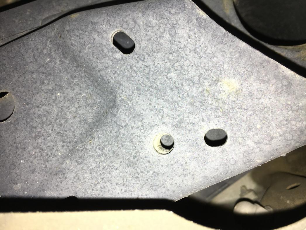

Only one side of the frame is drilled.
See post #230 and #713
Which years KDSS don’t have the threads? My 2010 has threads.
