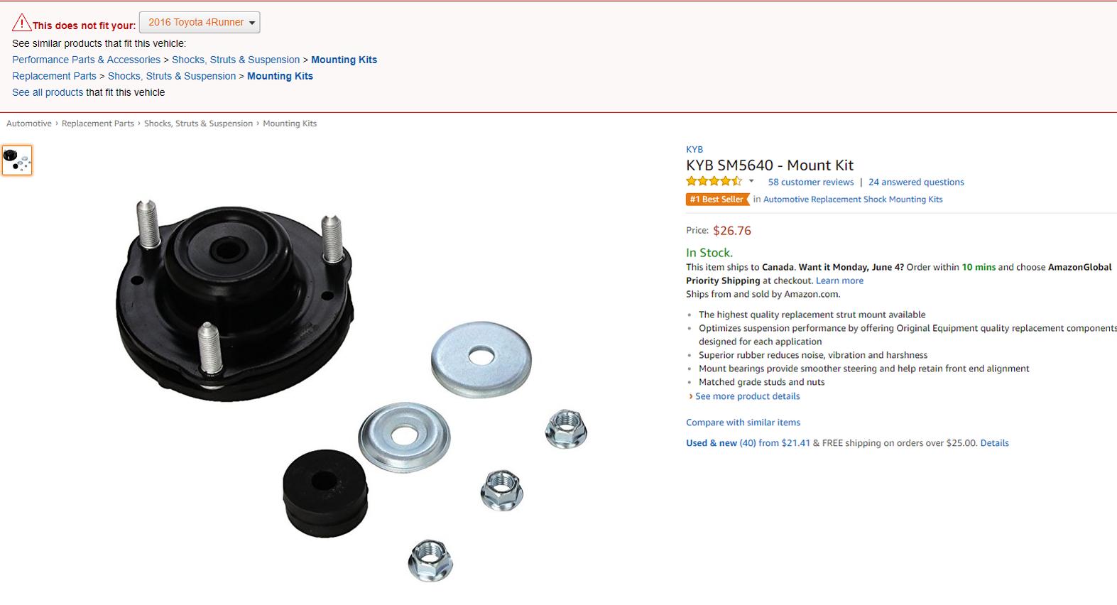

Last piece of the puzzle. I'd like to prebuild the coil overs for my 2016 SR5. Guys on here are recommending the KYB SM5640 on Amazon.
https://www.amazon.com/KYB-SM5640-Mount-Kit/dp/B00C7S0KA8/ref=cm_cr_arp_d_pdt_img_top?ie=UTF8
The fit guide says it is only good to 2014. I assume this is an error but wanted to check to see if there was a change for 2015+
Cheers,
Jon
:attention:Just remember that these are not sold as pairs, so you'll need to pickup two.
Cheers,
Jon
Don't forget to order them off amazon.ca not amazon.com, and yes they fit, just put these on my 2018.
