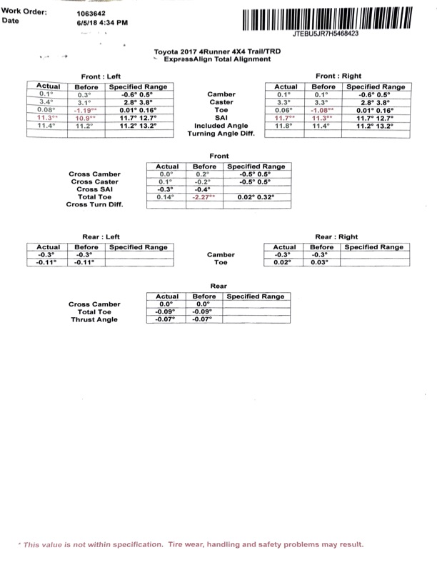

Will do. I'm going to try to get it aligned next weekend so hopefully they can get everything to spec.
Did you get your truck aligned? Did it align into factory specs? I ended up buying the same setup as you, the front Toytec 1" spring perch and Wheelers T-13 rear springs.
Here's the alignment sheet. They were able to get everything to spec except the SAI. It's just slightly out of spec and the guy that did the alignment didn't think I should worry about it but that new UCAs would probably help.
I don't know much about alignments, but after reading some stuff on the forum it sounds like SAI isn't adjustable and that sometimes it's out of spec when there's a bent or damaged part. Can anyone chime in as to whether UCAs would help this or if I damaged something during instal?
