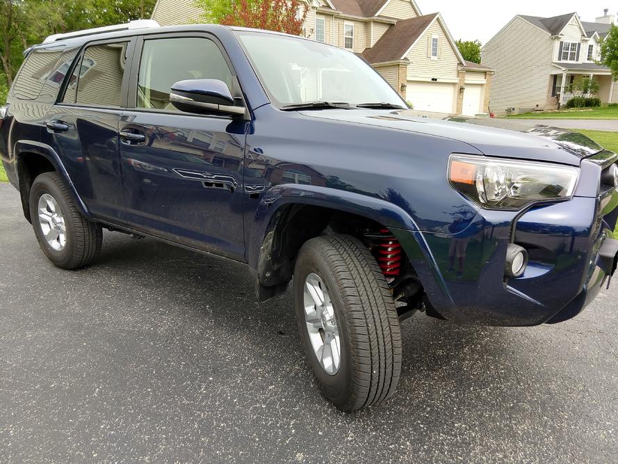

Just finished and this is the first mod on my 2018 SR5. Thanks for a great 4Runner community.
