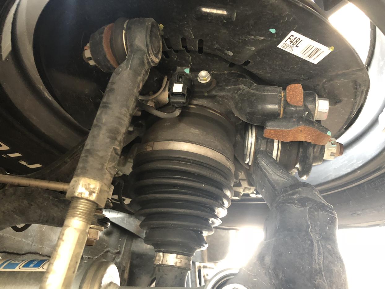

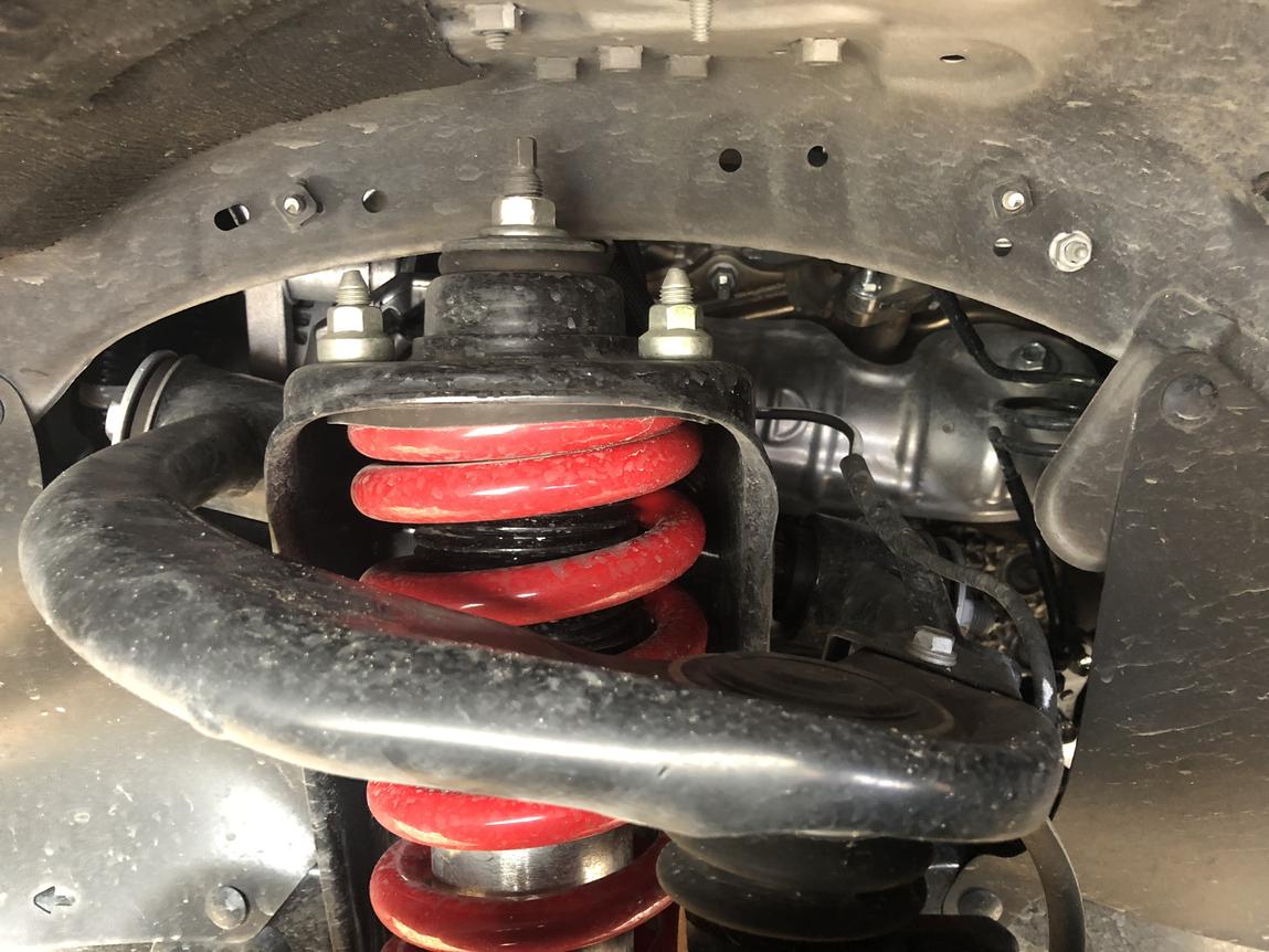

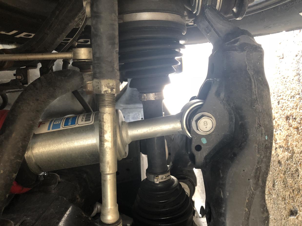

These are some pics, maybe someone can spot something.

Re check torque on everything, especially on the two lower ball joint bolts, if those are loose you will hear noises when turing or hitting bumps since the whole thing will be shifting.
Also, lift the front end up and start to wiggle each wheel hard in each direction, that will let you hear whats causing it better.
Good luck!
