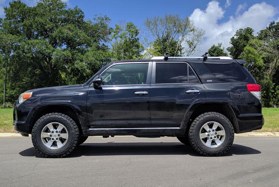

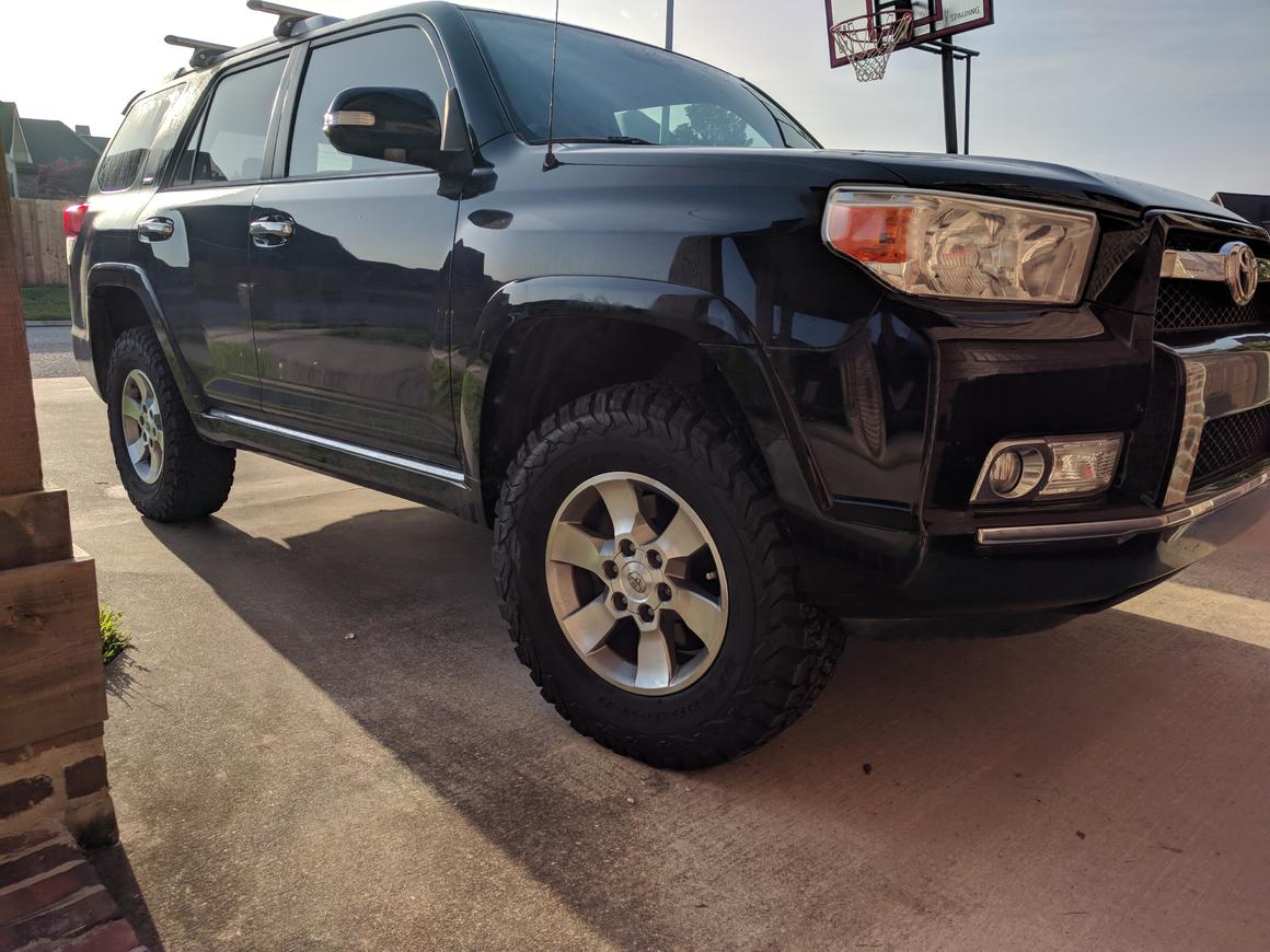

Quick before/after pics + measurements from hub to fender (not perfectly level driveway)
Front: 21.5
Rear: 22.5
Completely forgot to measure before. :(
FJ TRD Kit + 10mm ome spacer on both rear coils.

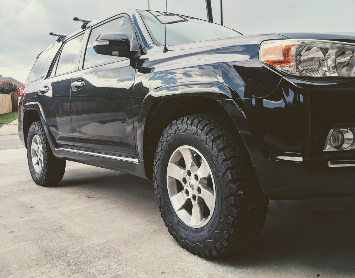

Very happy with the result. Mild lift overall and reduced the front rake while still retaining some. On road it feels GREAT. Side body roll is hardly there any more... cornering feels amazing now. Still feel a little nose dive while braking but it is greatly reduced. It feels like more of a controlled ride overall, for example going over speed bumps it used to bounce a little after and feels much better now, like it settles down quicker. Smaller bumps feel more firm but I think that could partially be due to the KO2s which I got recently as well.
