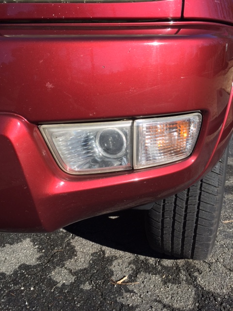

Hey everyone,
I've done the black headlight mod with my 05 4th Gen, I was just wondering how to do the fog lights and possibly the turn signals. I'd appreciate the help. Here's a picture of my fog light/turn signal.

I've been looking to do the same thing. I believe [MENTION=87178]NuclearN8[/MENTION] took his apart to add halos, so he may have some details on the process.
I wouldn't think you'd want to do the directional as it's probably all reflector inside & would make the light pretty ineffective.
I had a set of fogs I was going to do this with, for whatever reason i found them harder to bake apart than the headlights. But it was doable. They were in the oven longer.
the 05 halogen fogs can be done the same way. I had them apart to add halos but didn't black them out... good luck.
