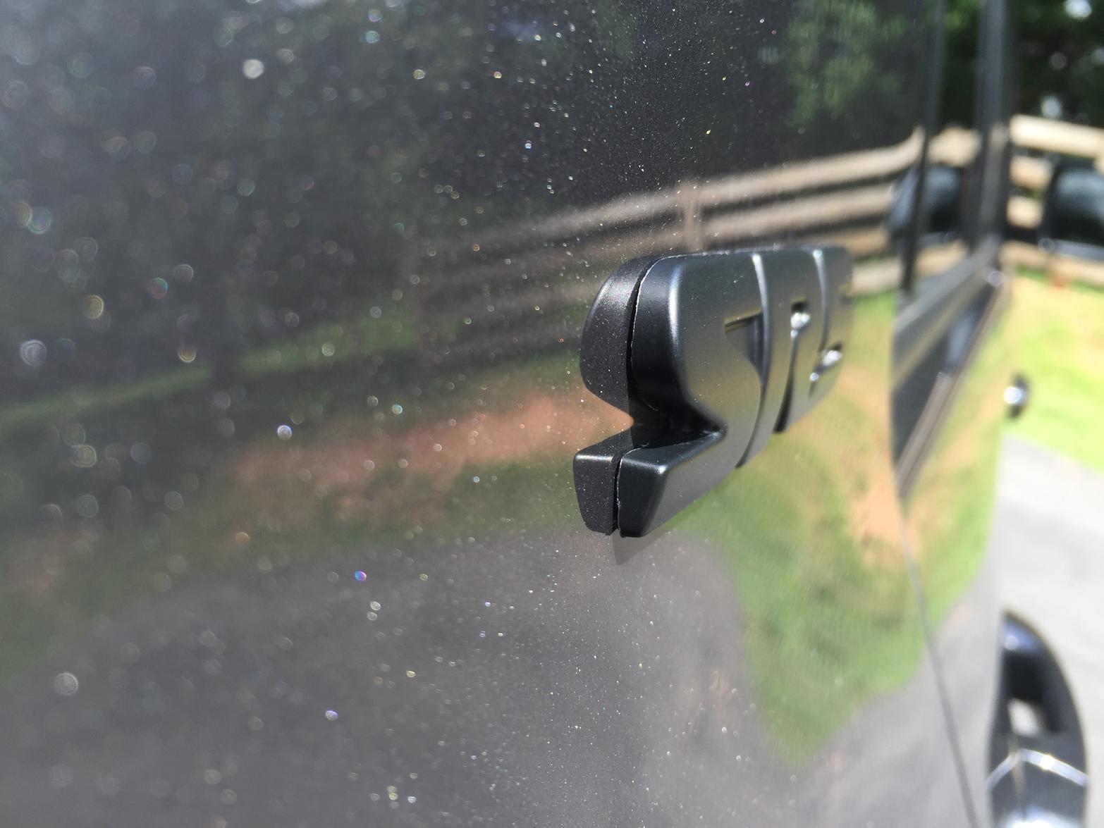

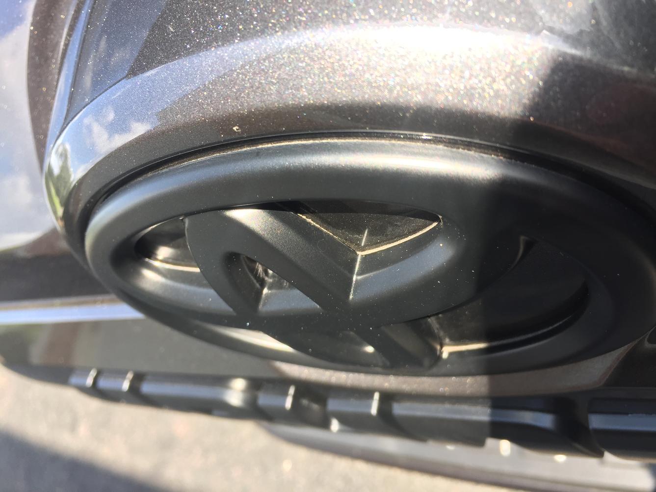

I had my doubts about sticking an overlay on the trim, regardless of what adhesive it came with. On prior cars I've gone through the arduous process of taping/debadging/rebadging post-dip-or-paint - a true pain in the ass - and it was something I desperately wanted to avoid with the new car. That being said, of course, $90 isn't the cheapest option either. But I did it anyway. Vendor got the package to me two days before it was expected, so it was quite a welcome surprise. They got in last night and just before dusk, I grabbed a bottle of CVS 70% ethyl alcohol, latex gloves, and a microfibre towel.
Literally, its as easy as:
- Clean the trim
- Let the residual alcohol evaporate
- Peel the red tabs off (see pictures of trim earlier in the thread) and apply.
- Bask in the glory of a tremendously simple "mod."
I had my doubts about the strength of the tape; when you look at it after removing the red tabs, it looks quite shoddy. So about two hours ago I went to the carwash down the street (Three Cees in Herndon for any NoVA T4Rs!) and figured that if the trim could withstand a notoriously "thorough" wash, then they were well-worth the purchase. Much to my surprise, they stayed on - not one bit of "peeling" or "give."
Note:

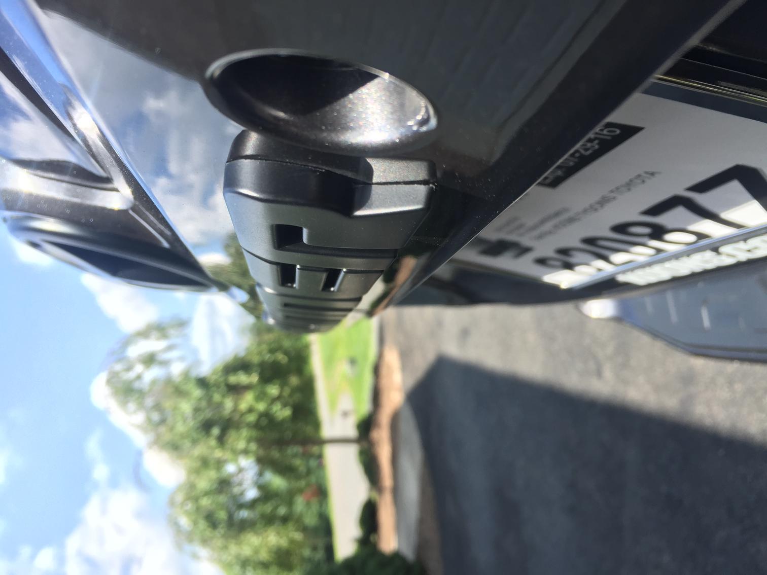

- Remember that because its an overlay you're going to have a VERY small amount of "hang," where the overlay does not lie plush with the car; this is an "issue" only with the individual letters as the Toyota emblems are more "sunken-in." I have yet to see any chrome trim peeping out from beneath. See pictures attached.
Bottom line:
- I couldn't be happier with the overlays.
- Easy installation - very, very, very easy installation
- Parts are OEM, so you get an OEM look - simple.
- Do it.

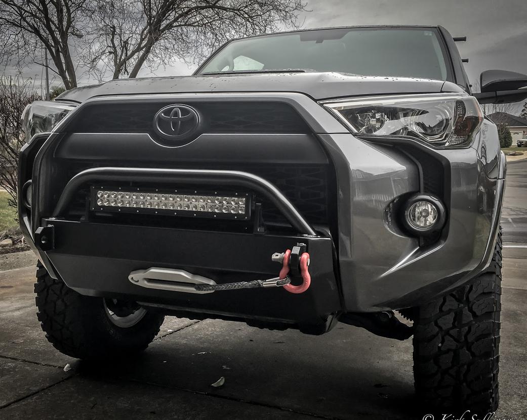

I went nuts with Black out
So as for my blacking out of the shiny bits this week, my choice was 80 grit automotive sandpaper, blue tape and masking roller, drop cloths and 9 cans of Rustoleum Bedliner. So far I'm very happy with the results. I had previously put this material on the nose and leading edge of hood but hadn't been aggressive with the sanding so it lifted. I also use the professional cans vs the standard and it's way to thick and very inconsistent, the regular self levels much better. You must use at minimum 3 coats to areas you expect rocks, or bushes or shopping carts to bang it. Lightning sucks in this pic which is not the full Monty, more to follow as we head off on our road trip.
2scHMnTfJo3CVRSM9

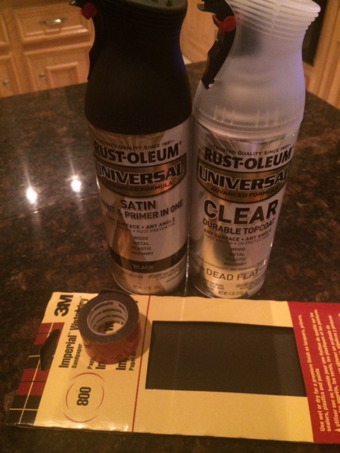

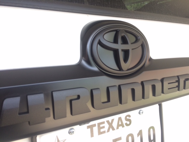

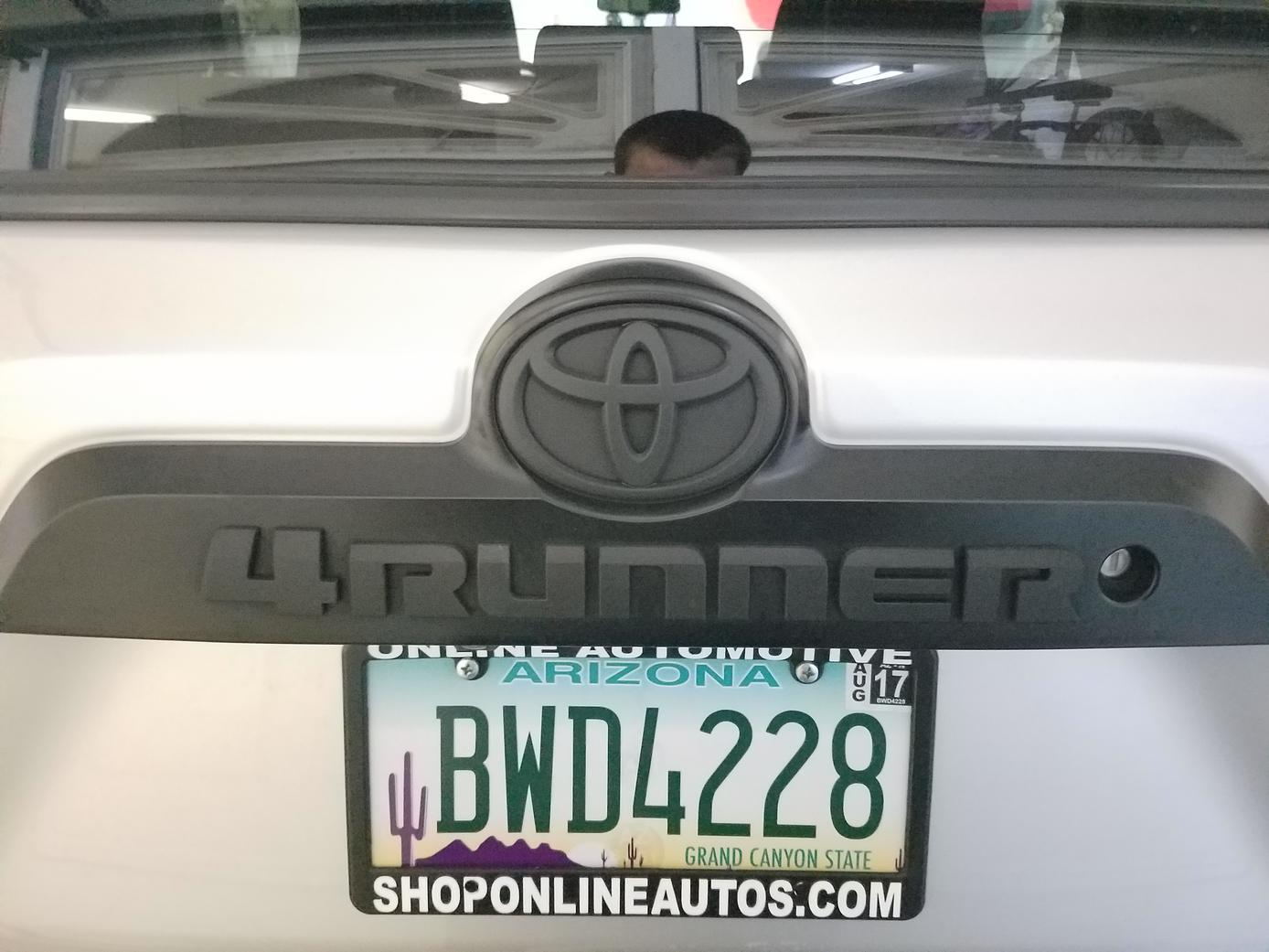

Good Ol' Paint

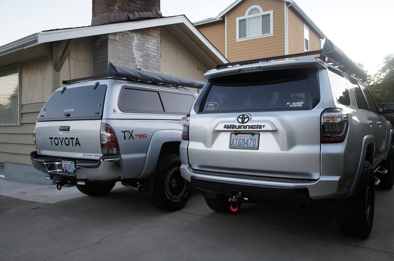

So aside from the roof rails (which I painted matte black a while back) the only chrome bits on my TRD Pro were the rear emblem & lettering. It really did start to drive me crazy that these weren't blacked out form the factory (not so much as the roof rails did though)....so I had to scratch them off the list. Thanks to all those on this forum that provided insight on the removal process.
Not a fan of plasti-dip...and I certainly didn't want to bend over for the overlay kit, so I just went the spray-paint route. I've found many times that with good materials, proper preparation and patience, you will yield good results. I spent $28 on a can of Rustoleum Satin Black Paint/Primer, a can of Rustoleum Flat Clear Topcoat, 1" 3M double sided tape, and 800 grit sandpaper.
My process:
First - tape off the lettering on top/bottom and wherever else might be helpful. I also took a thin sharpie and marked where the edge of each letter was (on the tape) to ensure proper realignment. I used fishing line to remove the emblems. Really not difficult at all. My only tip here is to wear gloves, and be careful when removing the large Toyota emblem, as there are two dowel pins that locate the piece that are easily broken off. The letters don't have these, so no worries there. I then removed as much of the old adhesive off the back of the letters as possible, and applied the new double sided tape. Tip - use a break-away blade so you can keep a sharp tip, and cut inward, at an angle so nothing will show around the edges. After wetsanding (lightly) all the pieces, I applied 6 light coats of the black (5 minutes in between each coat), and then 2 coats of the clear. I set them up on small spacers (used for tiling) to make sure they didn't get stuck and to ensure 100% coverage. I found it easiest to peal/roll the old residue off the rear garnish while it was cold (not heated up), and used Goo-Be-Gone to finish it off (no discoloring, which I was slightly worried about). Easy Peasy. Great Results.
