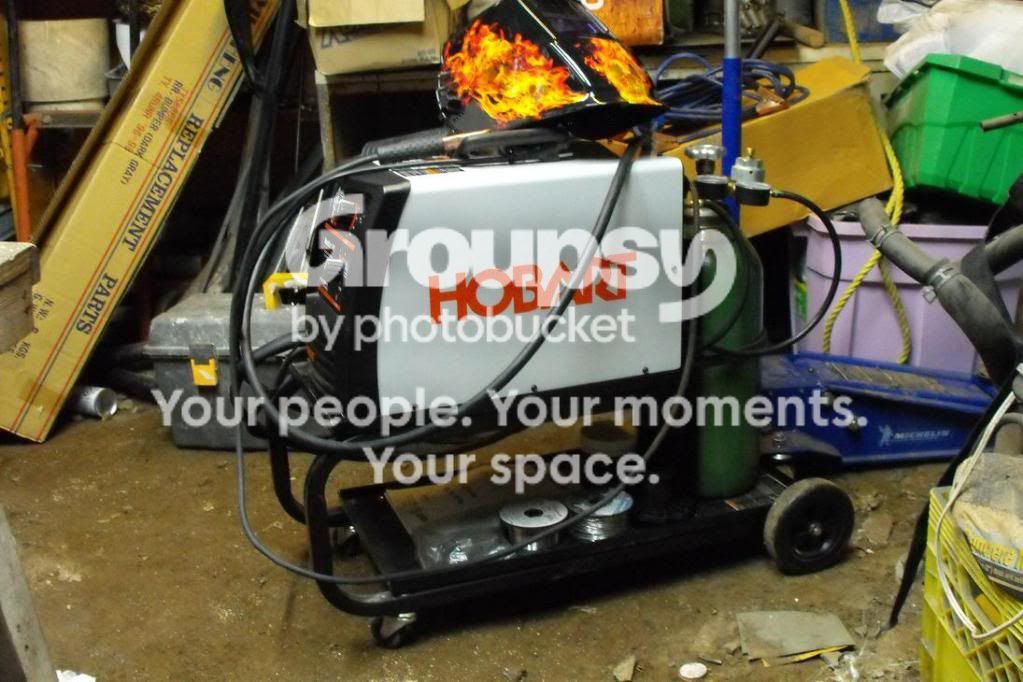

This are the newest addition by the way...Hobart Handler 140 and Lincoln Electric auto darkening helmet. I just got the welder just over a month ago but with the cold weather, I haven't really had the chance to fiddle with it that much..well except that one time I used it for the 1st Gen roll bars modified front legs and base. What a step up from the last flux core welder I used for my ARB, the rear bumper mod and my tire carrier...that's for sure.

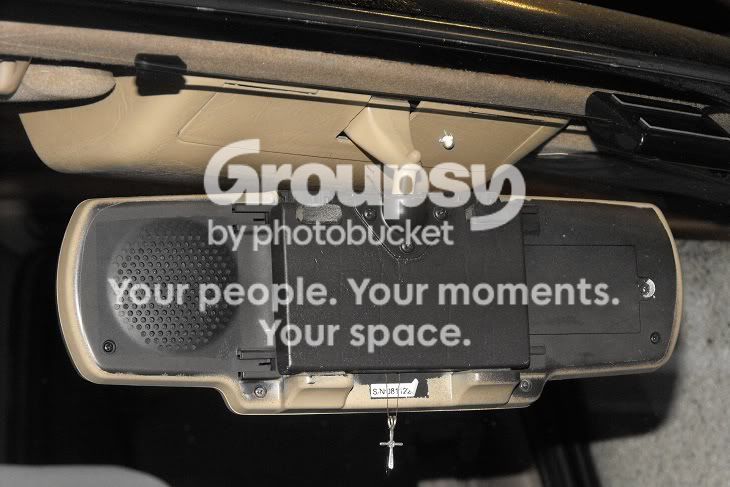

man..just went through the build thread again.. this thing rocks..also..your rear view mirror..is that an upgrade? looks like something from a newer car put in
Had you with the bluetooth huh?..well almost!
i bought the handsfree from Canadian Tire when the law was passed...oh 2 years ago. It only came in black and i wanted to integrate it better with the interior color as well as the color of the FMU, so I painted it too.

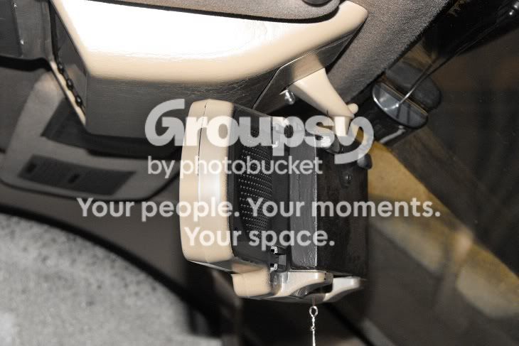

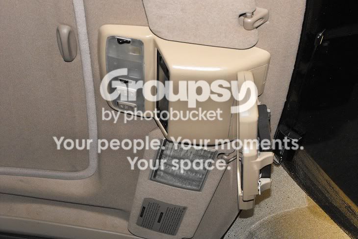

Originally, they clip onto the stock rear view mirror but why put a mirror on a mirror I thought. So I dismantled the original one and retain the articulating ball mechanism, re-used it and mounted it on a UHMW plastic block I found laying around which I also modified and shaped to fit the Bluetooth device to.
This handsfree is amazing in that since I bought it Christmas 2009, i only chraged it once then and never again...well not yet. It's made by Yada by the way.
This one didn't make it to the build and I didn't go into it with much detail, I figured it's such a trivial matter and no one would notice,lol....but you did so,

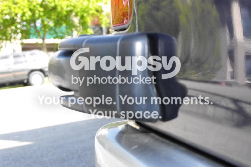

Outside view
1-18.jpg~original
New UHMF block mount w/ arm & articulating ball from stock mirror
2-11.jpg~original
4-14.jpg~original
Profile
5-9.jpg~original

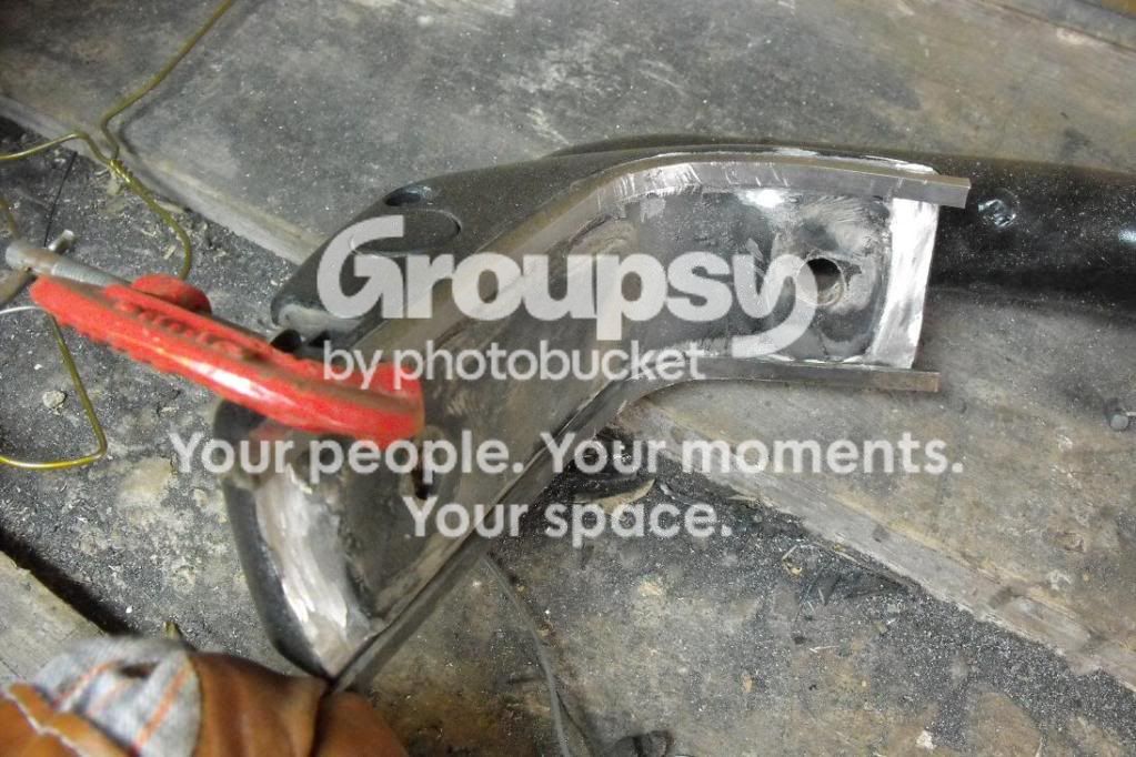

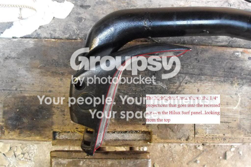

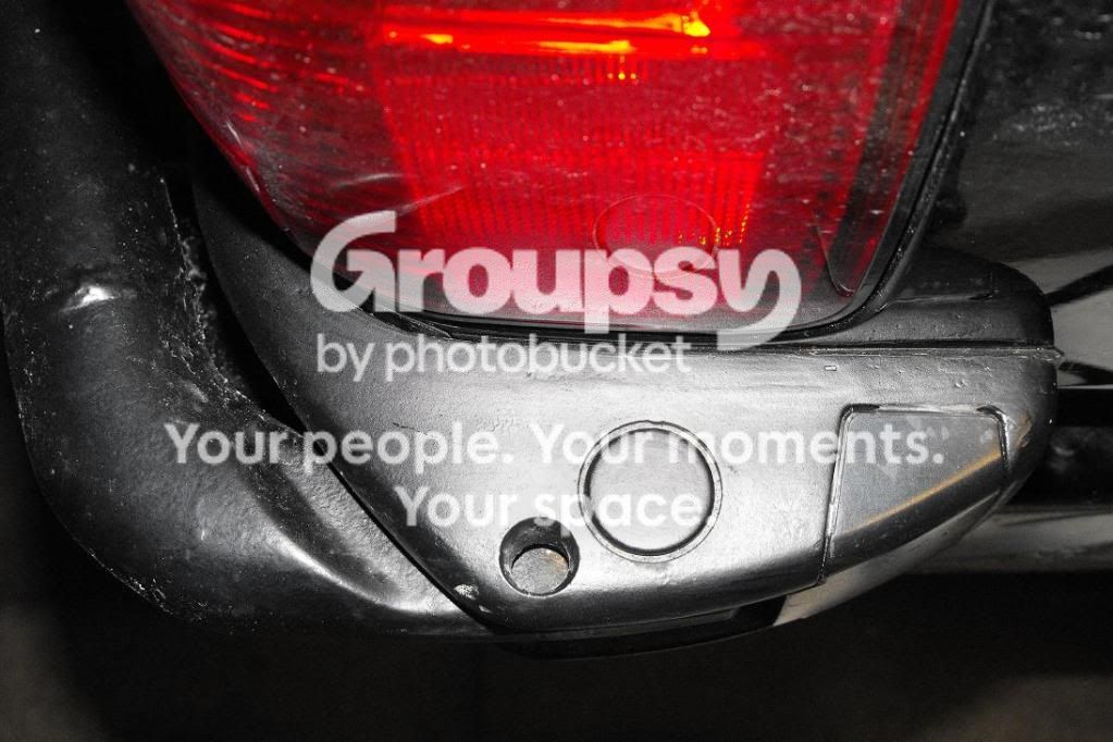

This is a shot of the lower hinge mount of the carrier that needed some modifying. See the projected areas on the middle? Without filling around the edges you will see a 1/4" gap when mounted on the body panel of the 4Runner.
4-13.jpg~original
5-1-1.jpg~original

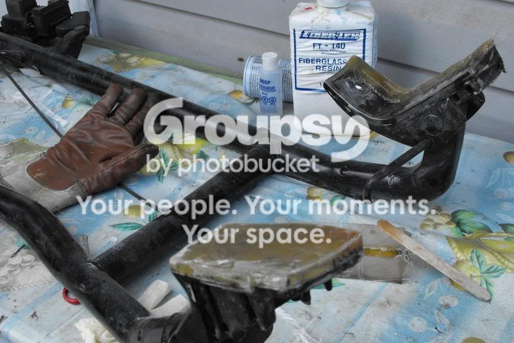

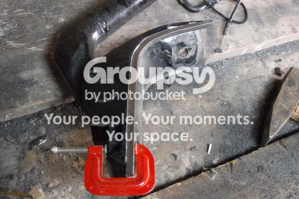

Now there are two ways to get this done. One is to weld a 1/4" metal rod around the hinge mount and level it flush with the projected area, or fill the surrounding area with fiberglass. If you're not that concerned about the way it would look with the 1/4" gap on the lower mount, then obviously this is a non-necessary step to bother with.
When I first did mine, I used the fiberglass method since I didn't have a welder then..and I wanted a more factory finish so I went ahead and did it.

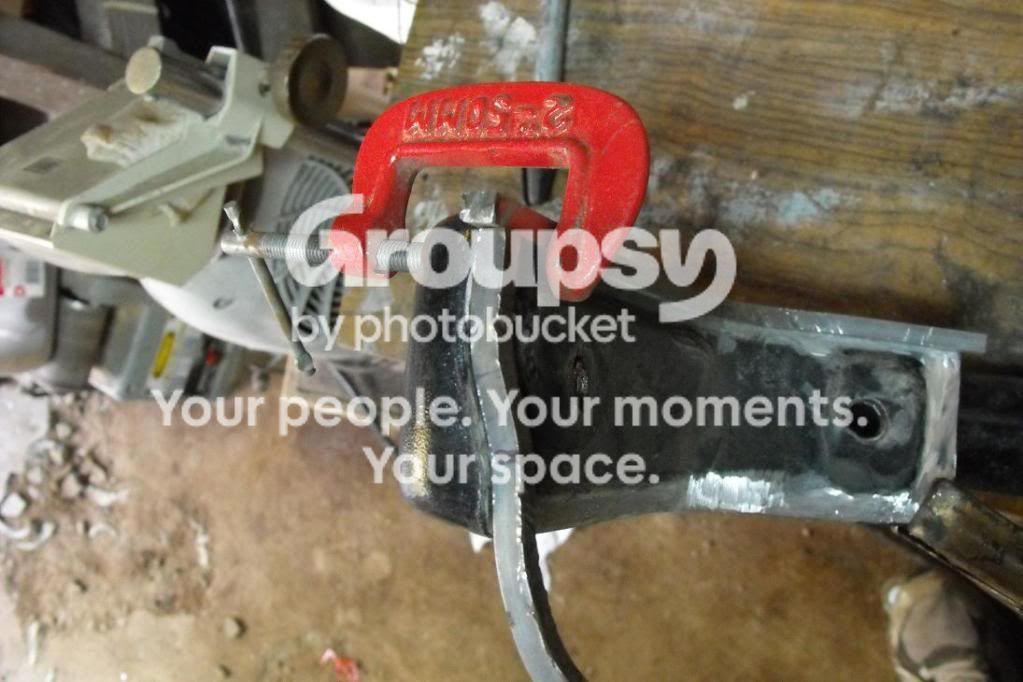

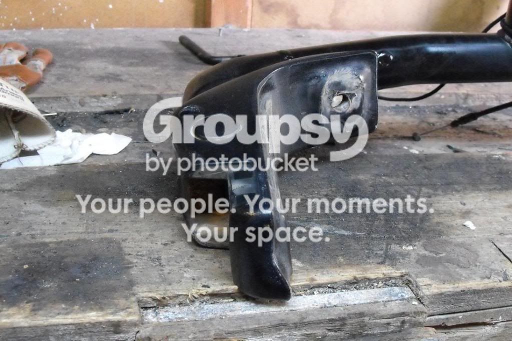

1/4" rod to be welded around the perimeter, then later shaved to the right height in reference with the projected area. The back end for example required little less than 1/4" to be flush.

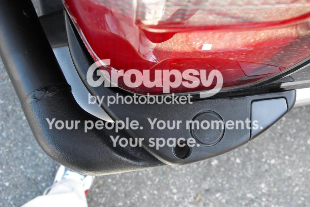

Compared to the 4Runner, the Hilux Surf has a recessed section below the taillight to accept the bottom hinge(pic below).

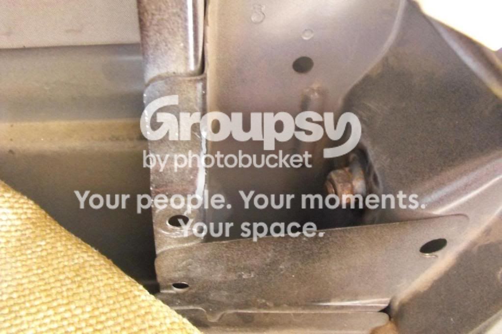

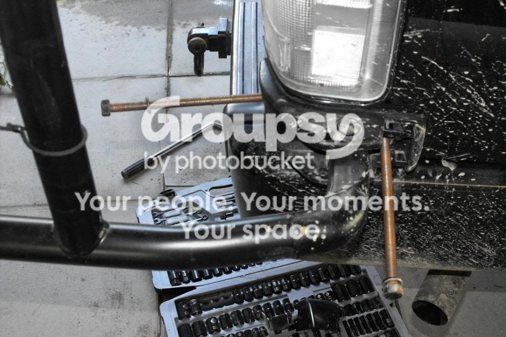

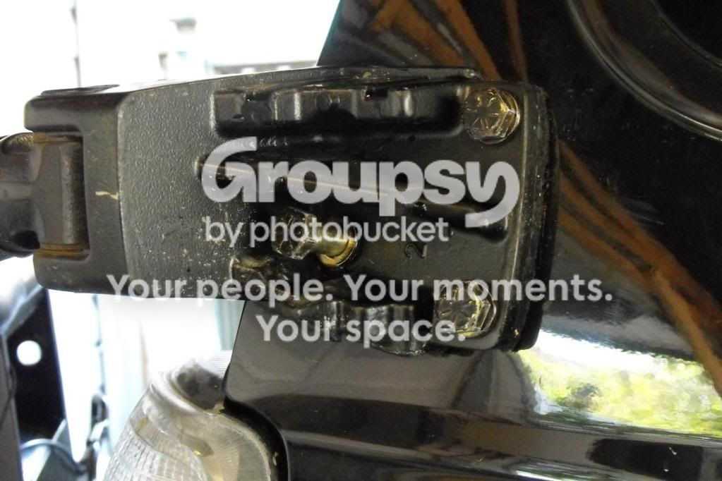

Now determining the holes to be made is easy but have a friend give a hand in this process. After all you cant afford to make a mistake at this point. First lock the tire carrier then mock up the hinge mounts in place and while a friend is holding them steady, grab your marker and mark the location of the 3holes up top and one hole on the side of the bottom mount. The bottom could get a bit tricky because while the tire carrier is in closed position, you can''t mark the location of the rear hole since the horizontal tubing is blocking it, so this will have to be done obviously while the carrier is open.
You can leave the rear of the bottom mount for last and drill your holes and insert your bolts temporarily up top and one in the bottom side just to assist in holding the carrier in place, while a friend is keeping the carrier open you can mark the bottom mount hole location easier.
Upper mount bolts
11-4.jpg~original
Lower bolts had to be atleast 6.5" long to get thru to the other side
1-20.jpg~original

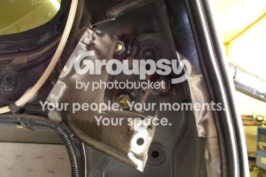

Inside the panel showing the upper 3 bolts
15-1.jpg~original

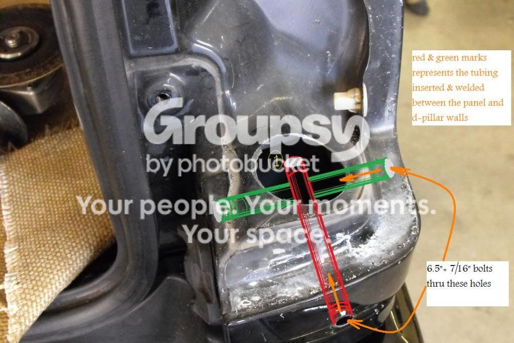

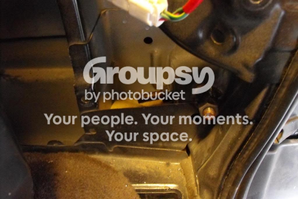

The picture below shows the taillight removed, a 2" diameter hole drilled on the base to gain access for inserting the 2 rigid wall tubings/sleeves that were later welded to tie in the body panel to the d-pillar walls. The two tubings/sleeves criss-cross one another one on top of the other. #1 encircled in yellow shows the end of the tubing at the d-pillar end...See 2nd photo for reference
redesigned00000000000.jpg~original
Other end of the rigid tubing/sleeve welded. See #1 encircled in yellow above
35.jpg~original
Photo showing the two longer lower bolts installed
9-3.jpg~original
Basically, reinforcing the tire carrier involves welding lengths of rigid tubings/sleeves in between the body panel and the d-pillar. The bolts used are inserted thru these sleeves so when the bolts are tightened, the body panel won't get crushed. These sleeves not only act as spacers but a guide to easily find the nut on the other end to thread into. Also nuts are welded at the ends of the mentioned sleeves then welded on the d-pillar itself, to ease the process of mounting the carrier without the use of both hands. I used 7/16" grade 8 bolts and nuts for the upper mount. As far as finding 6.5" + longer bolts in 7/16" size for the lower mount, I couldn't find one so I used a grade 8 rated redi-rod and cut the length I needed.

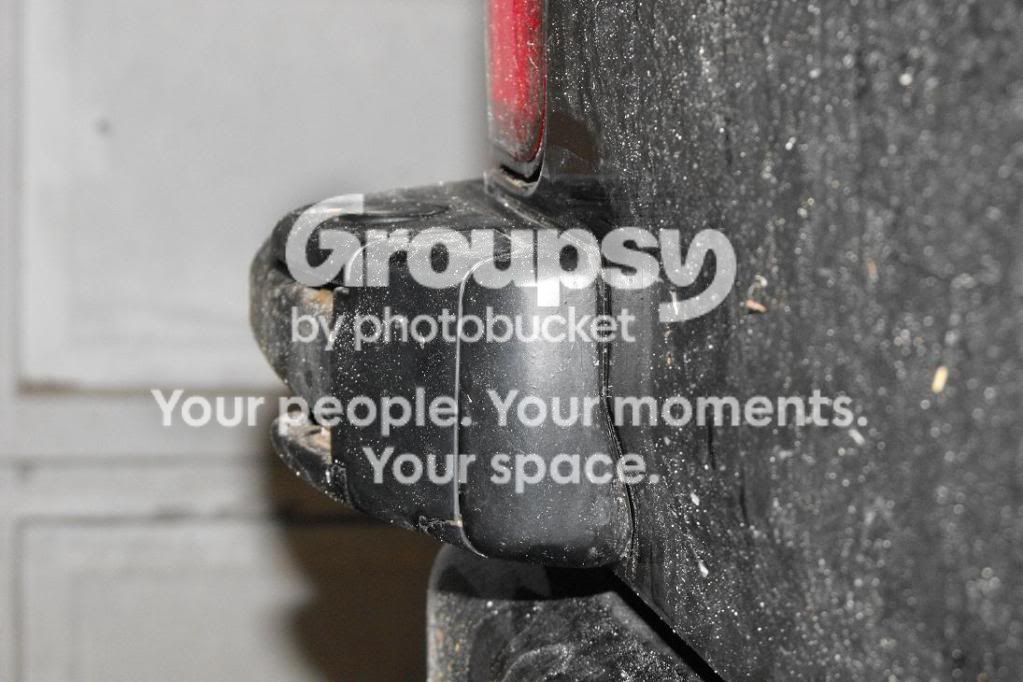

Here's are photos of the original Hilux Surf lower mount. There's atleast a good 1/8" of gap between the body panel and the actual hinge mount.
lowermount.jpg~original
lowrmountgap.jpg~original

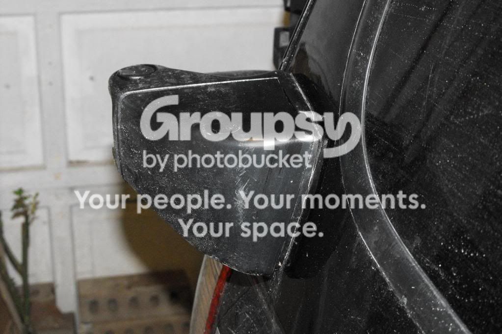

Here's my version, notice the area on the top and the side is much larger due to the added metal rod around the mount compared to the original version. Now it sits flush against the body panel without a gap. I adhered a piece of thick plastic on the hinge surfaces just to better protect the paint. The same material Toyota used on the tire carrier... I'm sure a thin rubber material would work just as well.
