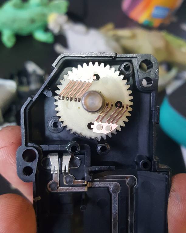

I just finished fixing this.
Take the servo actuator unit out of the car
Mark arm position then remove it
Dissasemble plastic housing.
Find the big cog and look for the missing 10 teeth. (The only 10 teeth it ever uses)
**Mark cog position and remove it.
Shave off the copper fork contacts with a razor.
Superglue them back on in the opposite positions. (Switch places)
Once dry and secure, place the cog back inside **But this time rotated 180° from original position.
Now the contacts line up. But with fresh teeth in position to do some work!
Put some extra dielectric grease on for fun.
And close it up.
Put the arm back on where it was before.
And bolt it back on.
No more click!

Just be sure to sharpie mark the arm to where it is positioned to the bracket. Then undo the screws and clips. Mark the white gear position also, otherwise you might have to fiddle with it afterward. The copper fingers are removed easily by using a razor blade to shear top of white plastic nodules holding them in. Dont bend the copper fingers !!! Rotate that gear 180 DEGREES. I used crazy glue to reattach the copper fingers back in place put it in and BINGO blend door will operate again! Actually only takes maybe 40 minutes tops if that.The copper fingers were the most mundane things to redo which took the longest time of it all. I just did this for my 99 4runner happy to have heat again. Still rolling with 239,000 miles Thanks to all the forum posters that helped lead me to this pic and the info leading up to it
