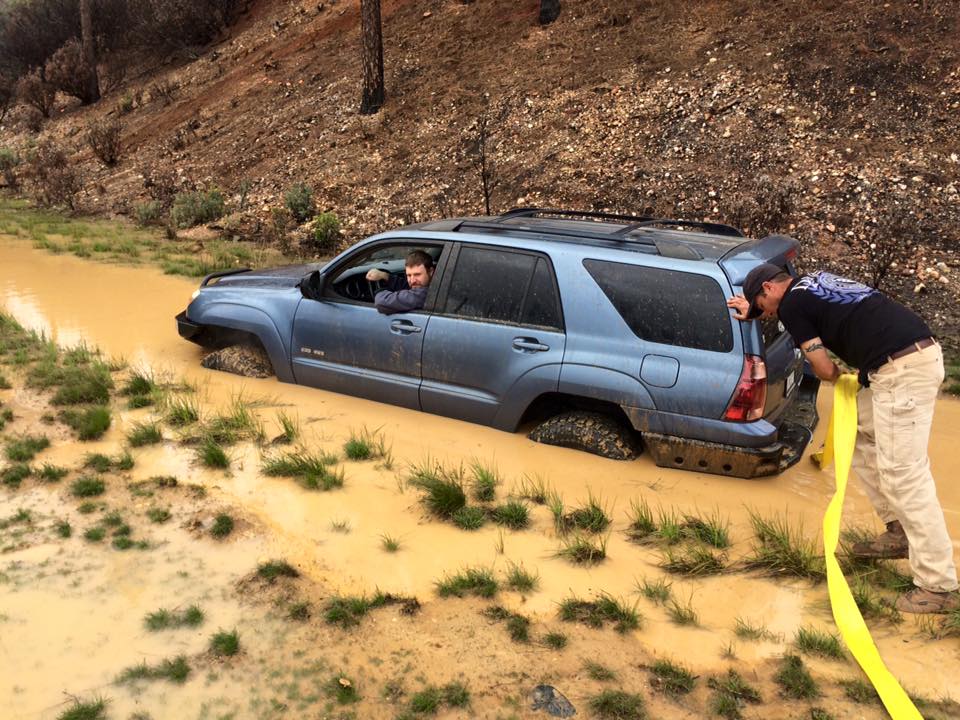

it was exactly 1 foot deep, I have pics of me in the puddle connecting a tow rope to the back bumper. I am very disappointed in the design of the intake, I assumed that there was some sort of angled piping or a rubber valve that would stop huge amounts of water from going into the engine, but there is not. They must not have water in Japan...:drum:

A little bit more information for you guys. I have an aftermarket front bumper and the plastic fender thing that used to connect to the factory bumper has been cut so that the tire doesn't hit it.
That's a bit over 2ft of water. My guess is you hit it too fast or too slow and you did not create a good bow wake to deflect water away from the intake.
Keep in mind that the tires are dug into the mud in the bottom of this hole. Its not really that deep. I was probably going 10mph into it.
Is this some kind of trick statement? Yes it is more than a foot unless you are riding on 12" rims. Who cares if mud etc and you sank. You are in two feet of water. Poor design? Poor judgment more like it.
