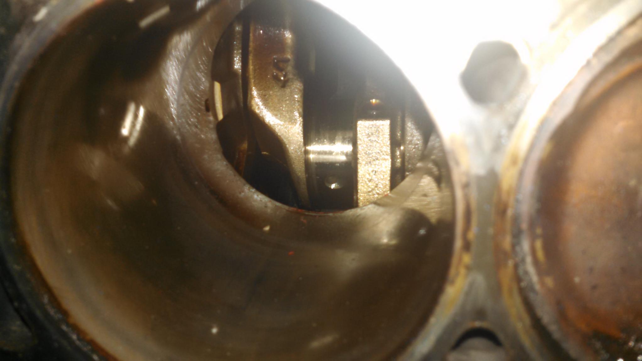

I was able to get an inspection scope up inside the oil pan splash guard thing and found that one of the rods is completely sheared off with the piston stuck in the top half of the cylinder. I guess that is good because there does not appear to be any scoring on the cylinder wall. The reason I asked all of this is because it is possible to just buy a piston from a junkyard with a rod and put all new connecting rod bearings in the engine and run it just like that. No new head gasket required, no seals required... just slap in a new piston and go. This is why I asked about it being possible to remove the piston from the bottom.
Now, can anyone tell me if it is possible to do this? Can the pistons be removed from the bottom???
I figure that I should try this fix for $50 before removing the whole engine and tossing it. If this works, I am getting a snorkel...not going to try to mess with the poorly placed intake.

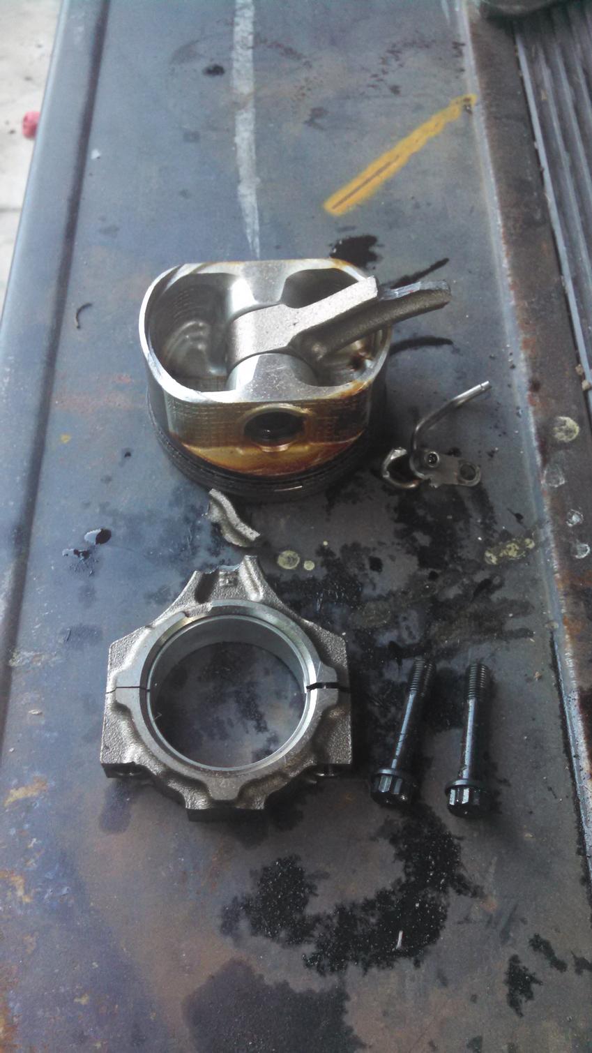

Still, I got the pan off and inspected the underside of the pistons, only cylinder 8 has the broken piston rod and it looks like the piston won't fit between the counterweights. Heads are coming off next.
So, got the heads off and the piston out. Looks like it did not touch the valves or score the cylinder wall. Heads are going to machine shop tomorrow to get checked and decked and if all is well I will get a piston and start putting it back together.

I do have "an idea" if I have done damage to the cylinder walls. There isnt the slightest scratch or mark on 7 of them and #6 where the rod broke there is only a mark near the crankcase, 1/2" up the cylinder wall from the broken rod spinning momentarily around in the case for about 20 seconds. I would also like to note that my engine only had 80k miles on it. There is no way I am going to find an 05 2uz motor that can be installed with less than 80k on it for less than $5000. It has to be from an 05 and it has to have no problems (90 day warranty or not, that is a huge risk). Every shop that I called wanted $5000 plus to swap the engine, there is just no room in the engine bay of the 05 v8. The labor book calls for 38 hours labor...THIRTY EIGHT HOURS!!! There is no way that I am going to risk all of that labor twice for a motor with any unknowns.
So, this is what is going to happen: The heads are going to be redone at a very good machine shop here in Sacramento, then I am going to get all new rods and moly piston rings and all new standard sized bearings. There is no point in boring out a cylinder that has no measurable wear, there wasn't even a ridge at the top of the cylinder when I slid out the piston.
That's exactly what id do. No need in an entire new engine....
My only contention would be upgrading to 1uz rods since I was buying new ones anyway.
