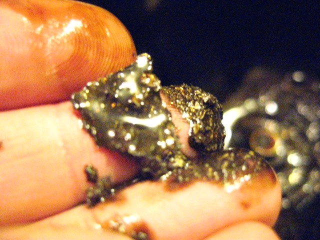

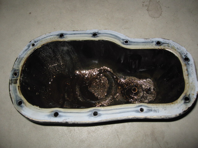

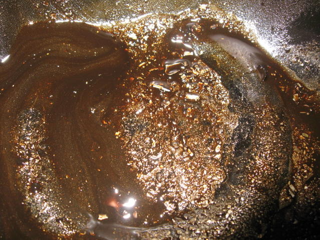

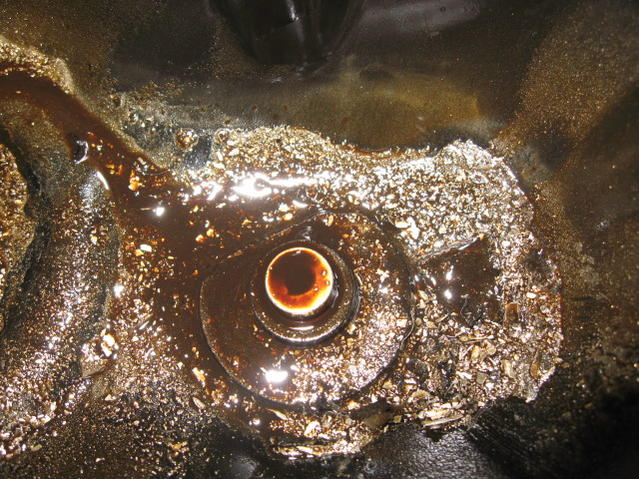

He shipped me an oil sample kit accompanied with forms. He is now waiting for that to be analyzed, my oil filter which will be tested at their facility and pictures of the damaged bottom end.
So now all I can do is wait some more...
Attached are some pics of the oil pan, pretty clean oil eh?

Ack! No wonder it died! It was grinding itself to death. Wow

Chewed itself to shreds!
