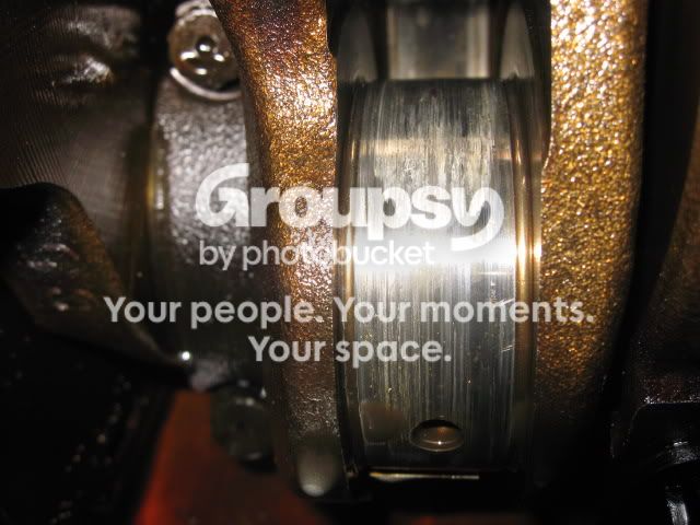

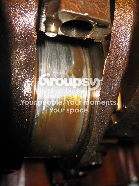

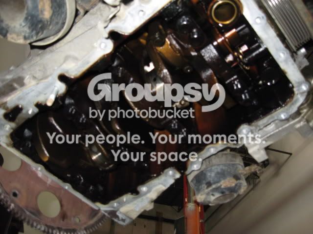

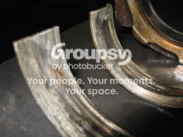

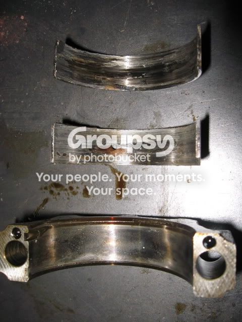

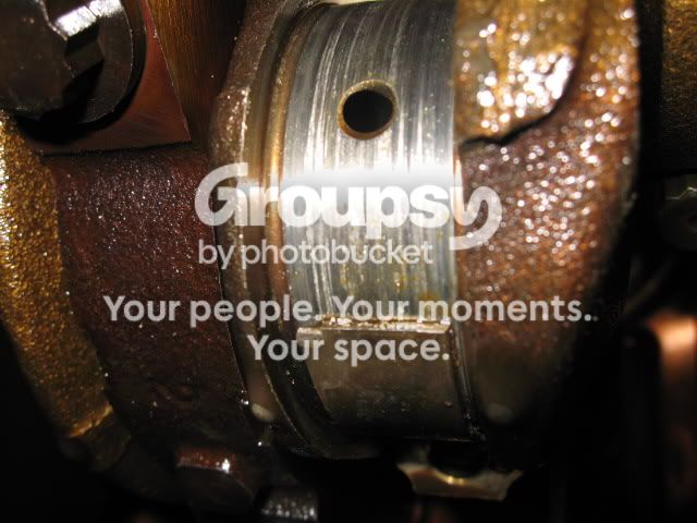

Getting closer...

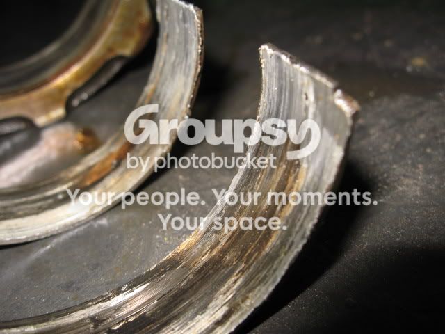

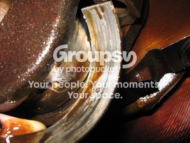

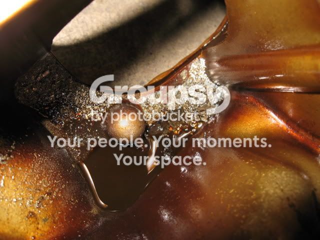

I just came back from the shop, the damage to the bearings is pretty apparent. The races actually spun inside the bearing caps.
I just sent these pictures off to AMSOIL. Lets wait and see...
4RunnerDamagepics020.jpg~original
4RunnerDamagepics017.jpg~original
4RunnerDamagepics001.jpg~original

The inside of the engine looks really good and basically sludge free. It looks like the oil was doing well and the filter just lacked sufficient capacity...
