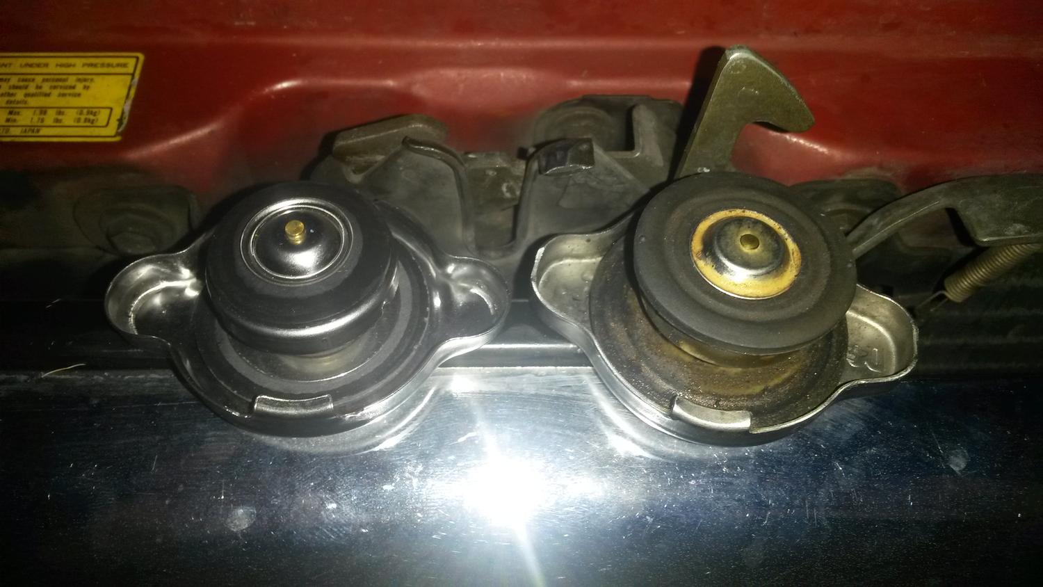

I went and bought a new radiator cap last night and noticed something very interesting. Do you see it? The old one has a huge rubber gasket on the bottom and the new one doesn't, its very small. The old one must be pushed down into the radiator and the new one sits in evenly. The one on the left if brand new and the right came with the truck. Could this make a difference?
does new one seal?
I cant remember the details now, but I think there are 2 different types of caps for Toyota rads. im thinking you got the wrong one.

does new one seal?
Yeah it seals good and everything, I drove the hell out of it last night. That upper hose is still hard but not as much as it was before.
