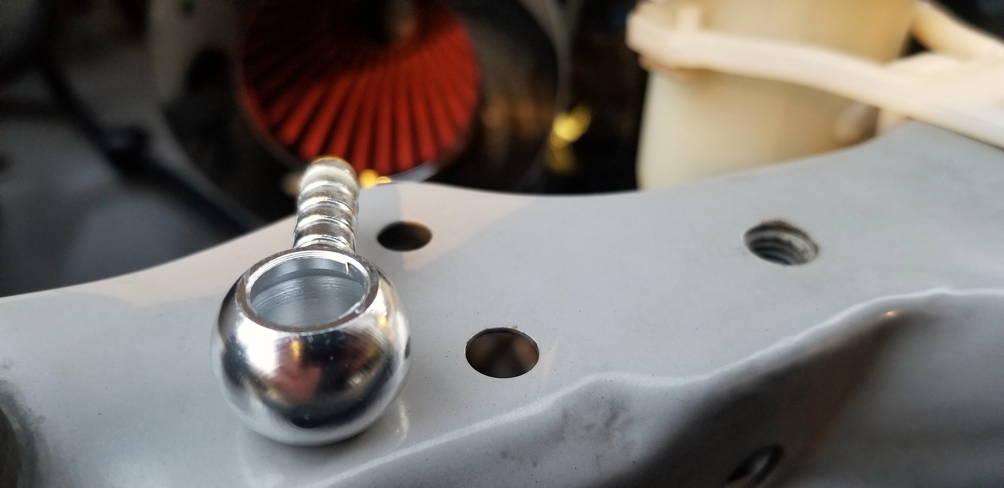

Spent a better portion of my day chasing my over boost issue. I removed the WG and opened her up. Everything looked fine, no visible tears, all the bolts were tight, no holes in the vacuum line (directly to the turbo). Assuming it was the Ebay-ish WG I got frustrated and got some lunch... After, I thought... "hmm, I'm going to fill up the air compressor and see how much pressure it takes to open." 30psi later, didn't open (4PSI WG spring)... hmm... I then removed the vacuum line and T fitting on the side of the WG and blew air through there to make sure it was clean... To complete surprise, blocked... I inspected the T fitting and found this...
2019-01-01_05-01-57 by Sean Miller, on Flickr
Thanks EMUSA.
Now to re-test.
Thanks EMUSA.
Now to re-test.
Also, Not 1 knock code has shown up since I overboosted the first time. Odd
