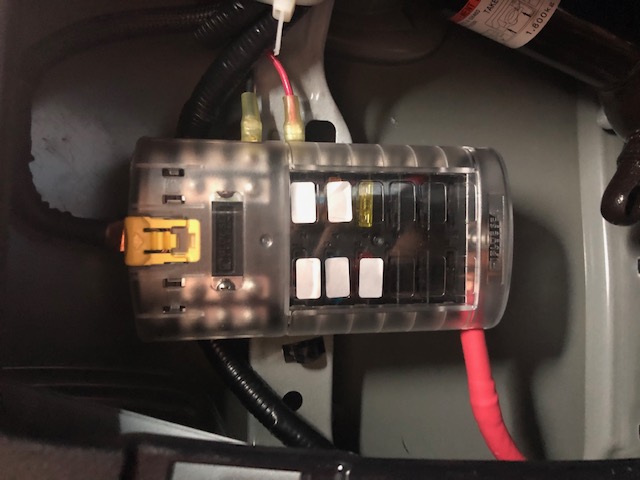

Blue Sea fuse block in cabin

From an electrical standpoint, seems like you should be able to backfeed the system from the fuse box. I'd probably just attach the MPPT to an unused set of terminals in the box, fused appropriately of course and that's that.
As for the rest of it, realistically you're only going to be able to use about half that 92ah from the AGM battery so plan accordingly. Having the Jackery 500 around is a good idea. It's all just math though: how many ah draw you have vs how many ah you have available, accounting for efficiency losses etc.
Yes that is what I will most likely do. Didn't know if it was OK to do this until recently so that makes it a lot easier. Will fuse appropriately for the MPPT and the fuse panel will itself run off of the 100A breaker located under the hood next to the battery.

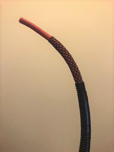

Ran the wires (4AWG) to the back this evening. Couldn't decide between split tubing or loom so decided to go with both at least for the portions where the wire rubs against the plastic and metal around the jack mount area and into the top of the wheel well area. Have a plate that I need to drill holes in and mount the blue sea fuse block and then crimp the lugs on. Hope to get it done over the weekend. All inspired by [MENTION=47340]Titanpat57[/MENTION] build so a tip of the hat to him for documenting his installation and the help.

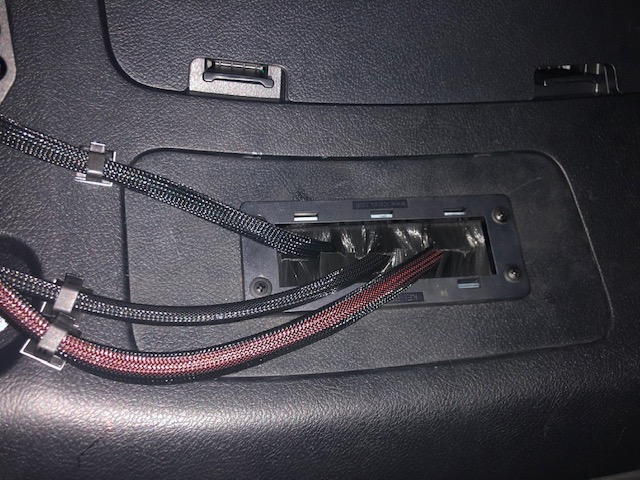

Thanks. No need for the pic. I think as long as it is feasible I'll force myself to do proper cable management so that the jack slides in and out easily. The tools will live in the drawer system which is on order. My solar is going to be via an anderson plug so that it can be removed and used to charge the portable lithium unit instead. Will be mounting this to make the process of getting cables in and out easy. Have to decide whether to use the jack area panel or the one adjacent to it for the rear light to route the cables in. All the cables will be tied in place and route upwards to the molle rack system where the MPPT will live and where the anderson plugs will stay. Fingers crossed to have it done by Saturday..

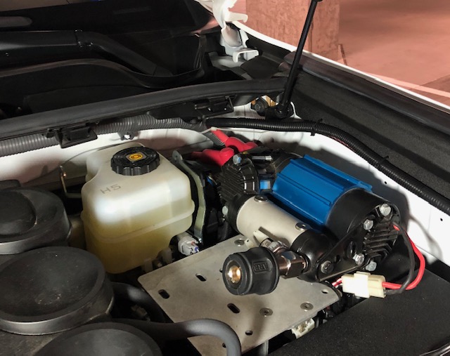

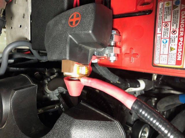

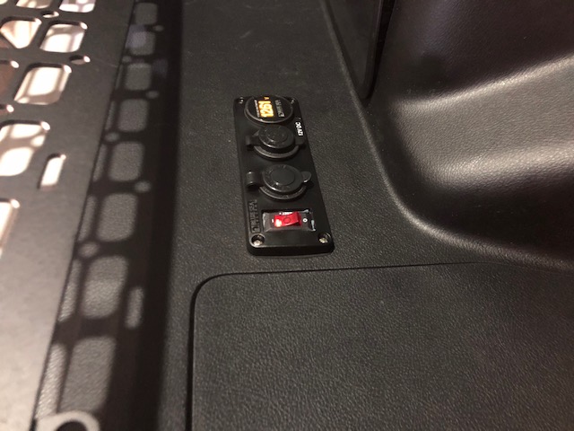

Just completed the final installation and connections last night. It was a pain in the a$$ to try to mount the breaker on the Rago fabrication dual compressor tray without removing it. Ran the two 4AWG cables to the back a while back, fused the cable using a blue sea terminal fuse and have a blue sea breaker in the engine bay. Cables run to the back of the jack storage area and the fuse block does not obstruct during the removal of the jack. I clearly need to redo the stickers on the fuse panels :)
Need to button up the wires and how the run as I have a temporary setup awaiting my decision to either stick a larger single battery in there or a dual battery setup. That's for later perhaps in the fall..
Still a far cry from the ultimate electrical Instagram Overlanding Quadfecta™ but for an amateur camper, I think it will suffice for now. Will add solar soon.

Here's it installed in case someone was looking for this solution as a way to route wires through to the jack-storage area..
